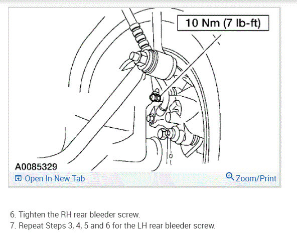

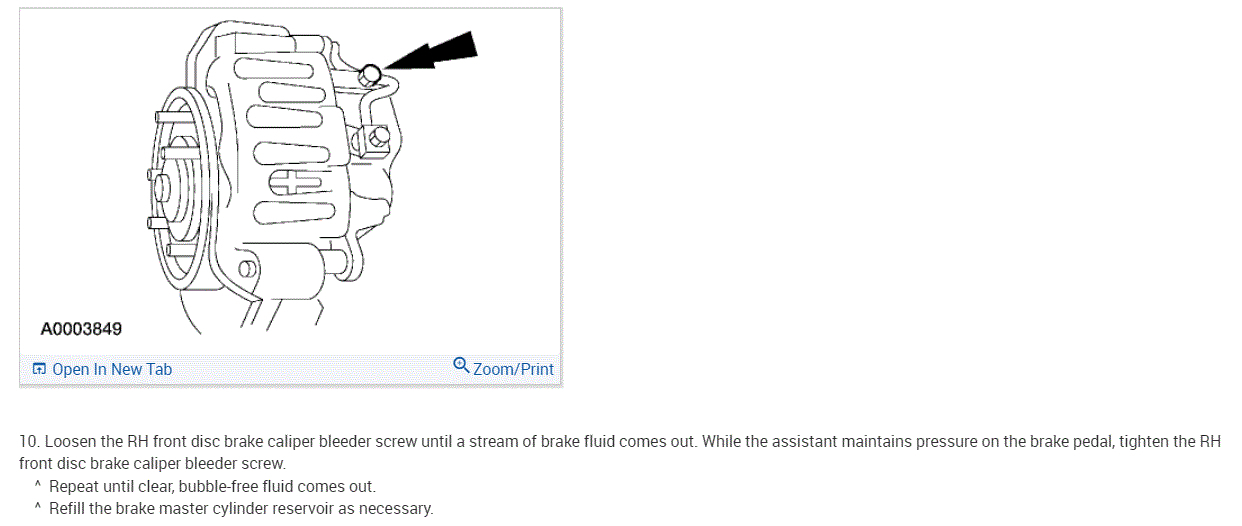

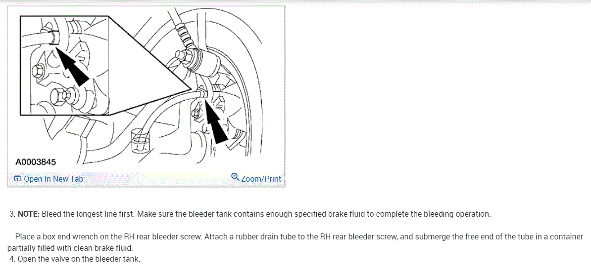

I put new seals on front calipers but in the process of waiting on parts the clamp pinching right brake hose came off and master cylinder ran empty. With it put back together I vacuum bled the front but couldn't get a pedal, so I bled the rears. Still no pedal so I started engine, pumped brake pedal and finally got a pedal with engine off only so I plugged in Xtool scanner and tried to bleed ABS but when I selected icon it says unsupported. What next, continue bleeding brakes? The brakes worked fine before other than one seized piston on each side which I fixed. I submitted this question over the weekend, but I didn't recall anywhere that asked for email. Thanks in advance!

By any chance, did you by accident switch the calipers so that the bleeders are at the bottom rather than the top? Also, if you pump the brake pedal until it holds, and then maintain pressure, will the pedal slowly go to the floor?

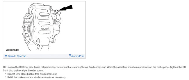

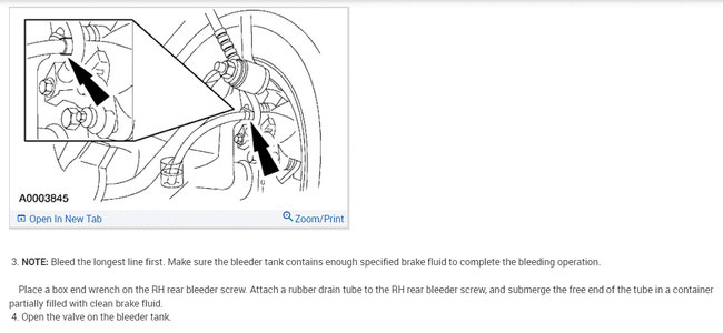

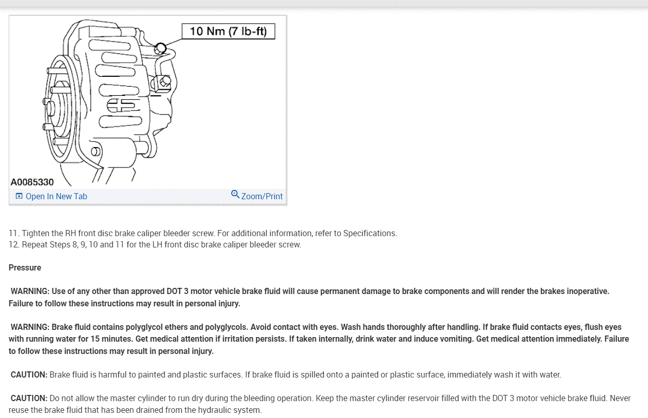

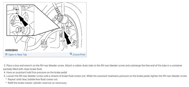

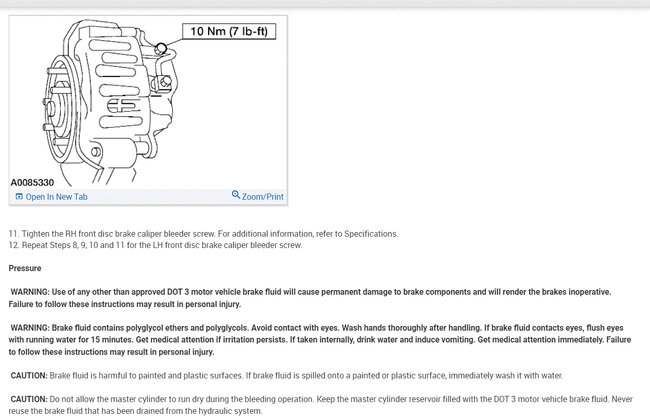

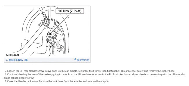

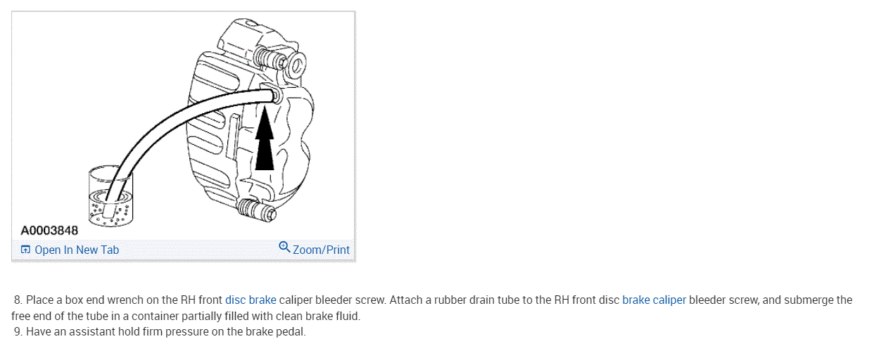

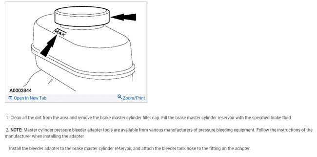

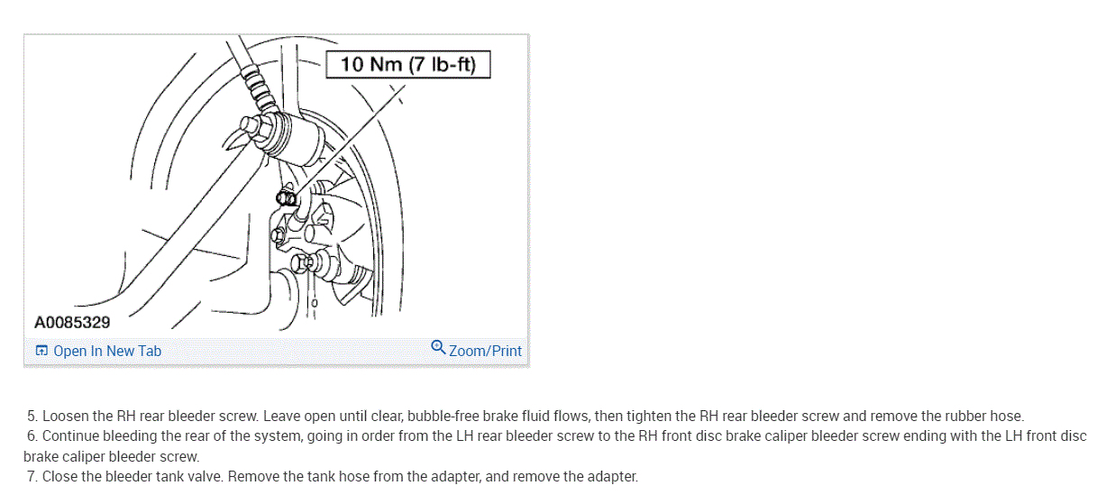

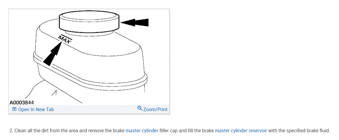

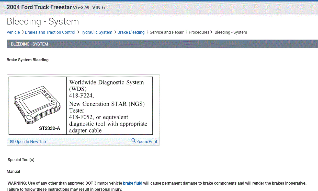

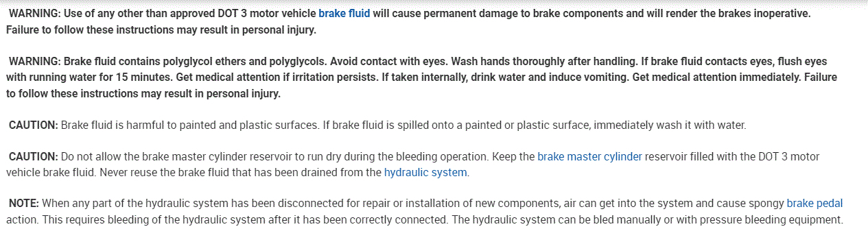

I attached the directions from the manual for bleeding. Take a look through them and see if you are missing anything.
See pcs below.

Bleeders are on top; problem is I get no pedal when pumping. Today I am going to go back through and bleed all 4 starting at the back and see what happens. Keep you posted, thanks.
