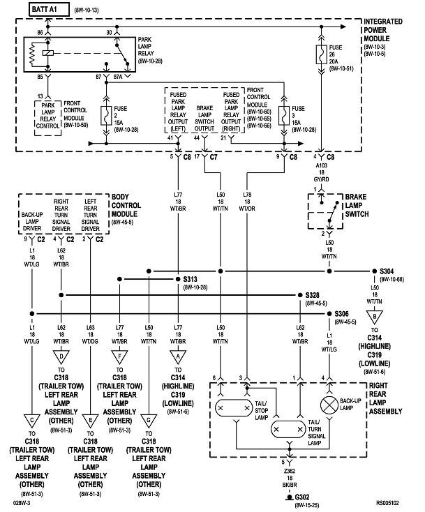

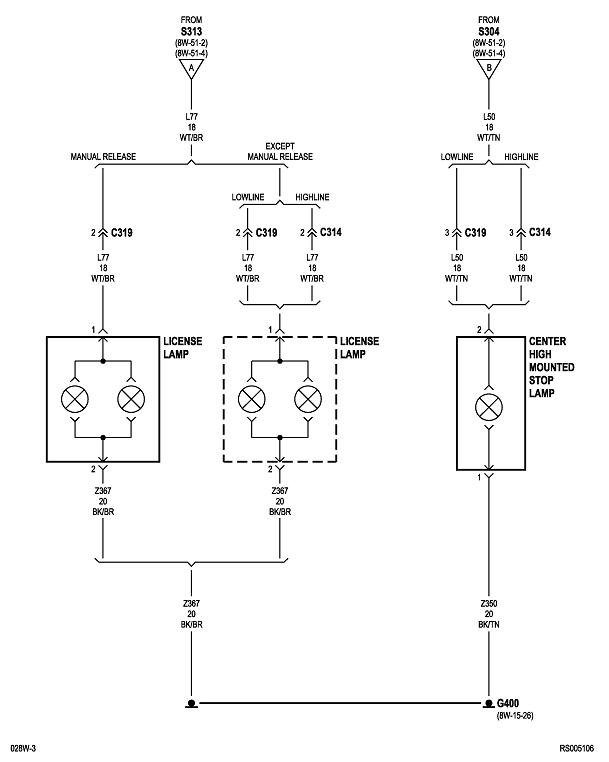

The best clue is the center high-mount light also does not work. That does not go through the signal switch or anything else, so the circuit is very basic. Also, all three brake lights are on separate circuits, so there is very little all three have in common. That is where we have to look.

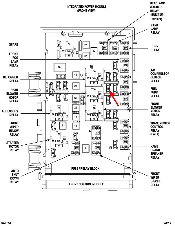

Go to the gray/red wire on the brake light switch and check for twelve volts. It should be there all the time. If that is missing, check for twelve volts on both sides of fuse 26, a 20-amp, in the Integrated Power Module, (fuse box), under the hood.
If you do have that twelve volts at the switch, check for twelve volts on the white/tan wire when you push the brake pedal. If that is missing, the switch is defective or it is the wrong switch. Let me know what you find.

Okay, I have no voltage in the white and tan wire when i press the pedal so I jumped the wires and still no brake lights.

Check for twelve volts on the gray/red wire.

I might have a bad ground, when jumped i got voltage at the circuit board at my tail light assembly, unless all three lights use the same ground?

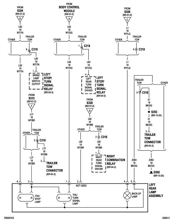

The two outer brake lights share a common ground connection, but the center brake light uses a different one. The center light's ground is the same ground for the license lamps, so if the license lamps work, that ground is okay. The turn, signal, and back-up lamps share the same ground as the brake lights, so if those other lights work, that ground is okay.

Before we go looking for the hard stuff, check fuse 26 in the under-hood fuse box. You'll find two tiny holes on top for test points. There should be 12 volts on both points all the time. This article shows how to test a fuse:
