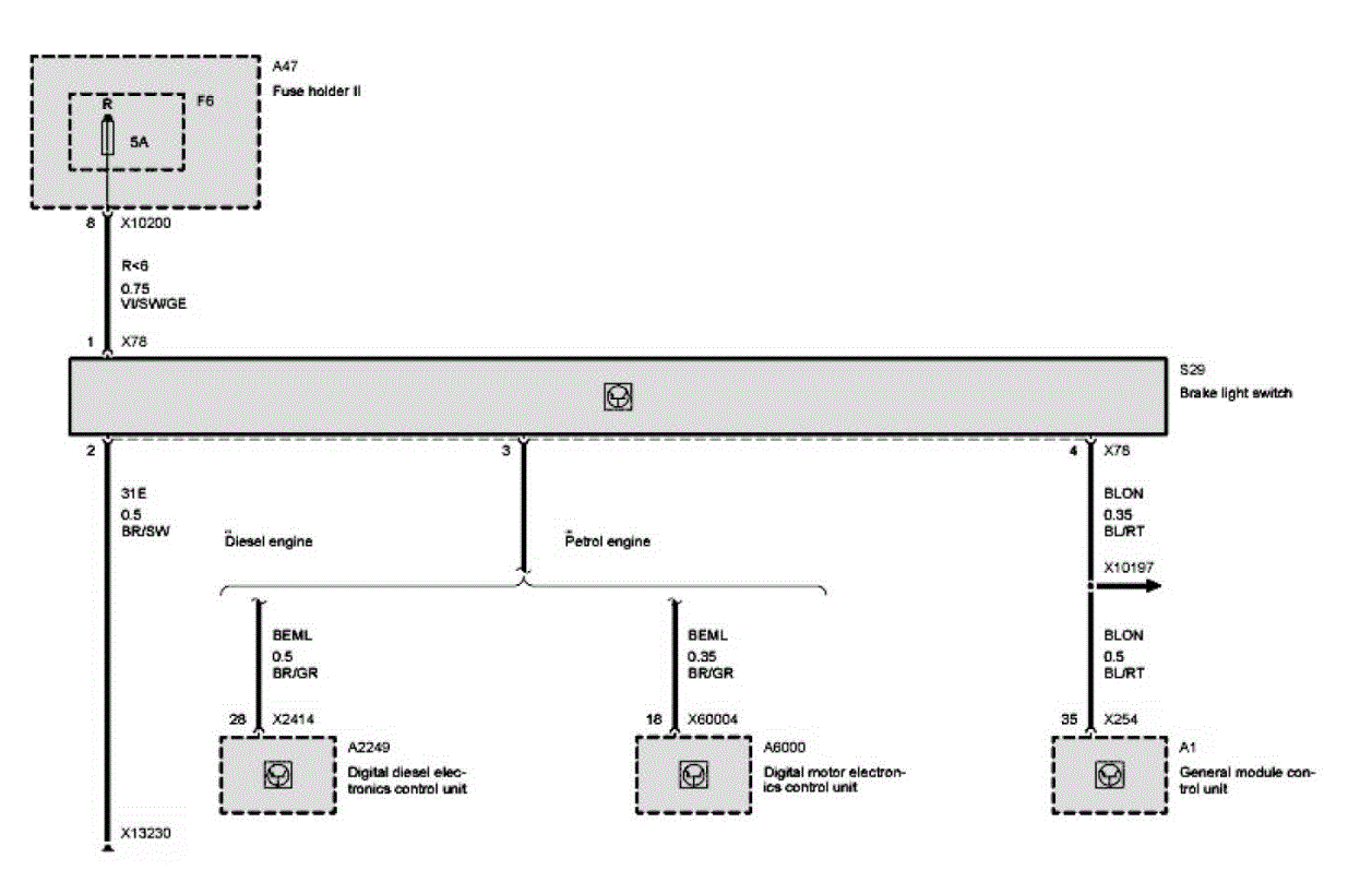

I have no brake lights. I've changed the switch twice now still no luck.. I have 12v going into switch, the ground is good the other 2 wires have 1.3v coming out when you apply the brakes. any ideas? thanks

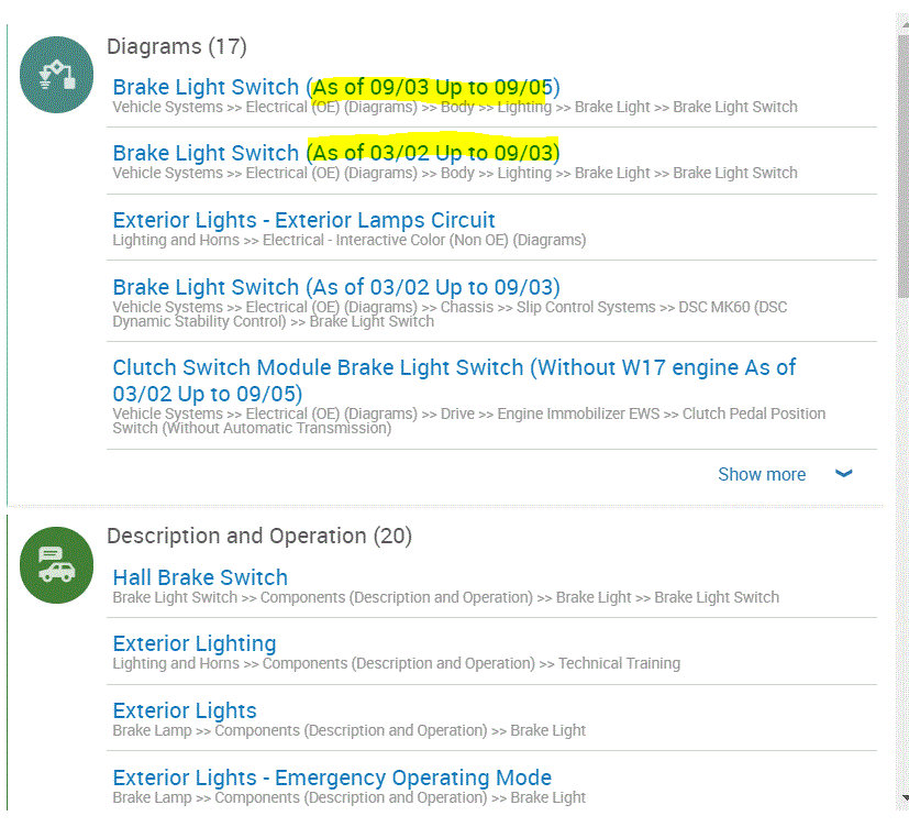

The low voltage may be because it is sending to a module. Do me a favor. I need a production date to get into the correct schematics. If you look at pic 1, it shows the options. Let me know which I should focus on.
May 7, 2021 at 2:12 PM
RODCHERO86
Hello, it's a 10/03. I do have Haynes manual but it's very vague. I peeled back the carpet to get access to the body unit also there is some moisture on the floor. thanks

I looked up the schematic of the brake light switch based on the production date. It is attached below. It is very vague.
See pic below.
