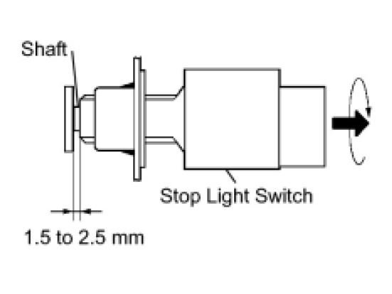

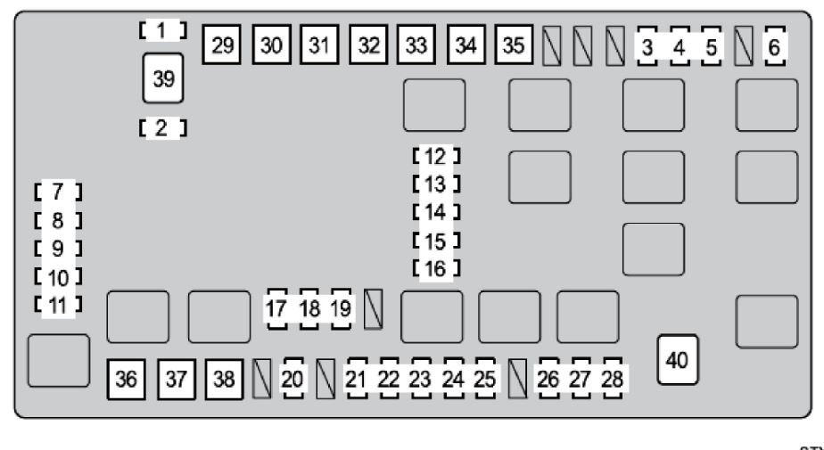

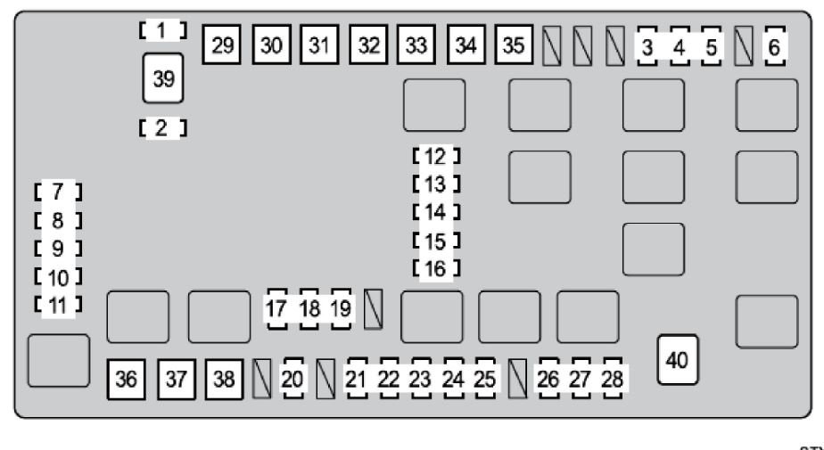

As far as the brake lights, first check the brake light fuse under the hood in the fuse box. It is number 3. See picture 1 for location.
Next, check for power to the brake light switch as well as adjustment. The switch is at the top of the brake pedal assembly. See pic 2. If the switch is getting power, confirm switch operation as well as adjustment. If you look at the picture, you will see how turning the switch will change adjustment.
If there is power at the switch and it is operating, you need to check for power at the light socket.
