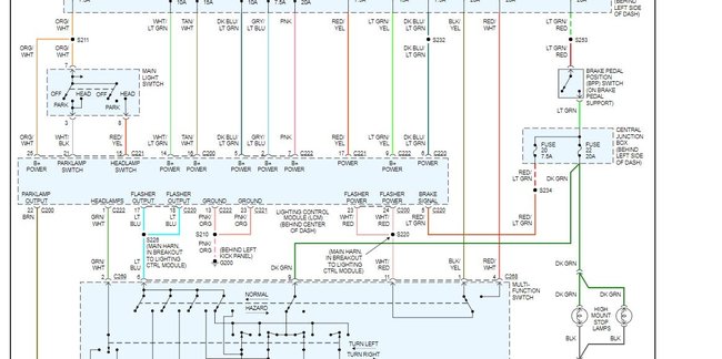

I have no brake lights. The center one does work. I have checked the fuses, bulbs and changed brake light switch. Still no luck! Can someone please help?
Aug 9, 2018 at 5:36 AM
Good afternoon.
There are two fuses for the brake lights. I attached a diagram of the wiring for you to view.
If they are good, then the turn signal switch may be the issue since the feed to the rear lights goes through the turn signal switch.
