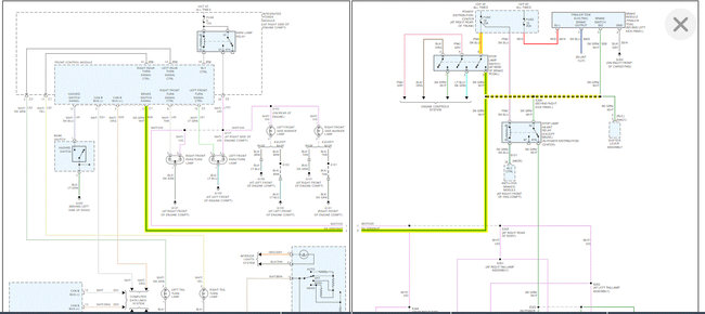

Fuses good, replaced brake pedal switch, have 12v to switch, placed jumper to plug on harness brake lights came, connected everything together, no brake lights. Lost in space. help!
Jul 20, 2019 at 3:01 AM

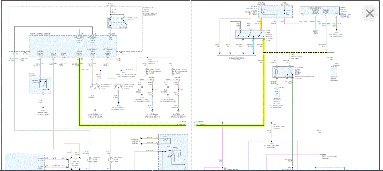

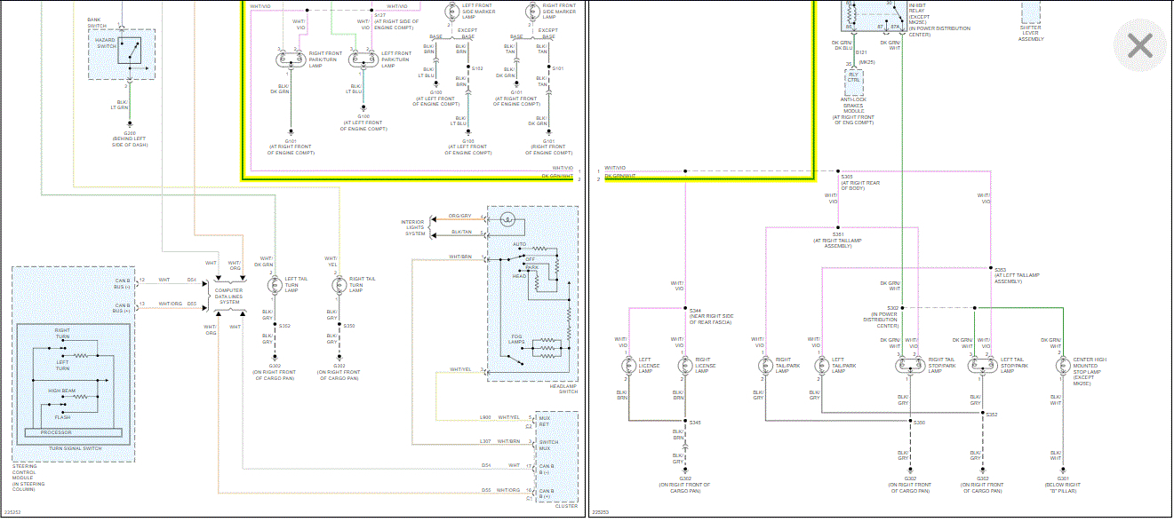

I attached larger diagrams for you to view.
Let me know when you want to do some testing. You need to verify power in and out of the switch.
