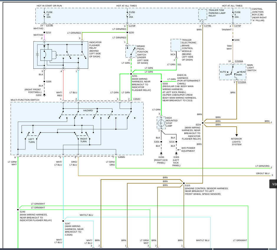

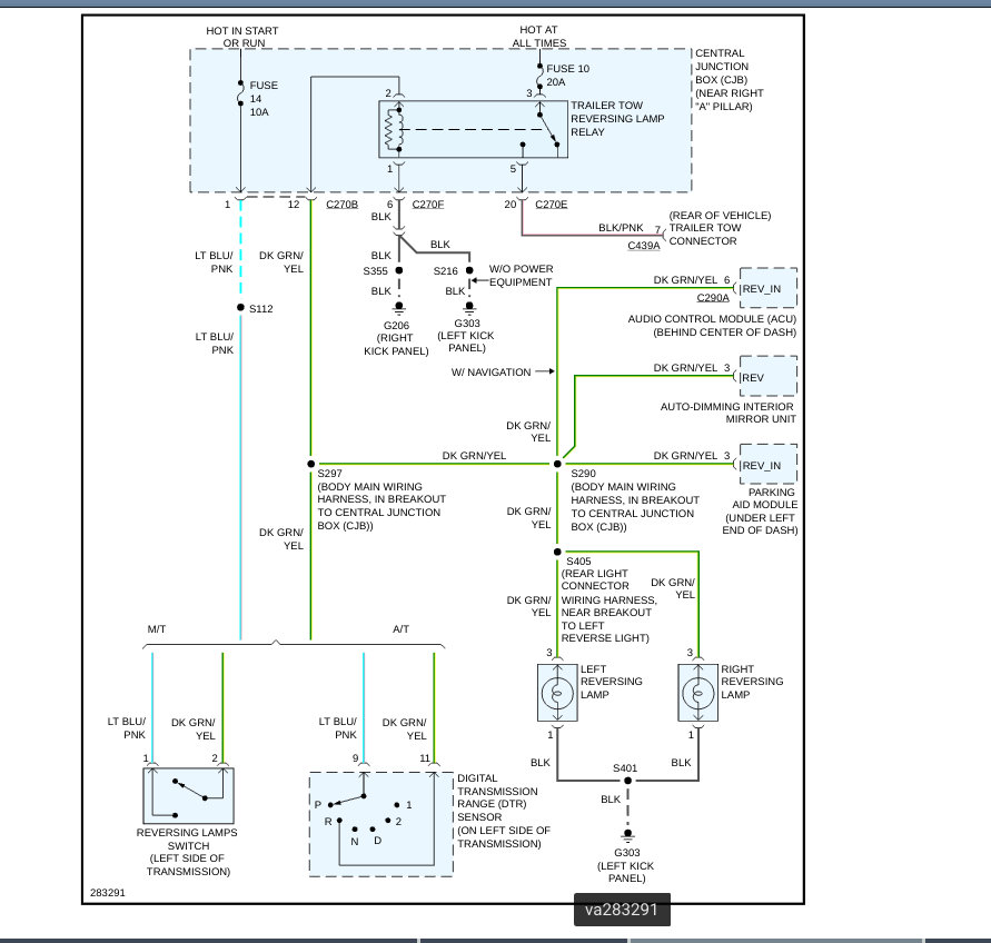

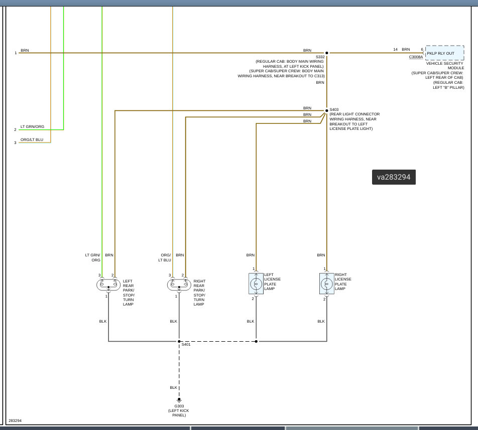

Been dealing with this for some time now. Brake lights were working at one time, now only the markers work, but no brake lights. No reverse light either. Turn signals and brake lights are on the same bulb. Someone told me once, I need to check a relay in the fuse panel. Turn signals do work though .any ideas?
Feb 16, 2020 at 7:31 AM
SCGRANTURISMO
  • 4,897 POSTS

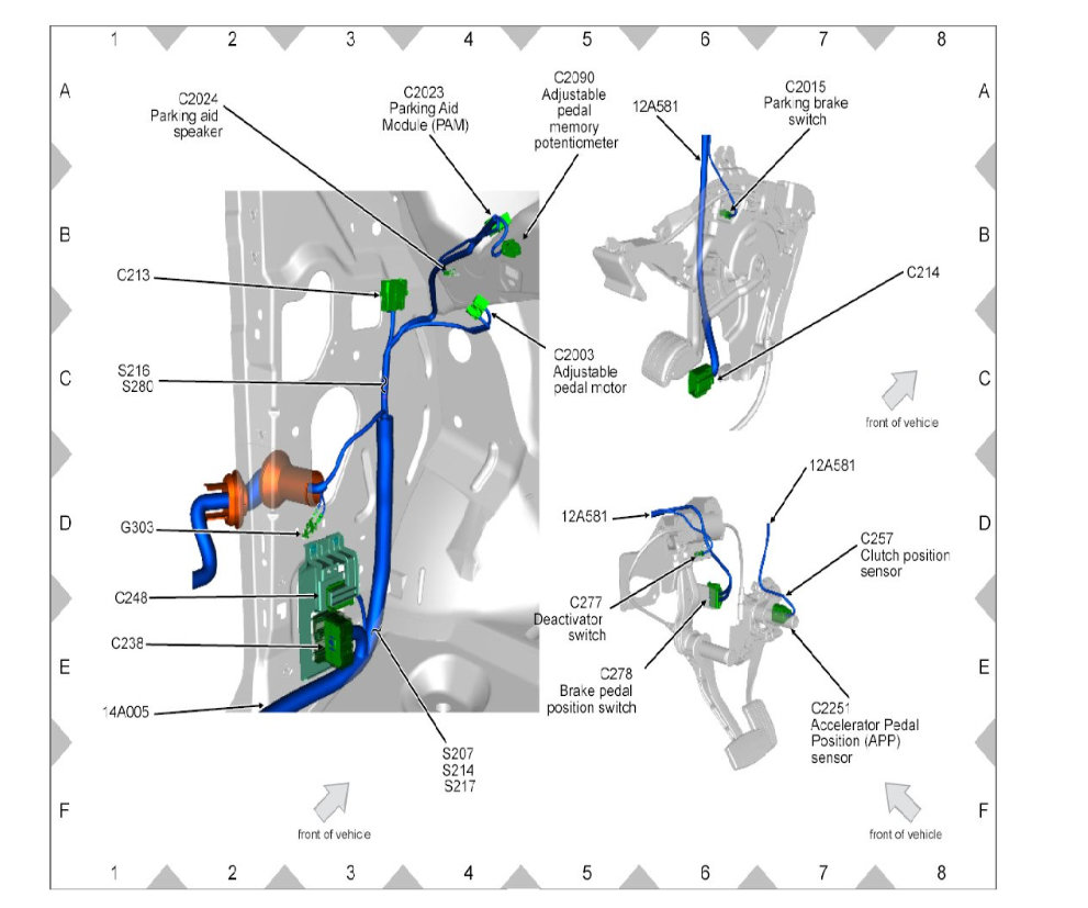

This sounds like you have got a problem with Ground 303, which is located on the left hand A pillar. In the diagrams down below I have included the backup and exterior lighting diagrams for your vehicle as well as the location of Ground 303 for you. Please inspect the ground and make sure that it is clean, tight, corrosion free, and making good metal to metal contact, and get back to us with what you find out.

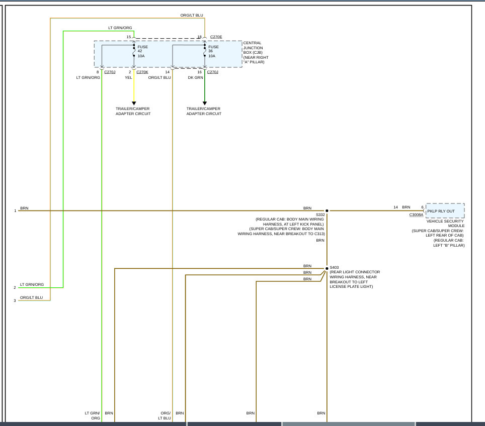

Good evening,

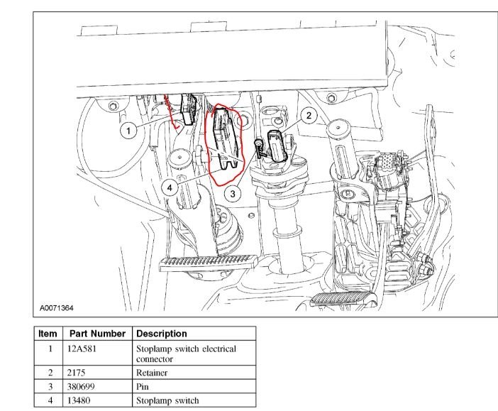

You will need to test for power in and out of the brake light switch. From there, it goes to the turn signal switch and then to the bulbs.
You will need a test light or voltmeter to do the testing.

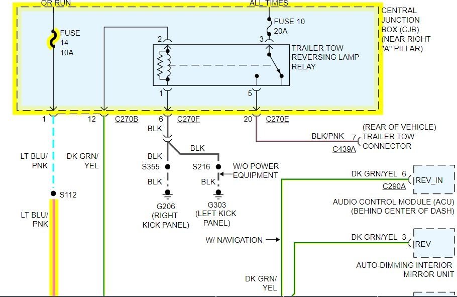

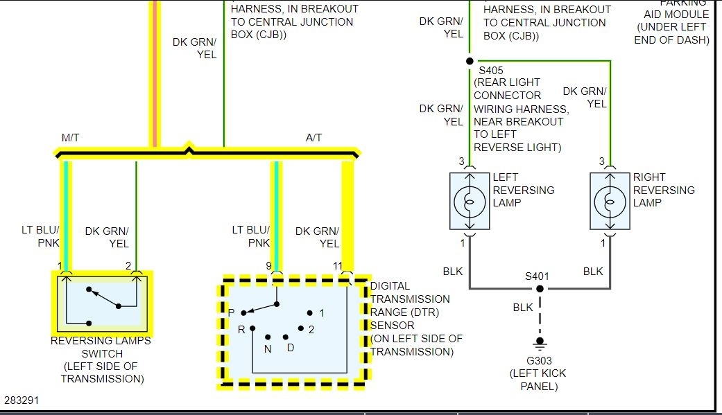

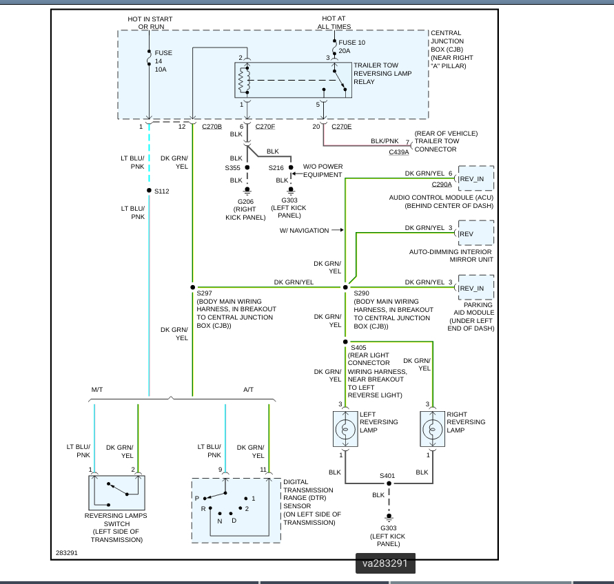

Thanks for the quick response. Anything on the reverse light not coming on? Seemed a few weeks ago everything was working just fine.
Feb 16, 2020 at 8:03 AM
Back up circuit attached. Check the fuse listed for power on both sides.

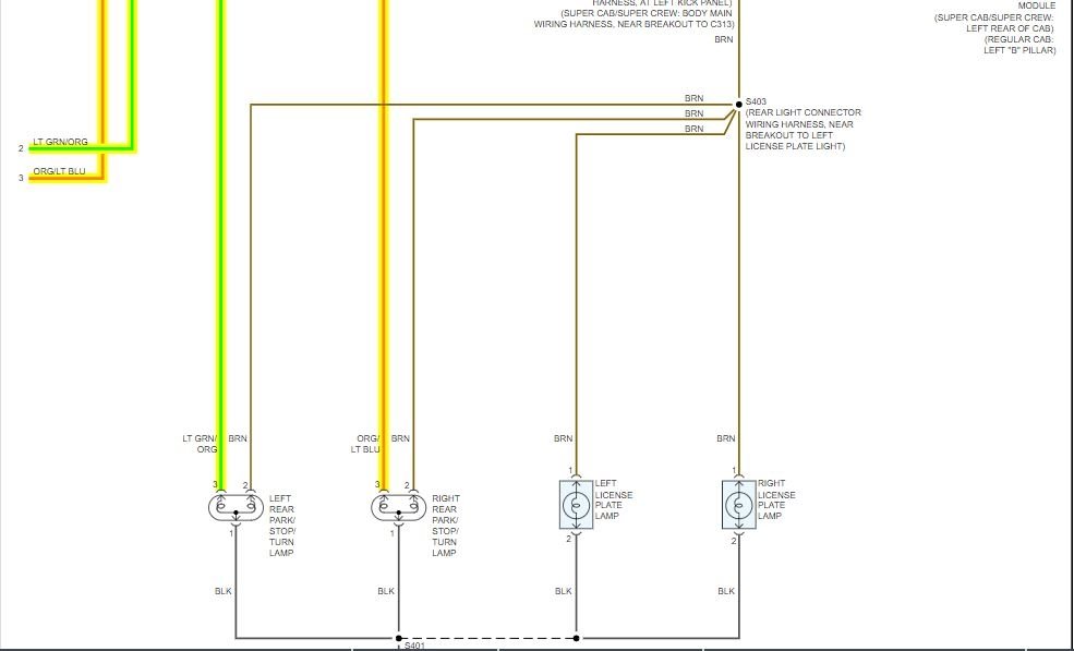

Had someone come look at the lights. Used a volt meter and it said there was only 7.7 volts going to the taillights. I'm going to pick up a new brake light switch tomorrow and have him put it in for me. Still haven't looked at the reverse light though. One thing at a time.

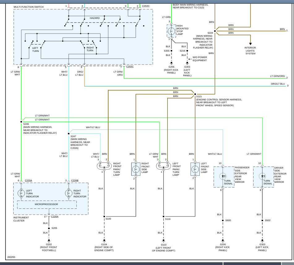

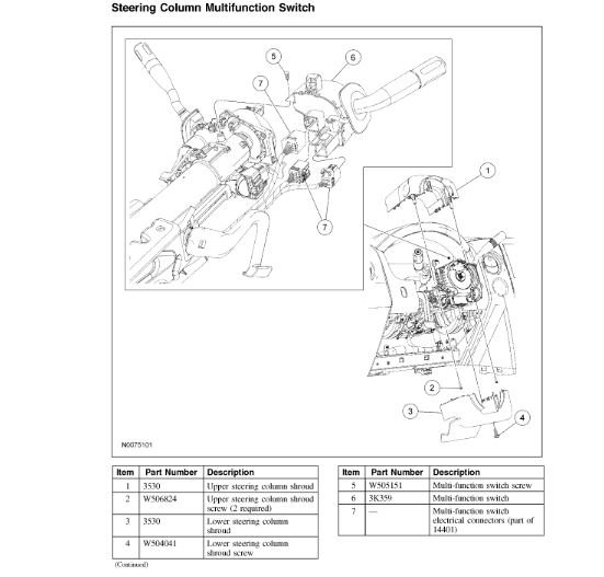

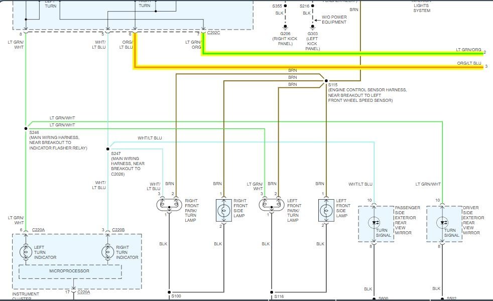

Okay, not sure of this has anything remotely to do with my issue. The guy I had come to me just messaged me and mentioned he did some digging and said he thinks my issue could be caused by a combination switch for the turn signal. Those actually work, the brake lights don't work. Thinking I need to drop it off someplace more legit and see if they can dig into it. Thoughts?

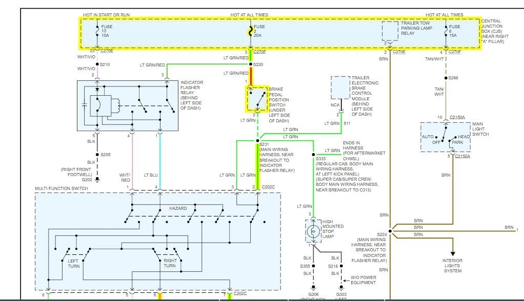

You need to test for voltage from the switch to the turn signal switch in the diagram that Alex and I posted.
If you have power to the switch, then yes, you have a bad multifunction switch.

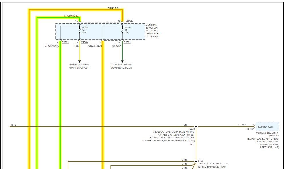

The voltage was about 7.7 at the plug. This would keep the brake lights from working?
Feb 18, 2020 at 2:44 AM
ERIC MCLEOD
  • 21 POSTS
And when using my 4-ways all but one works.
Feb 18, 2020 at 2:45 AM
7.7 where?
Feb 18, 2020 at 2:48 AM
ERIC MCLEOD
  • 21 POSTS
At the rear light...
Feb 18, 2020 at 2:49 AM
No, you need to do the testing I asked you to do at the switch and at the multi-function switch.
Do those tests first.
Feb 18, 2020 at 2:54 AM

Okay, final update on my issue: Tail lamp harness needs replaced. The volts shot up to 12-13 at the plug under the bed. Then back down to 7-9 when plugged back in. Only thing is, Ford discontinued the harness and there's none new to be found. Having to check salvage yards for one, can't be guaranteed they can pull it off without damaging. And I can't find videos on removal/replace of the harness.
Feb 23, 2020 at 10:48 PM
You need to be careful about removing it. When you remove it, you will know what needs to be done to replace it. It is not that hard, just time-consuming.

Okay, put a different tail light harness. It was used, but it is doing exactly the same as the original. 13 volts coming from power, after it's plugged in, there's maybe 8 volts. Trailer plus has 13 volts.
Feb 28, 2020 at 7:50 AM
Okay, what about at the beginning of the harness? Do you have battery voltage?
