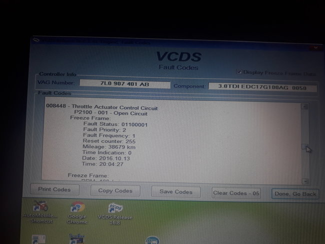

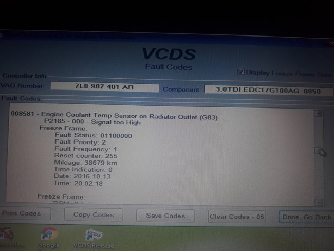

No power boost. Low pick up. VCds says EGR temp sensor voltage high, inlet manifold runner faulty, coolant temperature circuit faulty, and output Speed sensor of automatic transmission

Thanks Ken for the Assistance. It is A VW touareg, 2008 model TDI with V6, 3000 cc engine .

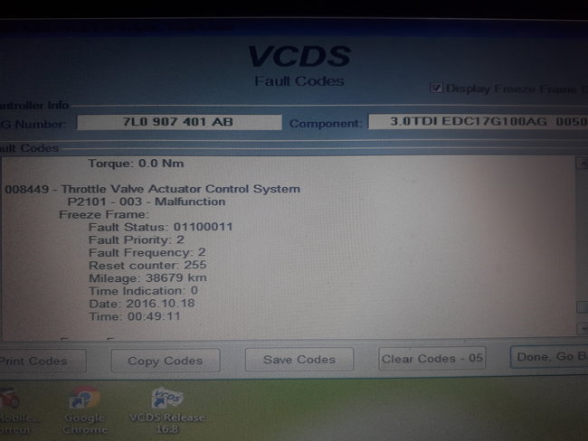

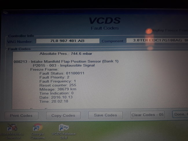

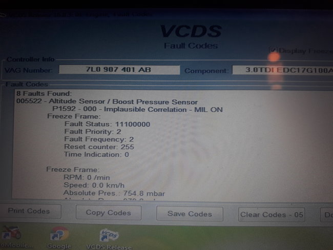

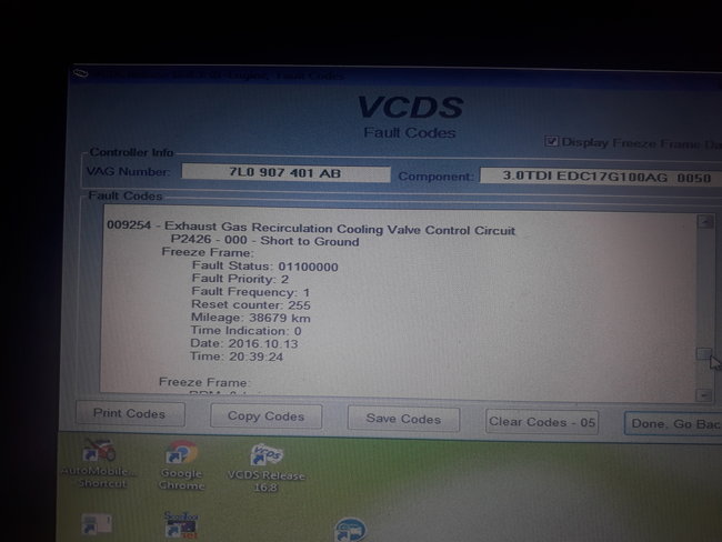

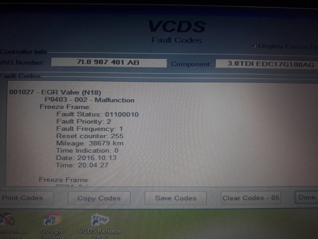

The VCDS diagnostic software says 8 DTCs,
1) 005522 / P1592 Boost Preassure Sensor
2)001037 / P040D EGR Temperature sensor high
3) 008213/ P2015 Inlet manifold flap position
4) 008581 / P2185 Coolant Temp Sensor too high
5) 008448 / P2100 Throttle Actuator control Circuit open
6) 001027 / P0403 EGR Valve N18 Malfunction
7) 009254 / P2426 EGR Cooling Valve control circuit
8) 008449 / P2101 Throttle valve Actuator
I hope this helps. Thanks for your assistance. looking forward to hearing from you soon.

Even after repeated dtc erases, the still persist. Replaced the exhaust temp sensor too. Still the turbo is not engaging.

what is the code that is being set, erasing the code will not fix anything, if the turbo, or boost pressure regulator is faulty this will have to be looked at, but i need the code or codes first to see what is going on here.
Mar 23, 2017 at 10:00 PM
RAJIT PURUSHOTHAMAN
Here are the screen shots of vcds on the vw touareg. Kindly check and advise. I sincerely thank you in anticipation. I Look forward to hearing from you soon

It sounds like you have a plugged catalytic converter follow this guide to check it out,
