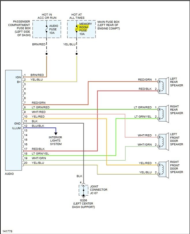

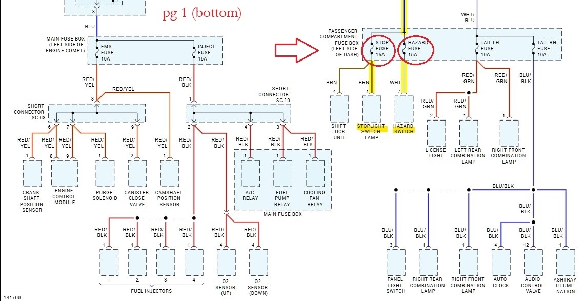

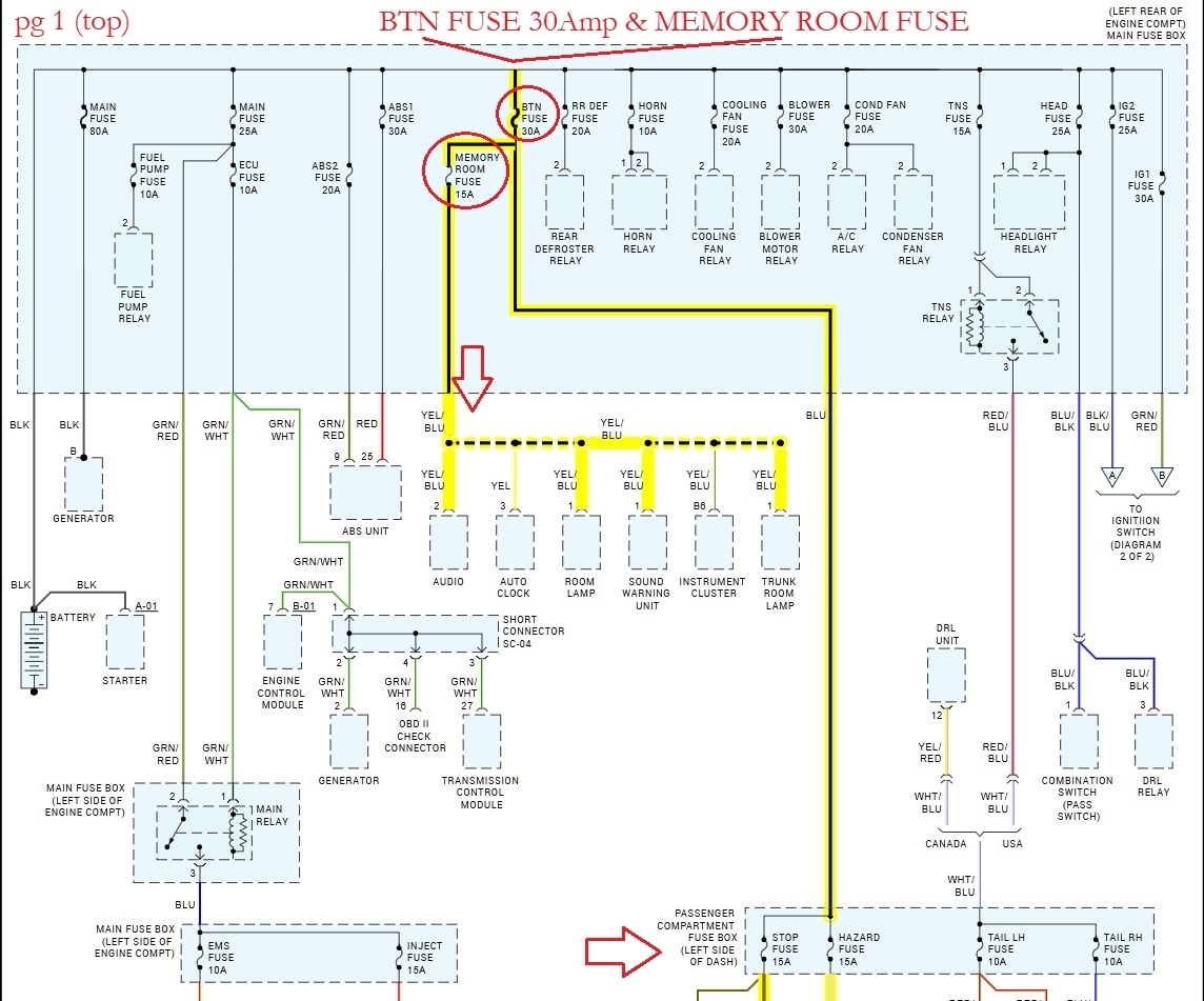

Hello, I know you didnt find any blown fuses, but Id go back over them, checking with a test light on both tabs of each fuse. You can see how the Hazards, Turn signals and Radio are tied together to certain fuses such as the Memory Room Fuse or BTN Fuse. Checking with the Key On, engine off, and then engine running, using a test light will help ensure you didnt miss any fuses. It sounds like you may have a wire on the turn signal/Hazard circuit thats shorted to ground, and didnt pop the fuse until the Hazards were turned on. I will post further info here as well.
Nov 21, 2025 at 2:50 AM
AL514
  • 5,664 POSTS
If these diagrams do not post correctly here, I can send them via email. We are having some technical work done and some imagines of wiring diagrams are not being displayed on the posts in some cases.
