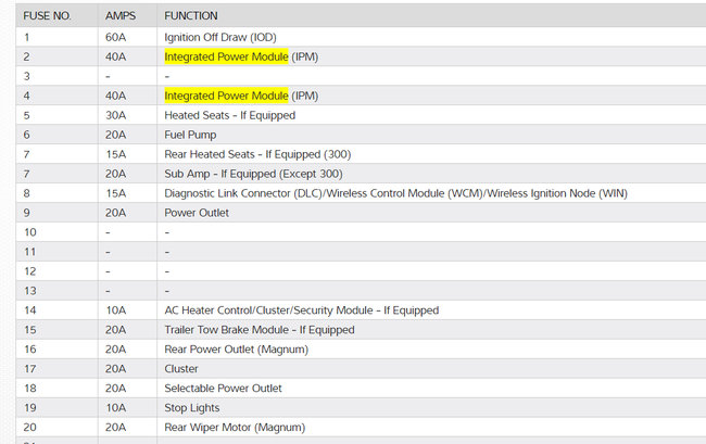

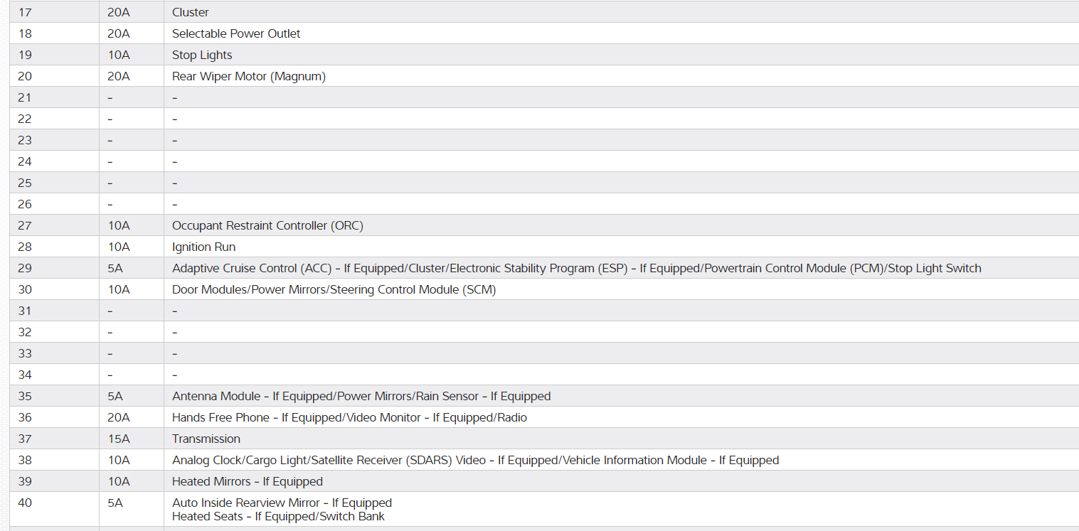

I have no blinkers or nothing on the multi function switch. no horn or nothing. I have checked fuses and got a new blinker and clock spring set up and still not working. can you help please?
Oct 29, 2017 at 9:44 PM
  • 55,256 POSTS

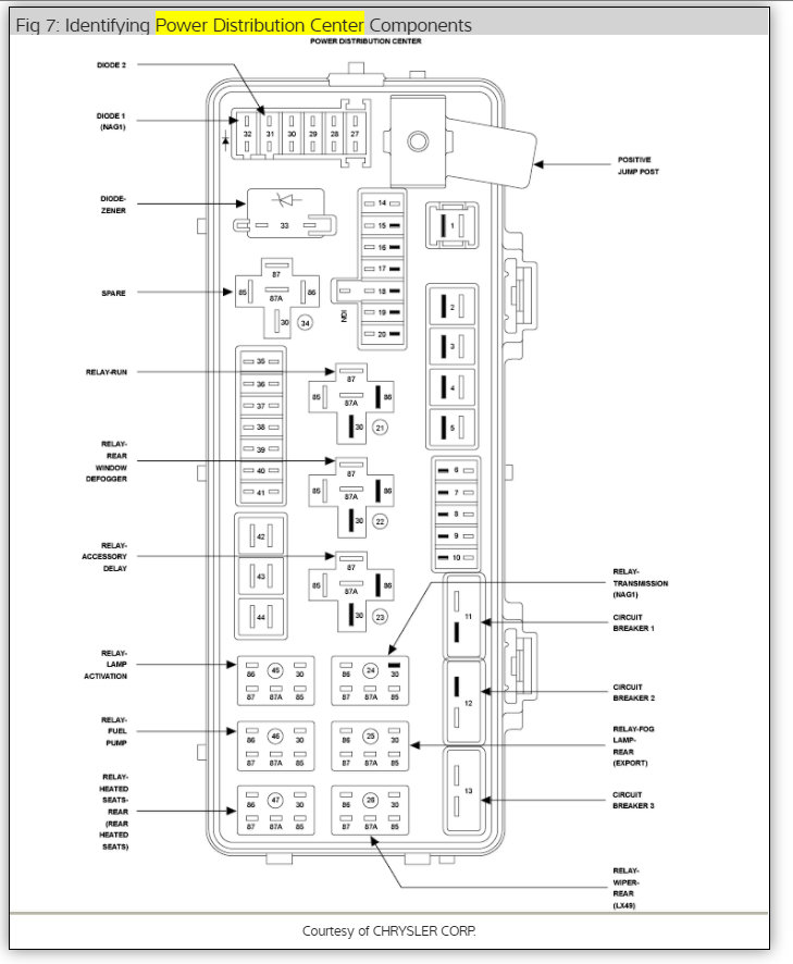

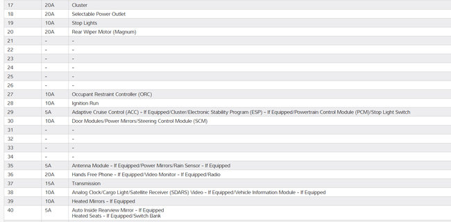

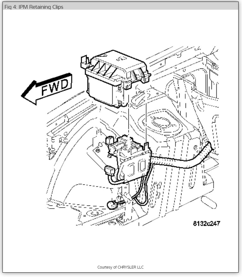

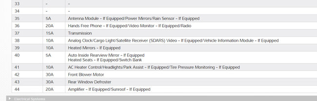

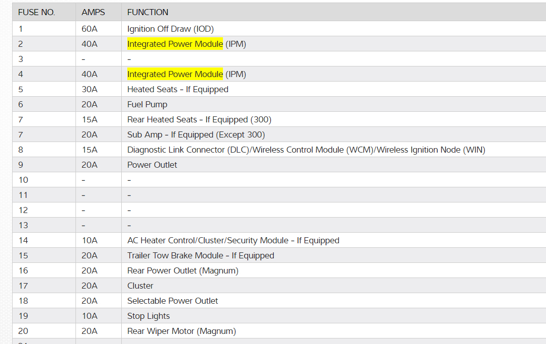

It sounds like you lost the TIPM can you please recheck fuse number 2, 4 and 44 these power the TIPM.
Here is a guide:
Below are some diagrams to help.
If the fuses are good a shop will need to reprogram the new TIPM for you.
Please let us know what happens so it will help others.
