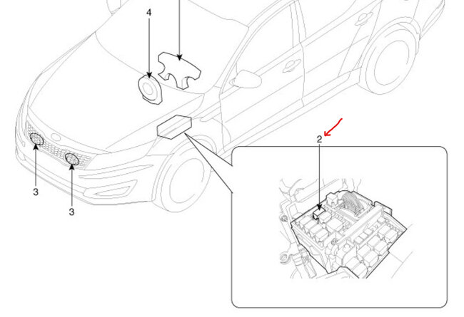

what would stop a car from beeping when pressing the lock button from the key fob?
Feb 1, 2015 at 6:57 AM
HMAC300
  • 48,601 POSTS
weak battery, relay or security issue in car
Feb 1, 2015 at 7:33 AM
  • 55,721 POSTS
I found this information:
Silent Mode: Some vehicles have a feature that allows the lock confirmation beep to be turned off.

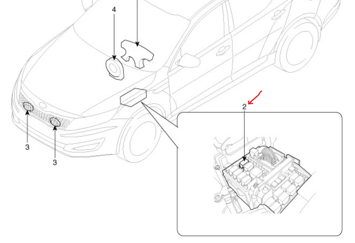

We should see if the horn is working can you confirm? If not and the fuses is good I would replace the horn relay itself which go out often. Check out the images (below). Please let us know what happens.
