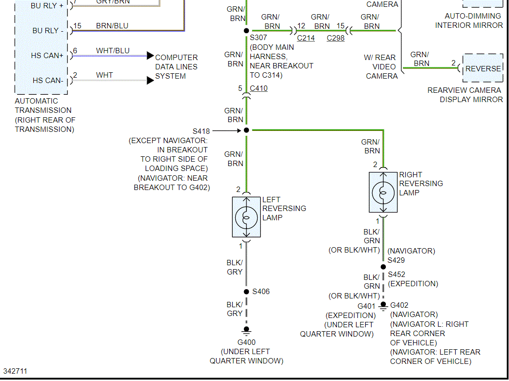

I have no reverse lights. We changed the fuses and bulbs. I need to find the back up switch for vehicle listed above. Is it on the side of the transmission? If you have images, please send!

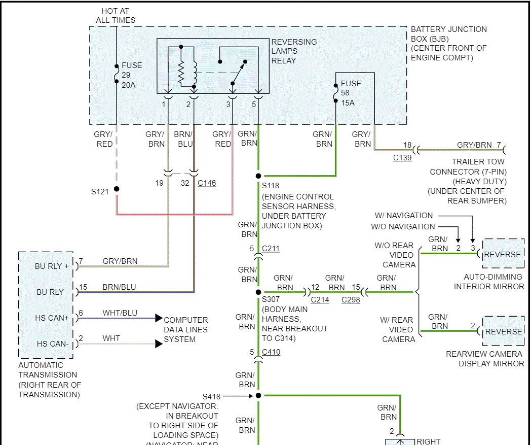

The transmission range sensor is what determines the gear selection and signals the backup lights to turn on. It is located in the transmission (valve body).
When you shift through the gears, is the gear indicator correct?
If you look at the first two pics below, I included the entire wiring schematic related to the backup lights. If you haven't already, check to see if there is power to the lights. If there is, you could have a ground issue. Make sure you check the relay as well. Here is a link to help:
