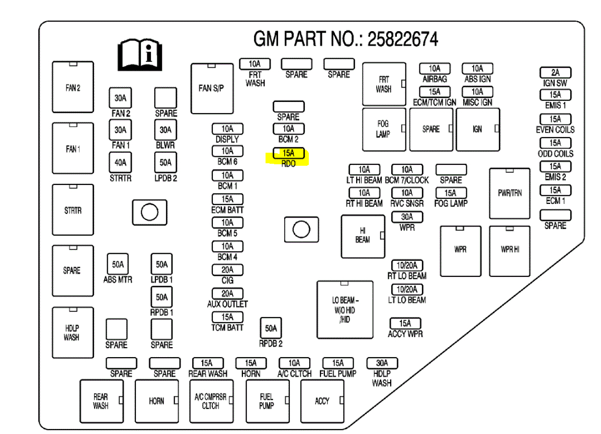

The audio for the signals, seat belts, and the DVD are produced by the audio amp/radio. Actually, the radio generates the audible warning through the left speaker. So, that is where we need to start.
There are two fuses I need you to check. The first is under the hood in the fuse box. It is the radio fuse. See pic 1 for fuse location.

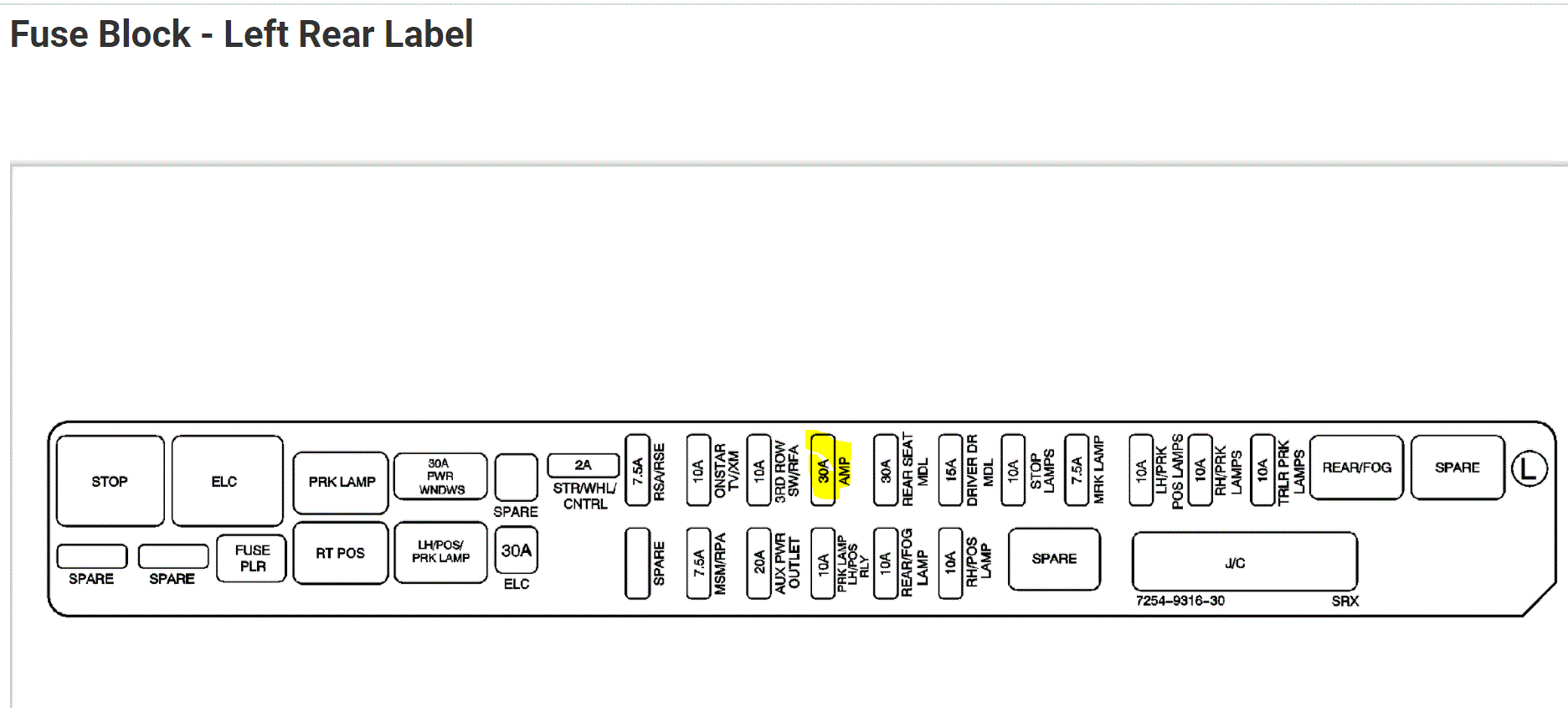

The second fuse is the amplifier fuse. It is located in the left rear fuse box. Pic 2 shows its location.
In addition to checking the fuses, confirm there is power to and from them.
As far as the left rear fuse box, is located under the rear seat on the left side of the vehicle. The carpet must be lifted up to access the rear fuse block.

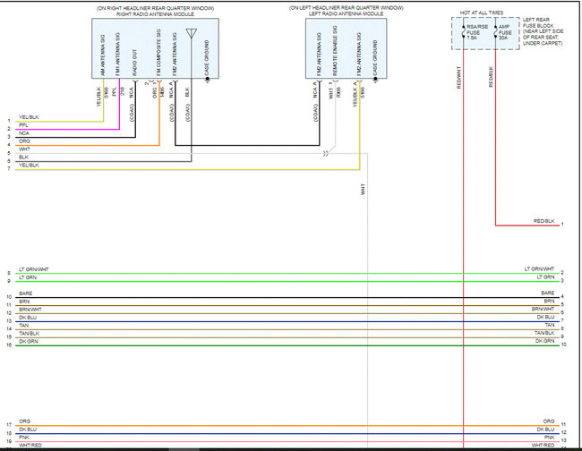

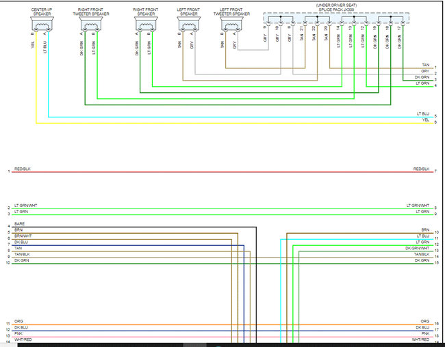

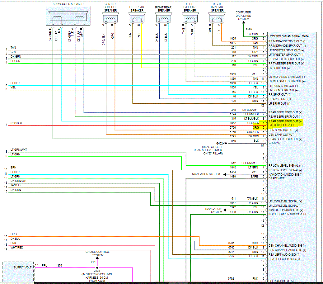

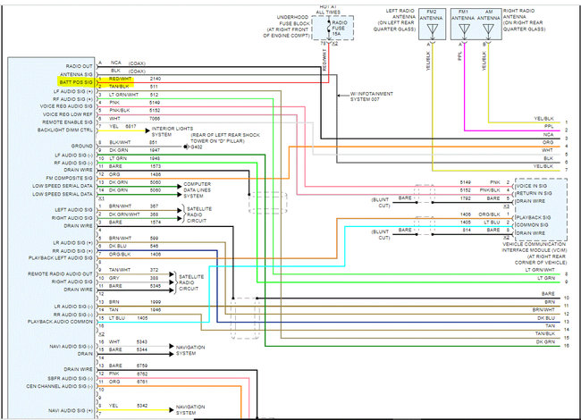

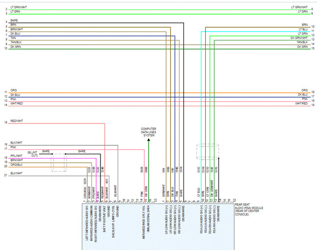

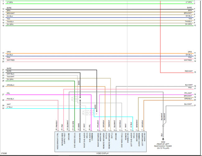

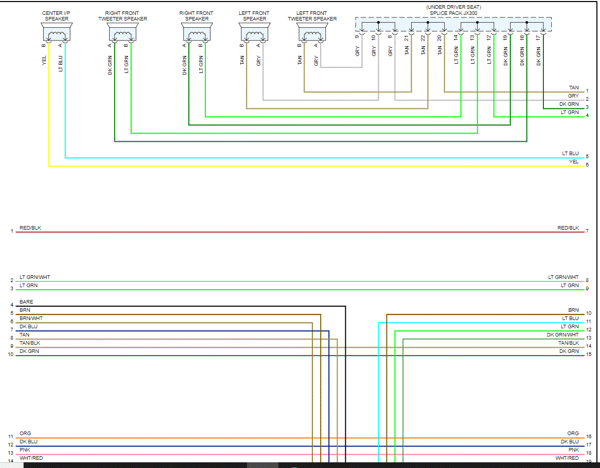

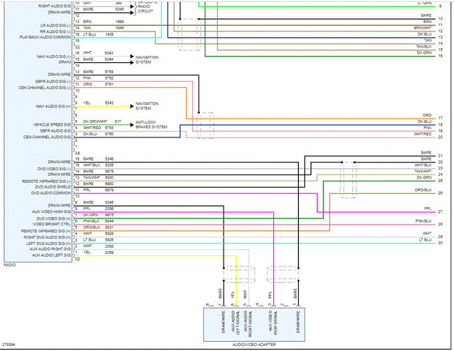

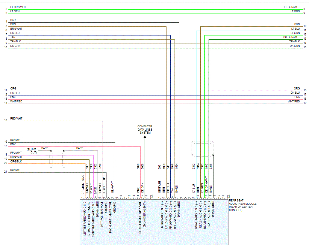

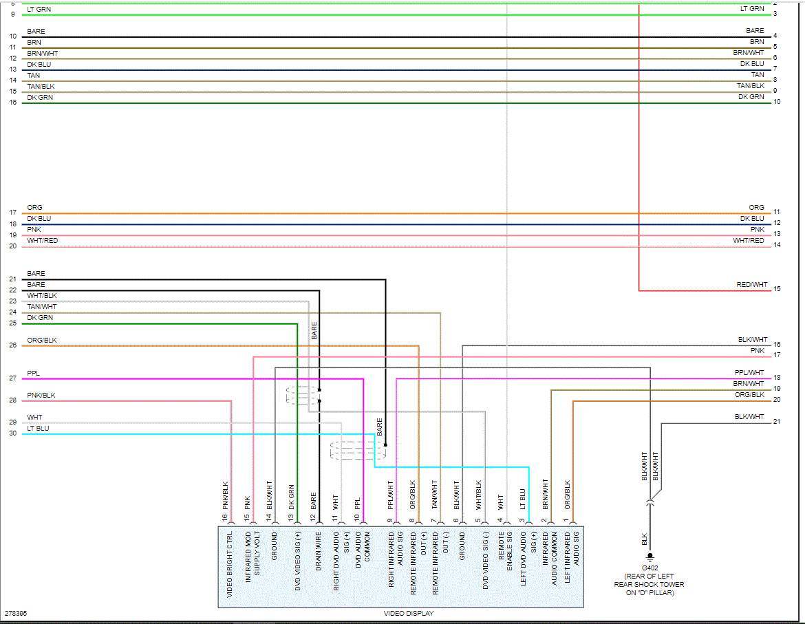

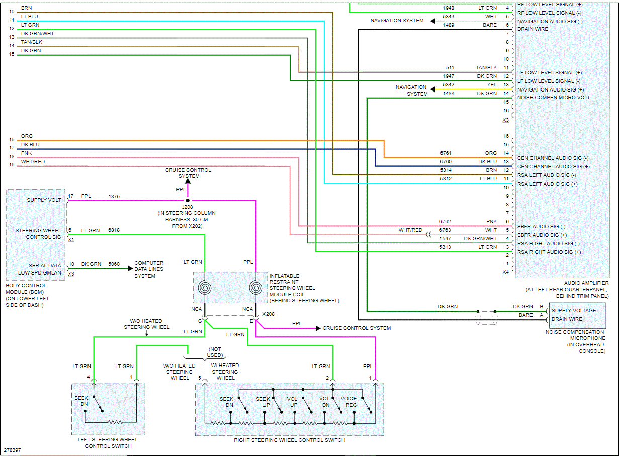

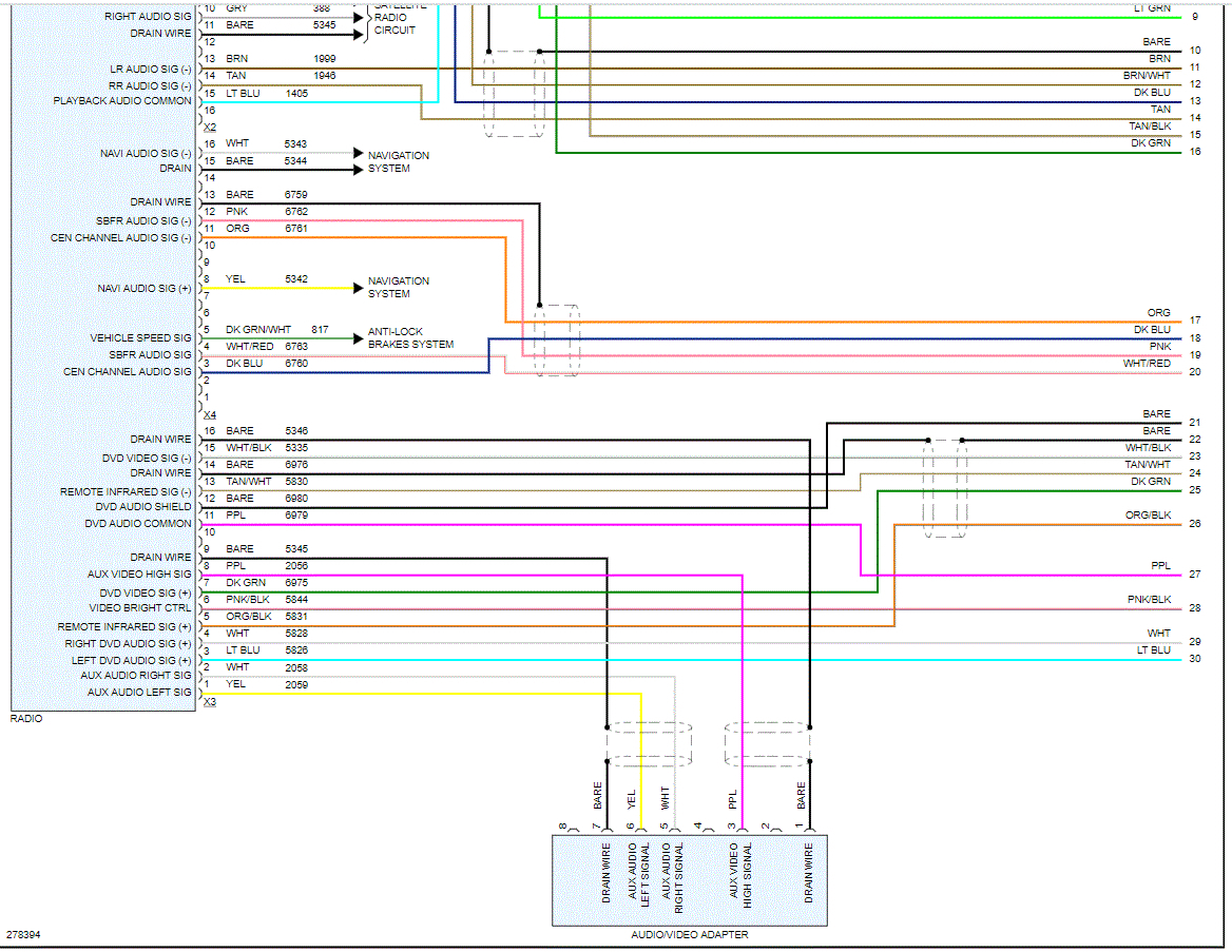

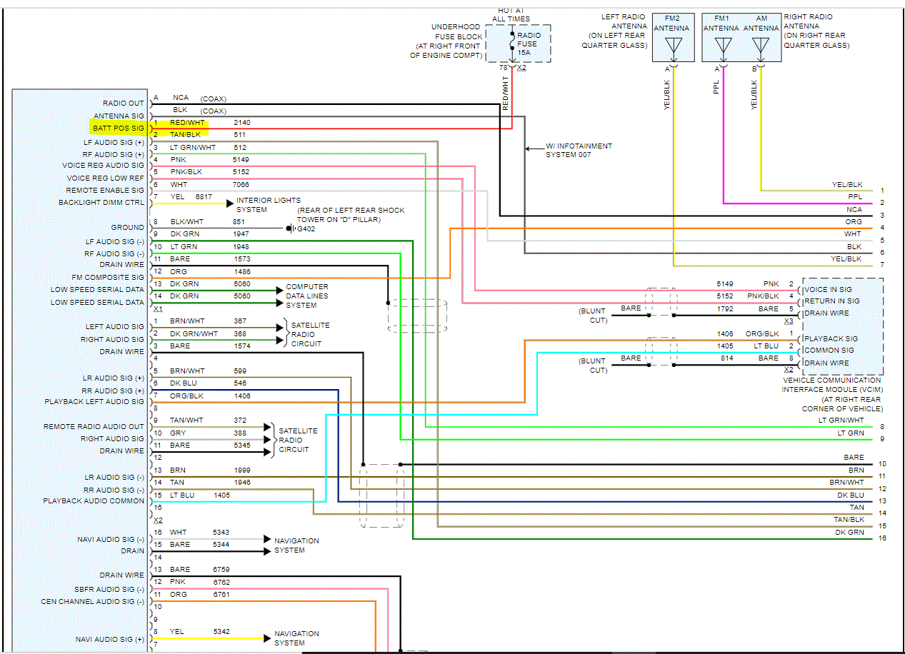

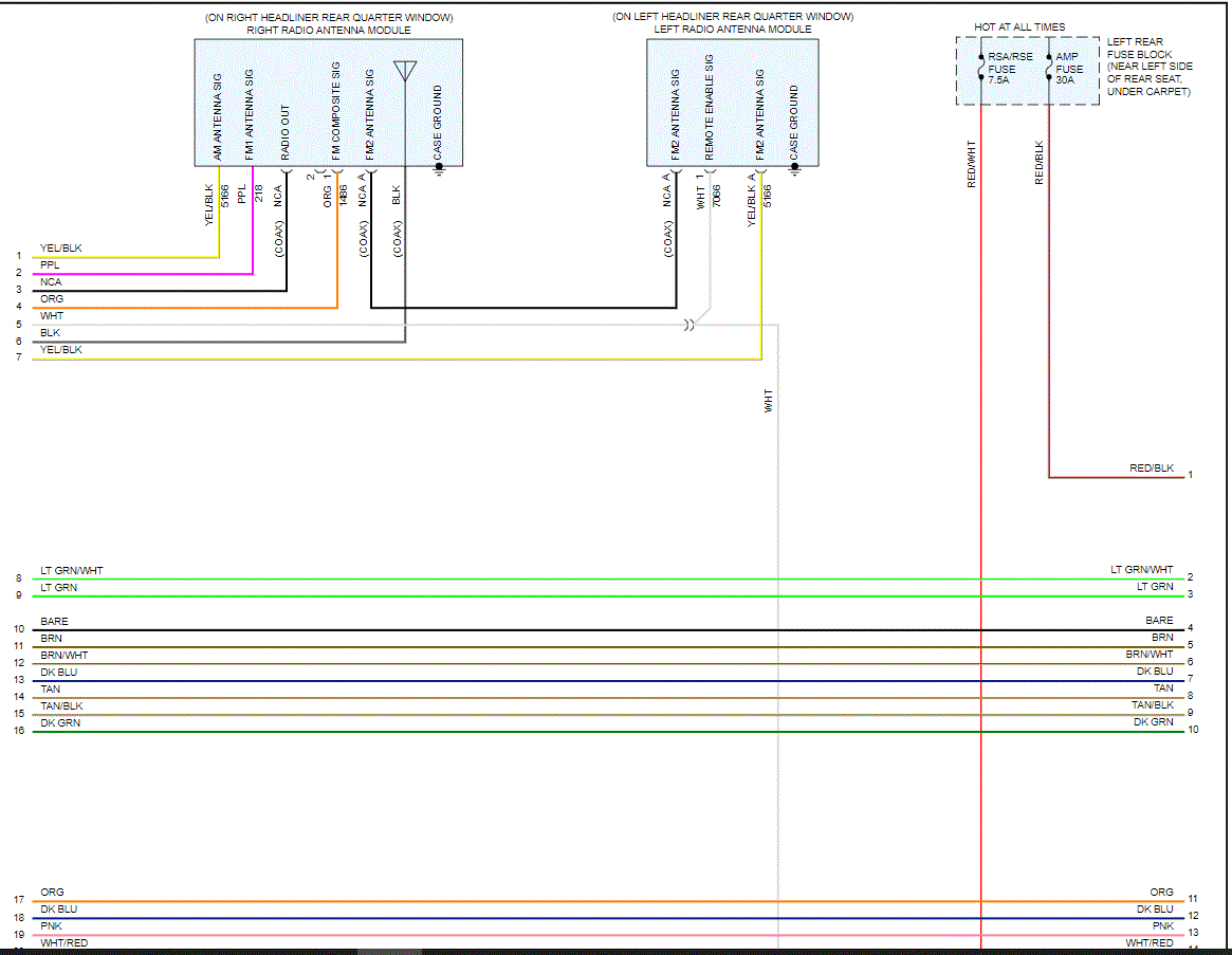

I attached the entire wiring schematic for the radio. They are a little overwhelming for a radio, but I highlighted the two things you need to check. I had to cut the pics in half to make them readable. I did overlap them so you can follow from one to the other.
The first pic shows the wire that powers the radio itself. The seventh pic shows the wire that powers the amp. If the radio turns on, check the amp first.
