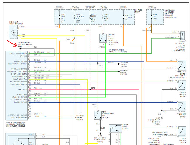

again no communication from obd2 connection in regards to security module, doors will lock manually but immediately click open and fob does not work either. thanks, Steve
Oct 22, 2024 at 5:51 PM
  • 55,421 POSTS

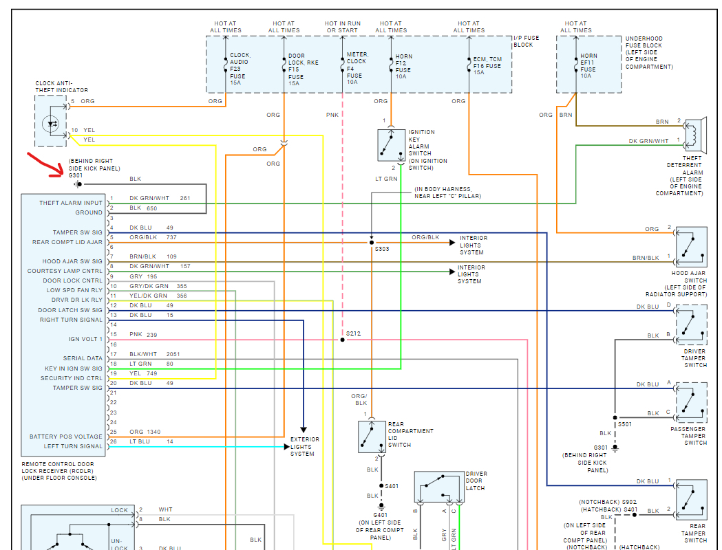

Does the car have a trouble code? So, the data connector works but the security module is not communicating? If so, it sounds like you may have a bad ground (G301) at the right kick panel. Here are the alarm wiring diagrams so you can see how the system works and a guide to help you test the ground connection.

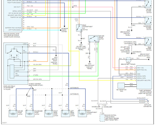

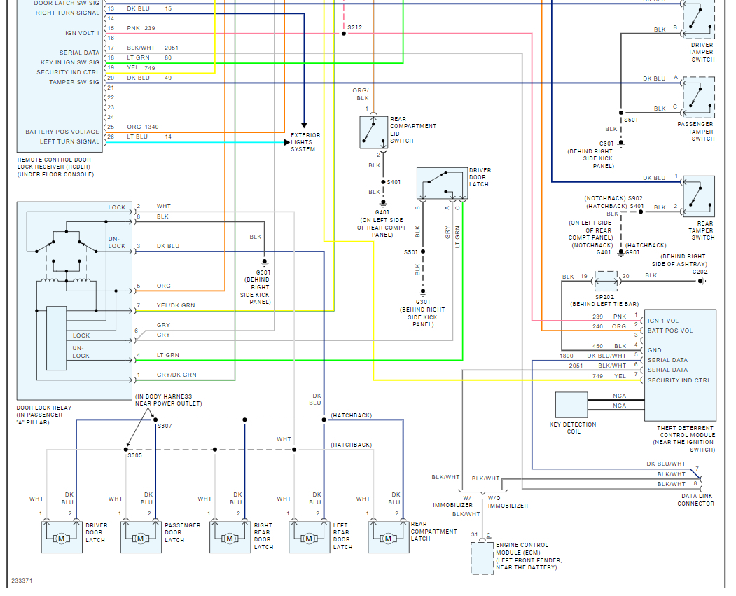

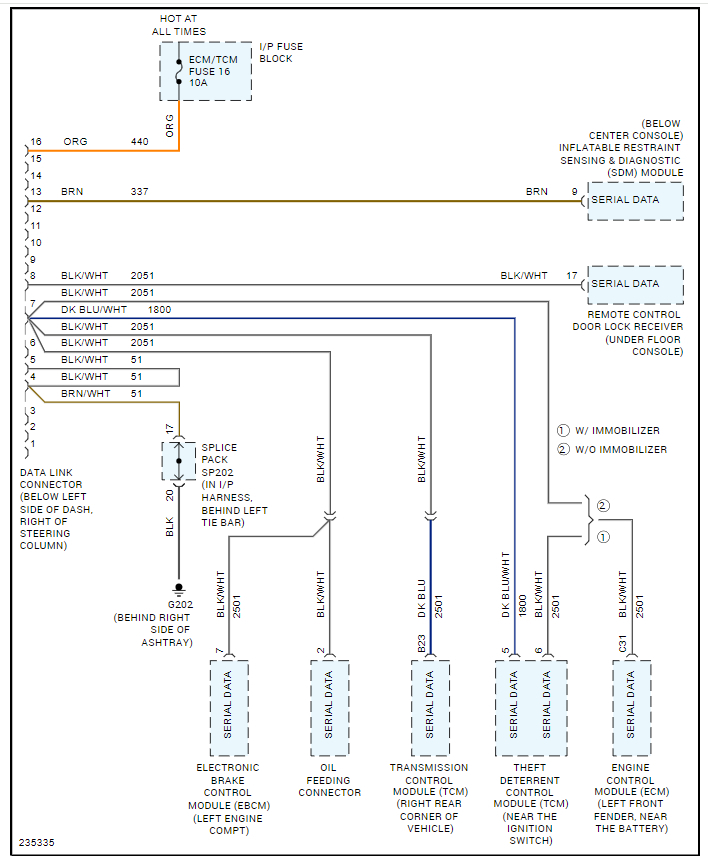

No worries, let's check the ECM/TCM fuse #16 in the fuse panel under dash and if that is good check the ground at the data connector as well, here is the wiring diagram so you can see how the system works. Check out the images (below). Let us know how it goes.
