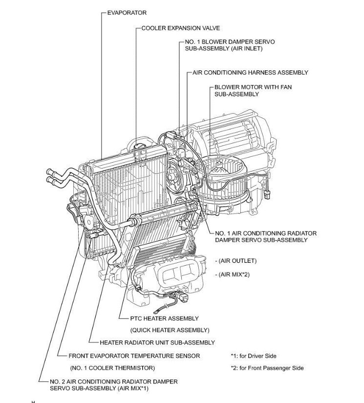

Air vent at window and each end of the dash okay. air vent to center dash very light and no air at feet driver and passenger.
Jun 6, 2019 at 6:03 AM
  • 54,837 POSTS

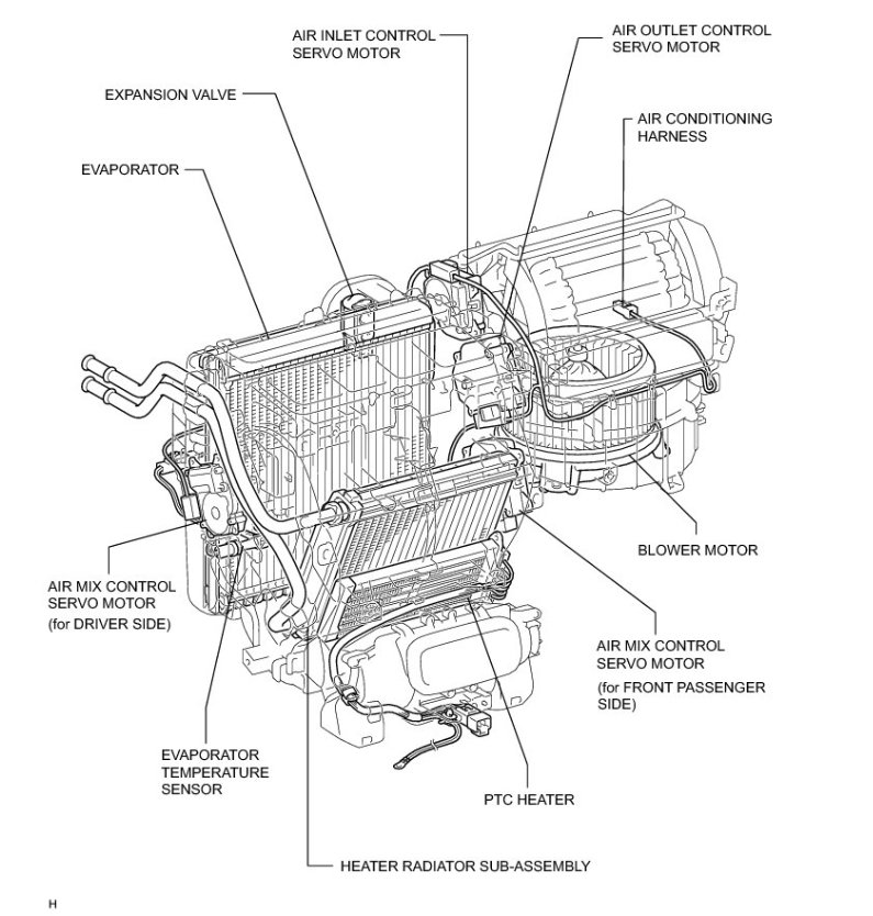

This sounds like the Mode door actuator is out and needs to be replaced. here are instructions and diagrams to help you get the job done below with a generic repair guide to help you see the job being done on a different car so you can see what you are getting yourself into:
They call it a radiator damping servo. Check out the diagrams (below). Please let us know what you find. We are interested to see what it is.

I investigate for a while and gears connected to servo motor don’t move any shutter. i used the switch to set defrost, face or feet. No gears move and i have vent all places. it is not useful to get cold air in defrost position when it’s very hot outside. To access two screws retaining the servo motor is it easy to remove the fan and intake assembly or is there a special screwdriver to use in these small spaces?
Thanks,
Daniel
Jun 10, 2019 at 12:25 PM
  • 54,837 POSTS
Yes, you may need to use a little imagination to get the screws out. can I ask if the other controls seem to work? Can you turn the system on and watch the actuator move?

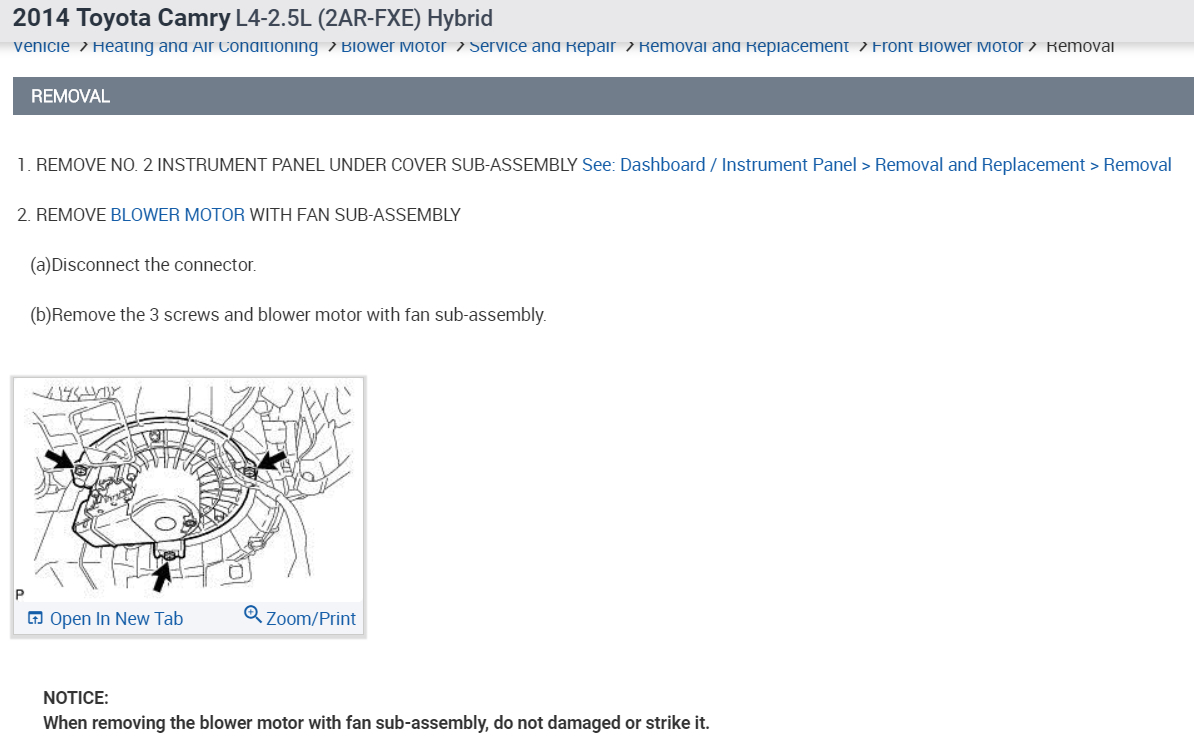

  • 54,837 POSTS

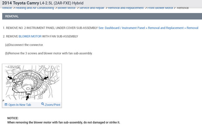

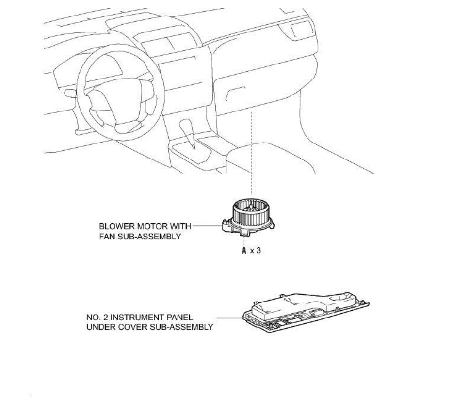

it is up to you to continue but here is the blower motor location and how to remove it. Check out the diagrams (below). Please let us know what you find.

DANIEL COULOMBE
  • 6 POSTS
Hello Ken ;
Case close Toyota Camry Hybrid 2014;
Abstract : no vent nor cold or hot air at faces and feet ; defrost OK
Problem source ; a screw fall in air vent gears that prevented the door to works accurately
Problem solution :
-removed the housing containing the wheel path (and by the way removed the falled screw ) to do this you have to unscrew 3 screws ... 2 at the bottom (you have to use a very short screwdriver for 1 of these) .....1 screw at the top (activate the air recirculation; it open a door and you will be able to access the screw passing through the left side of the opened box)
-replaced the housing containing the wheel path ; didn’t install completely .... just enough to see how the wheel worked and did it many times to find the appropriate way ...... tied screws when worked correctly
Not easy .... no space.... no professional tools.... anyway it’s done....
Tks for help
Regards
daniel
