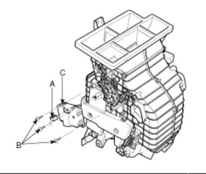

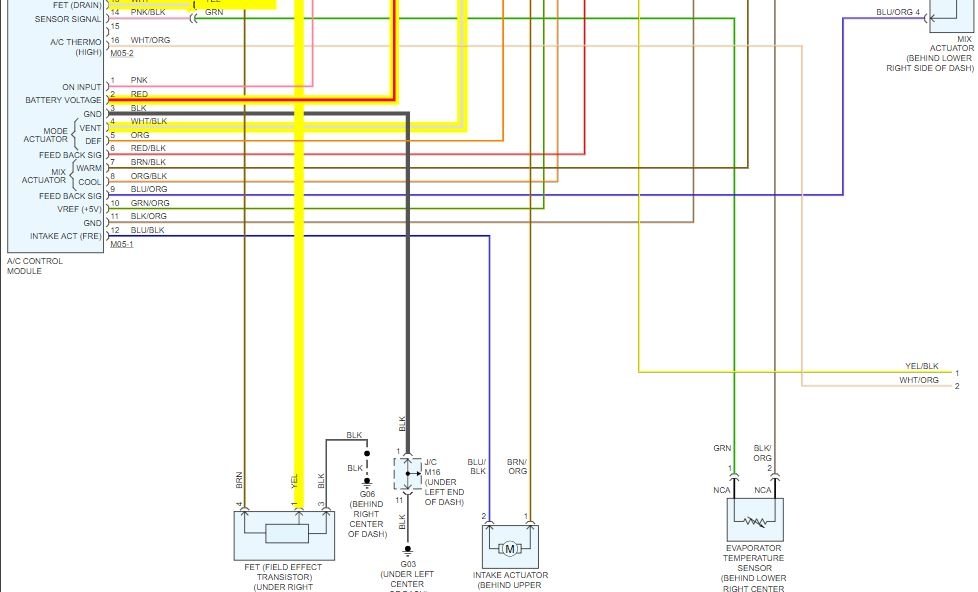

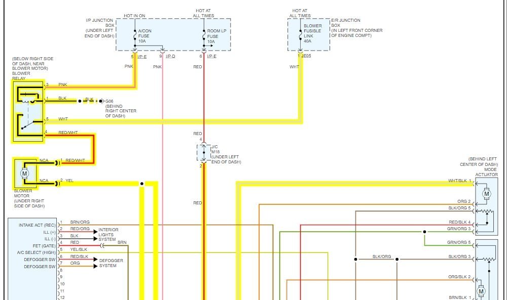

Blower is working but no air is coming trough the vents to demist the windscreen.

I attached the procedure for the mode actuator. It directs air through the different modes.
I also attached the wiring diagram for the blower motor as well in case it is not blowing fast enough.
REPLACEMENT
1. Disconnect the negative (-) battery terminal.
2. Remove the lower crush panel .
3. Disconnect the connector (A) of mode control actuator after removing the air duct.
4. Loosen the mounting screws (B) and then remove the mode control actuator (C).
5. Install in the reverse order of removal.
