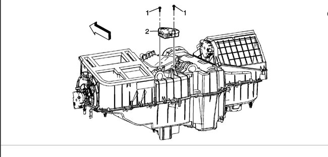

No air flowing to the windshield. Mid and low vents work fine. When selecting the windshield vent on the temperature control panel, air still flows through the middle vents and nothing comes through the top. There is no clicking sound when key in ignition. Cold and hot air work fine. Temperature control works well.
Oct 16, 2019 at 7:04 AM
DANNY L
  • 5,648 POSTS

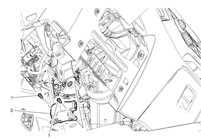

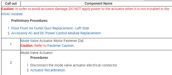

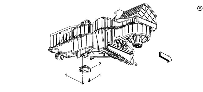

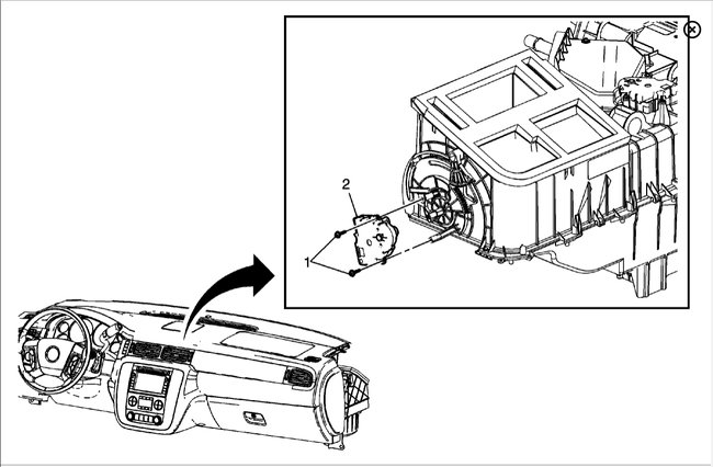

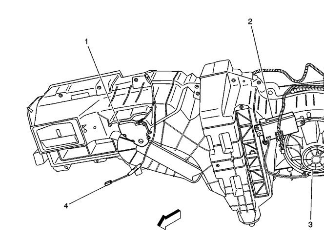

It sounds like you are having an issue with the mode blend door actuator. It's a small electric motor that opens/closes to move air flow throughout the proper air ducts. Here is a tutorial to show what's involved for replacement:
I've attached step-by-step pictures below including its location for your specific Chevrolet truck.You will need a GM scanner to calibrate the actuator after replacement.Hope this helps and thanks for using 2CarPros.
Check out the diagrams (Below). Let us know what happens and please upload pictures or videos of the problem.

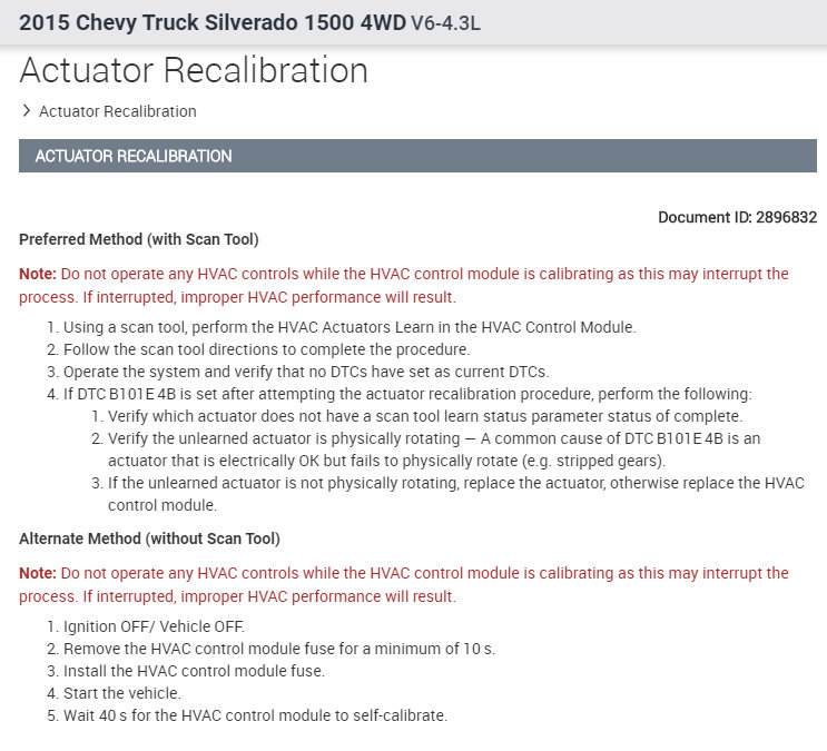

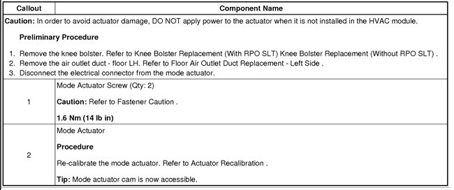

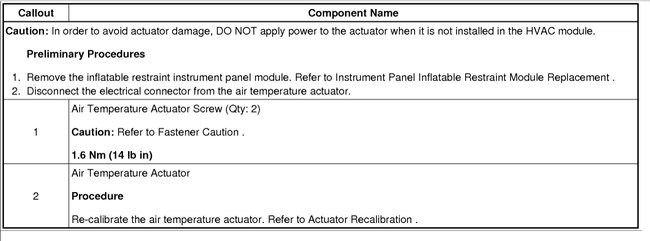

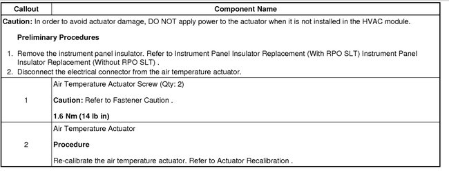

Okay it sounds like you have a mode blend door actuator that is going out. Here is a guide that should show you what you are in for when doing the job.
Here is what it will be like in your car (below)
The diagrams are Mode, Right then Left air blend door actuators. After replacing the actuator the system may need to relearn which can be done by removing the HVAC fuse for 15 minutes.

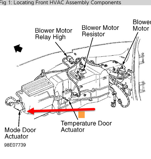

try puling the heater fuse and see if the control will reset. if not you'll have to see if your actuators are getting power to operate. i'll send a generic pic along to show where they are....

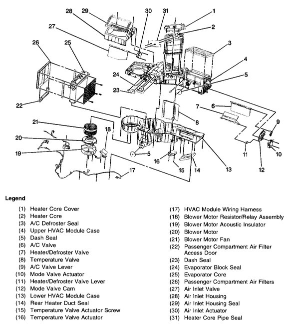

STEVE W.
  • 15,354 POSTS
As the mode doors seem to be working I suspect the blockage is down in the blower area itself, around the squirrel cage. Item 20/21 in the image. I would drop the blower motor out the bottom and see what you find. It is real simple, remove the sound deaden-er cover screws, disconnect the wiring, drop the cover off, release the tab and turn the motor counter-clockwise to disengage it from the housing. Maybe put a plastic bag under it, just in case it has debris in it. With the blower out you can use a light and a vacuum hose to clean out the housing of whatever you find.

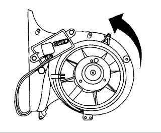

Well my flex shaft attachment for my ratchet finally got here (there was no room for any other approach to the screw behind the housing) and I took the bottom plate off under the fan motor (I was expecting to be able then to drop the motor but it only exposed the very bottom of it. Please explain again how to get the fan out. Is there a video or some photos available perhaps?
Apr 28, 2021 at 11:48 AM (Merged)
STEVE W.
  • 15,354 POSTS
There is a tab you press in and rotate the motor counter clockwise and the blower drops out. Sort of a child proof blower....

HMAC300
  • 48,601 POSTS
try pulling heater/A/C fuse inside truck It may reset actuators. if not it may be the mode actuator that is bad. it is above gas pedal. See picture.
