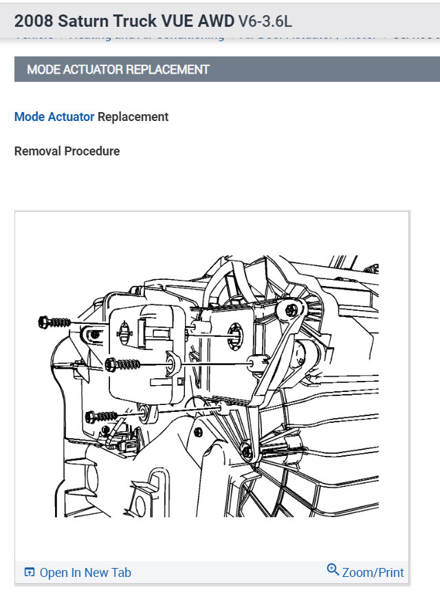

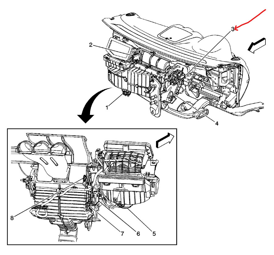

Okay, I replaced my resistor and my blower motor, but my motor still isn't working, and I have ice on my A/C lines. there's no air blowing out of vents at all. I replaced air filter too. any ideas?
Sep 1, 2023 at 3:16 PM
  • 55,423 POSTS
So, can you hear the blower motor running, but no air is coming out or you cannot hear the blower motor working? Here is a guide to help please let me know which one it is. If you are not sure, please upload a short video of the problem so I can tell for sure what's going on.
https://www.2carpros.com/articles/low-or-no-air-flow-from-vents

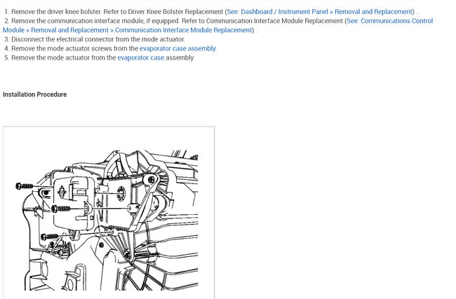

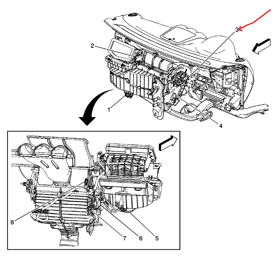

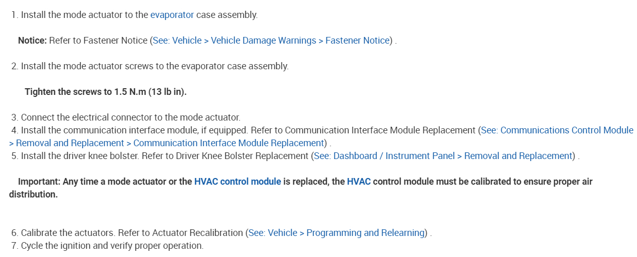

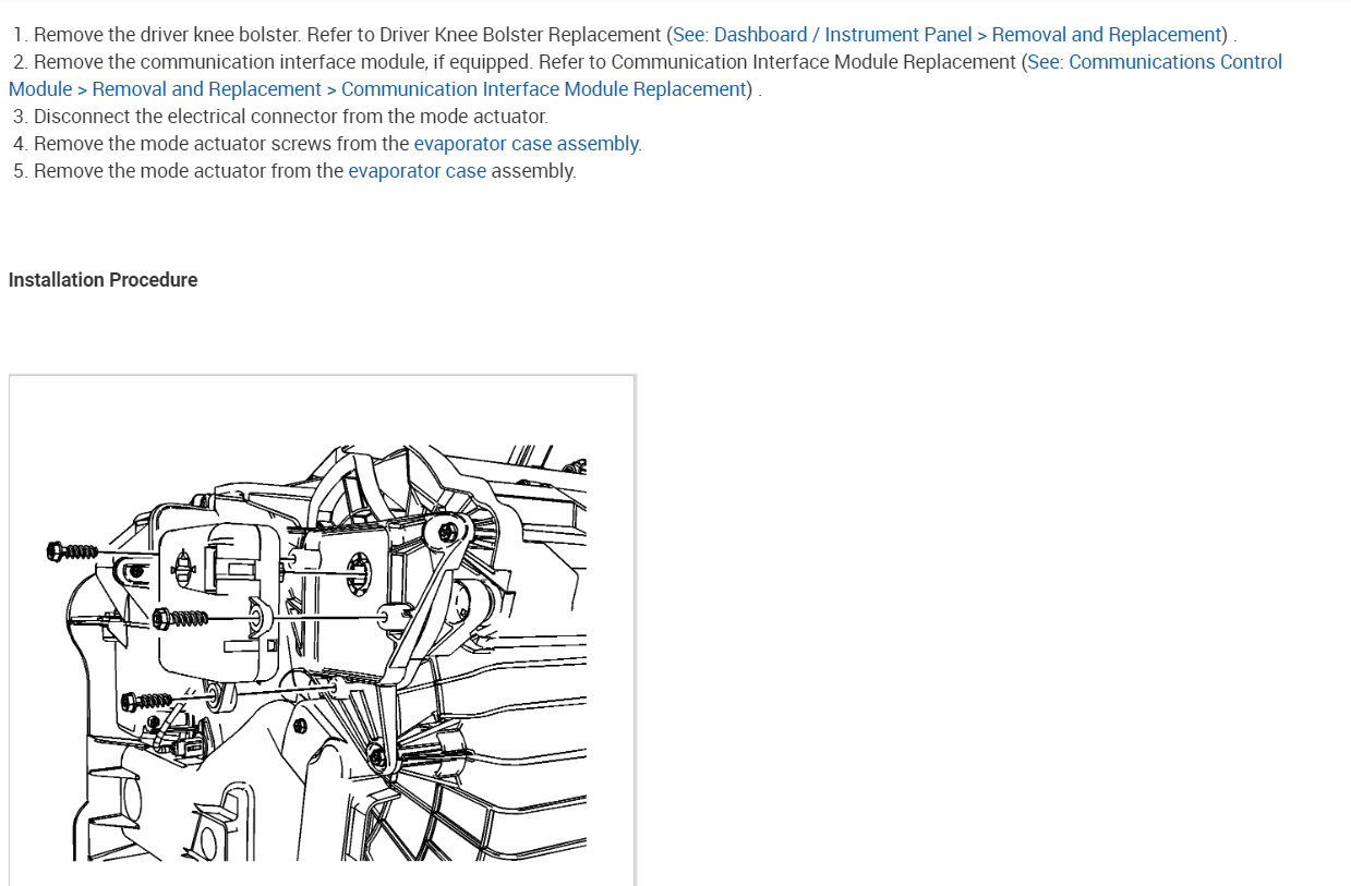

If you can hear the blower motor working the mode actuator needs to be replaced, here are the instructions and location of the actuator. Check out the images (below). Please let us know how it goes.
