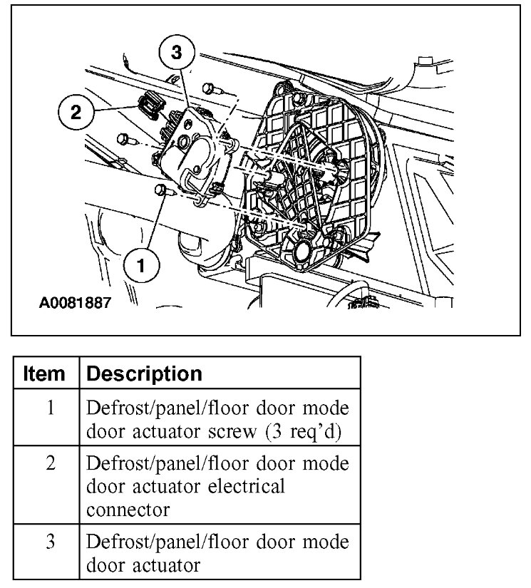

Air blowing from defroster inside of windshield. Rear blowing from rear of van. No air blowing from the front vent. only from passenger side door from front vent air is blowing .

This is common when the HVAC defrost/panel/floor actuator goes out, here is the location so you can change it out. Check out the images (below). Let us know if you need anything else.
