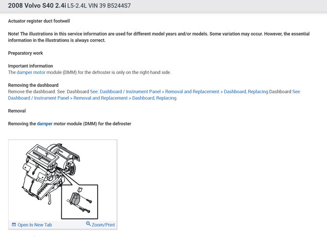

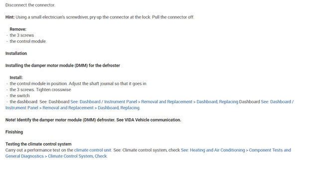

If it continues to come through the defroster only, you must have a bad blend door actuator or one is broken or disconnected. If I recall, the Volvo actuates the vent doors by the HVAC. Check to make sure there are no broken wires. Here is the location

The defroster is just one item in the HVAC system. There is plastic duct work that takes the air to where it needs to go. The air flow direction is done by vent doors. By opening and closing, the air is diverted to different places.
