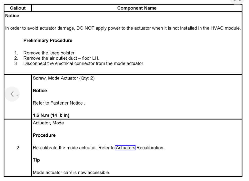

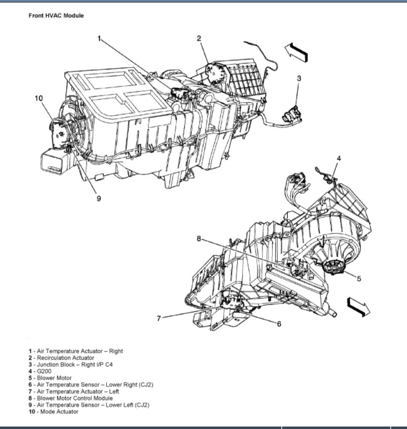

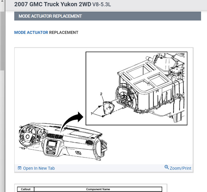

More than likely this is the mode door actuator has failed and you are getting a little bit of air due to the door being mostly closed but a little bit of air is able to get through.
Here is a guide that will help with this:
https://www.2carpros.com/articles/low-or-no-air-flow-from-vents
Take a look a the info attached below and let me know if you have questions. However, I would suggest accessing the actuator and move the position of the air and see if the actuator moves.
