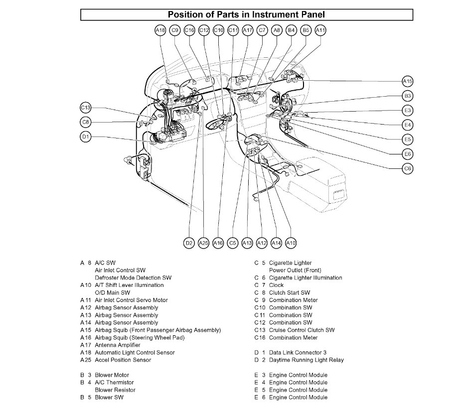

No air from center console/dash vents?
65,000 MILES
RLOEHR8173
Heat and A/C work fine, but no matter the settings, there is never any air coming from the two dash center vents.
Apr 19, 2023 at 7:17 AM
  • 55,606 POSTS

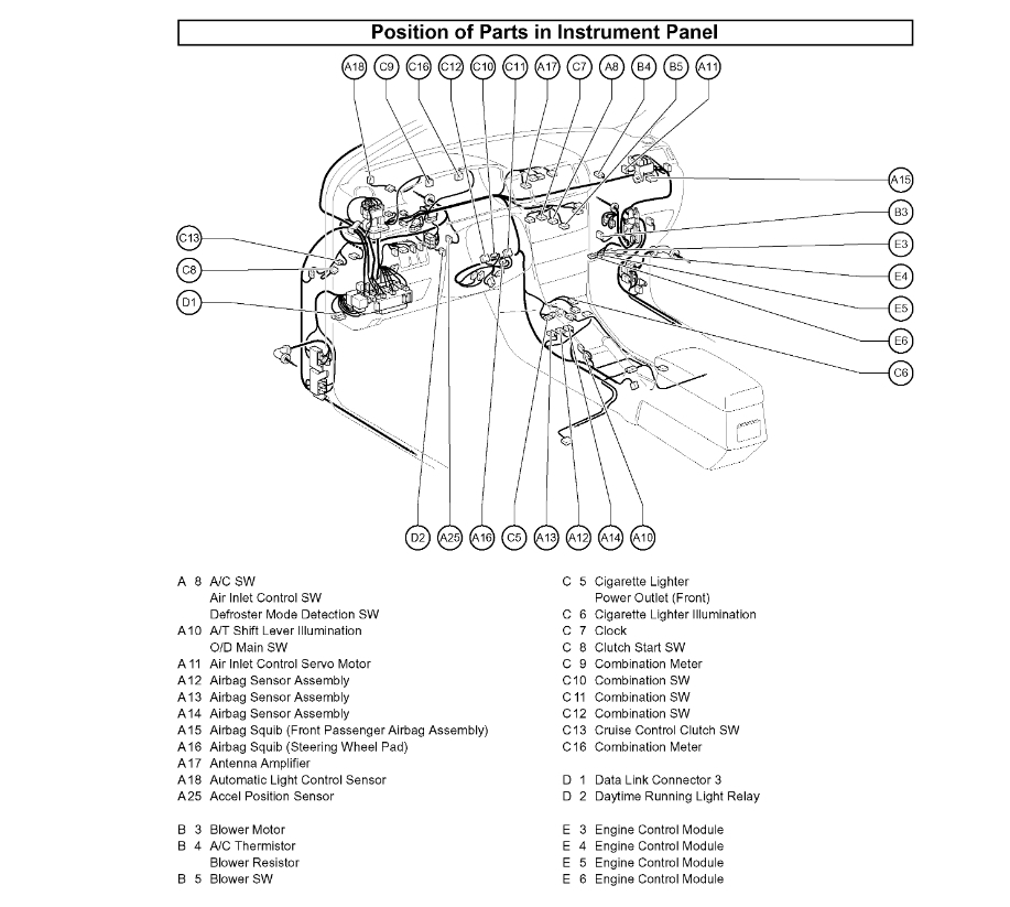

This happens when the air inlet control actuator is not working here is the location and how to change it out in the diagrams below. (a11). Check out the images (below). Please let us know if you need anything else to get the problem fixed.
