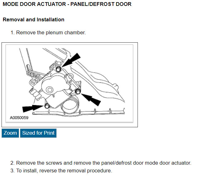

Blower running full blast. Air coming floor board but unable to have full flow through dash vents. This happened before but in three or four days it reset and started blowing out vents.

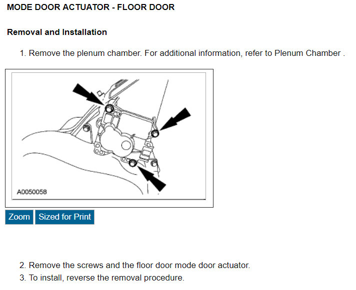

There are two blend door actuators that need to be checked to see if there are moving when the the controls are moved to the various positions. Here is a guide to help you see what you are in for when doing the job and the locations for your car are below:

There is a mode door motor that controls the flow of air in the commanded direction. It is a common failure.

I had this problem to thanks for the guides it ended up being the panel defrost actuator. I got a new one for $56.00 on Amazon.
