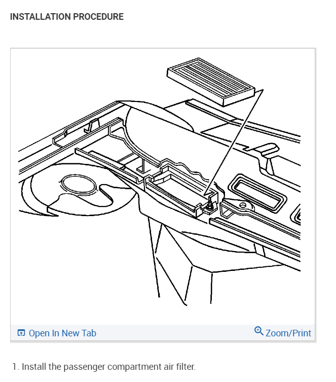

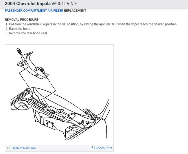

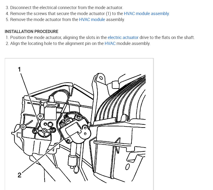

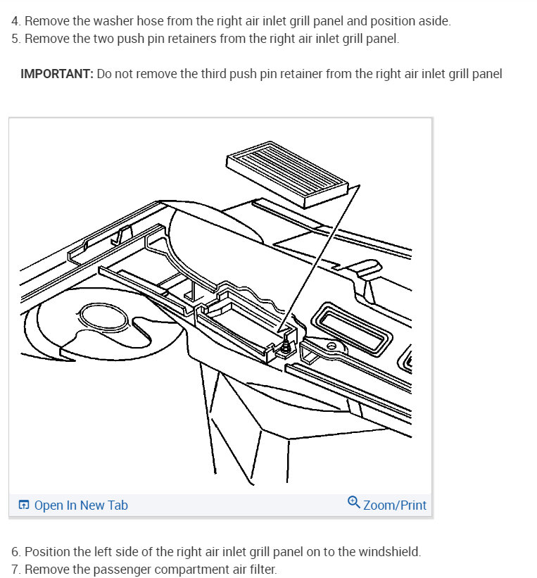

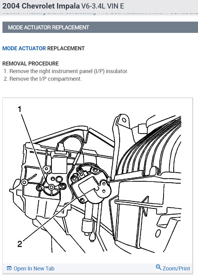

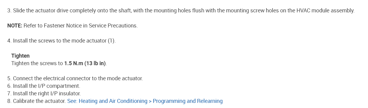

Press all buttons and I am getting no air coming from the vents.
Aug 6, 2023 at 4:00 PM
  • 55,684 POSTS
There are two things that can cause this, the cabin filter is clogged or the mode acturator needs to be replaced. Please go over this guide and check the images below as well:
https://www.2carpros.com/articles/low-or-no-air-flow-from-vents
Check out the images (below). Please let us know how it goes
