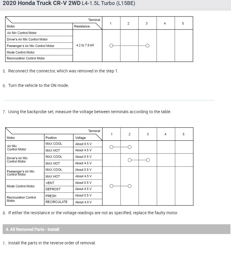

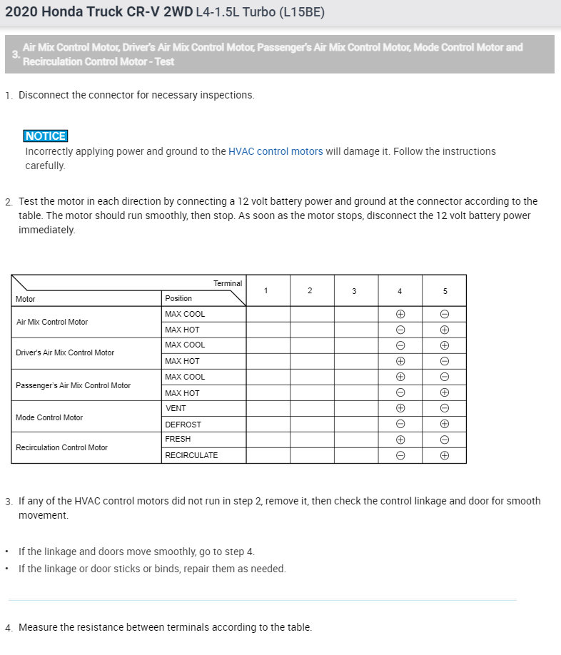

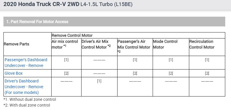

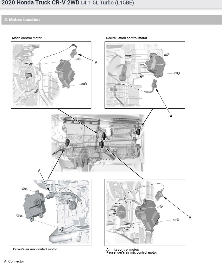

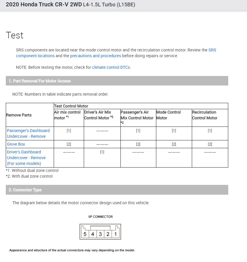

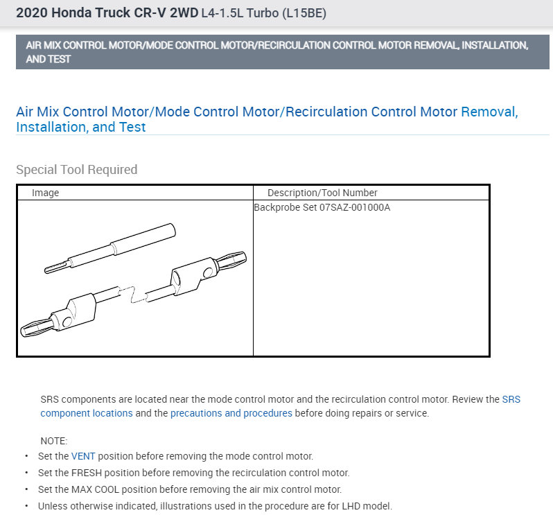

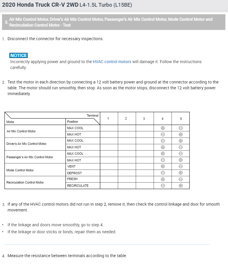

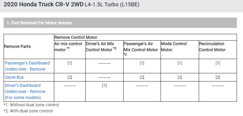

It sounds like the there is an issue with the mode door actuator. The mode door controls the air flow direction (vent, floor etc.).
It is located behind the dash in the HVAC box.
https://www.2carpros.com/articles/low-or-no-air-flow-from-vents
Given that your vehicle is 2020 and with 14,000 miles, this should be covered under factory warranty.
