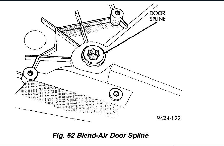

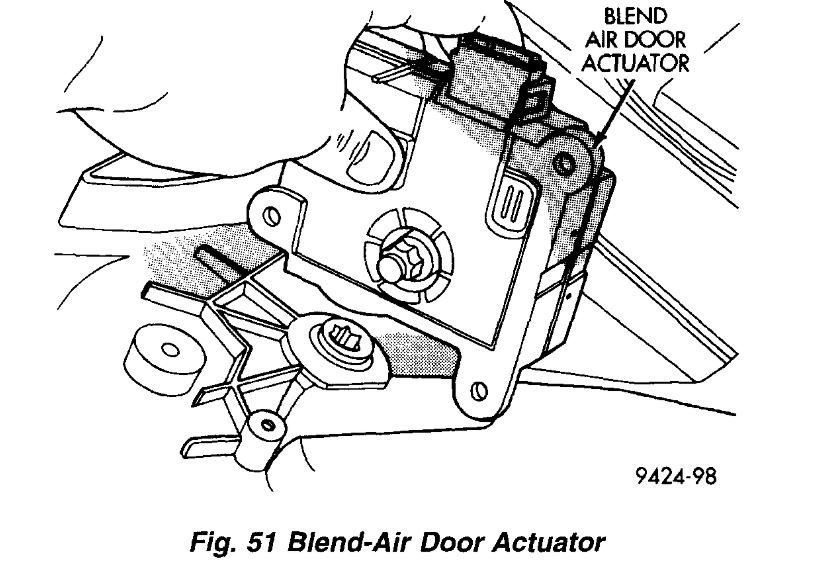

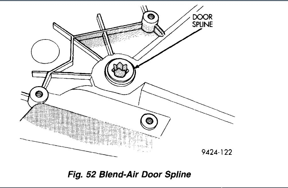

When I start car in seconds clicking sounds from rt dash. I tried the 3 button test at 75 degrees. Did not get read out.Just said Auto fan 75 degrees.
Is it the blend door actuator?

The noise is common when the gears fail inside.. There is a constant ticking and the blend door will not move.
REMOVAL
1. Remove left and right underpanel silencer/ ducts. Refer to Body and Frame/ Interior Trim/ Console/ Service and Repair. See: Console > Service and Repair
2. Remove two screws from actuator which are accessible from the right side of center stack.
3. Remove one screw from actuator on left side.
Blend Air Door Actuator
Blend Air Door Spline
4. Pull actuator straight down from shaft and disconnect electrical connection. Upon removal, note the shaft position of the actuator, because the shaft on this motor is keyed. When installing new actuator, its shaft must be positioned in the same location.
