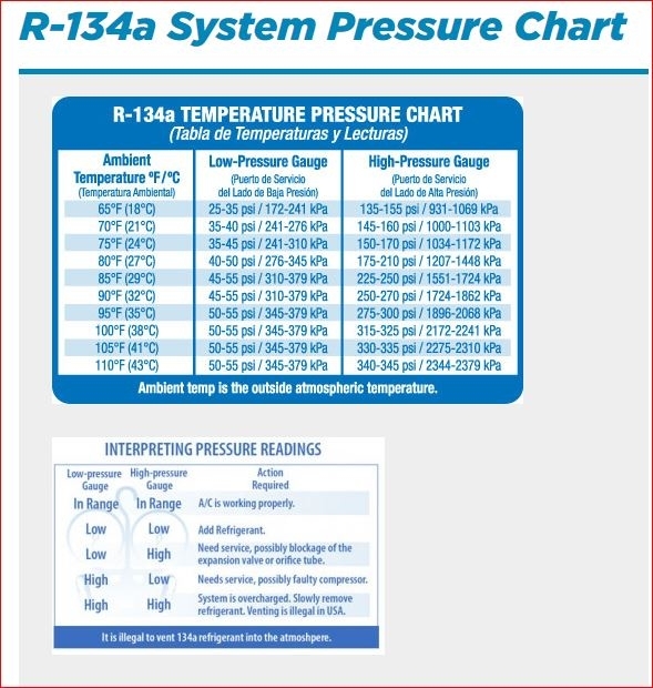

Sounds like the compressor is not engaging at all. For the the low side to be 94 PSI that is pretty normal when the system is static.
When the compressor engages it pulls the low side down and builds the pressure on the high side.
I suspect you have one of two issue. Either the compressor is not functioning due to no power or the compressor has failed.

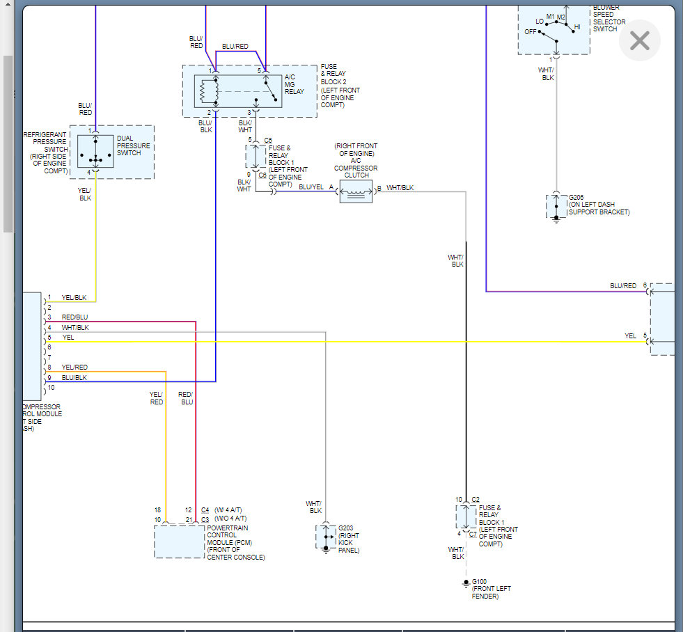

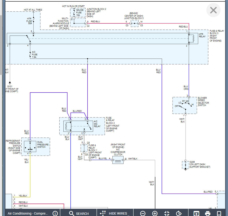

I attached the wiring diagram below for your review.

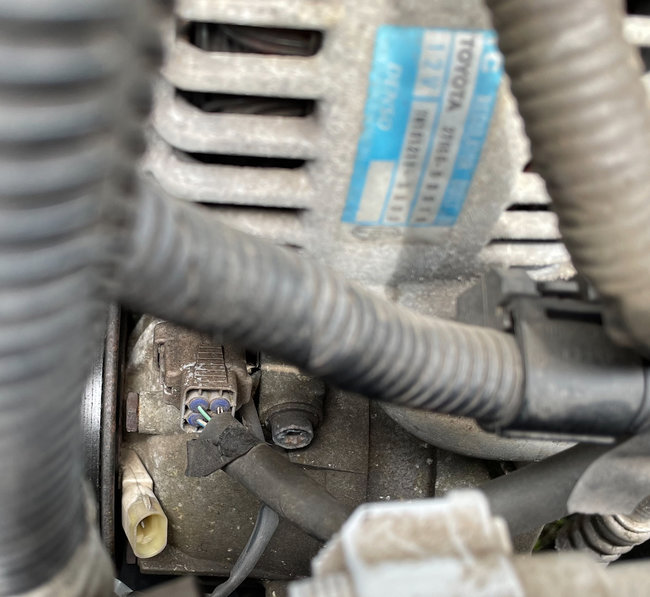

I see two different harnesses going to the compressor. One has 2 wires, which looks like it matches the wiring diagram, the wires are white/black and blue/yellow (I think yellow, hard to see for sure). I pulled the connector and checked voltage (touched multimeter probe to the inside of the connector where the blue/yellow wire goes.) It reads 0.1 volts with the A/C on or off. Blower is on high when testing. So not getting voltage here.
The other connector has 4 wires. Picture attached - this connector is in place, I didn't pull it off. Do you know what this harness is for? Do I need to check voltage here?
thanks
PS: the blue/yellow wire looks like it's making a solid connection at the connector - it's not loose or frayed.
Jun 26, 2021 at 4:20 AM

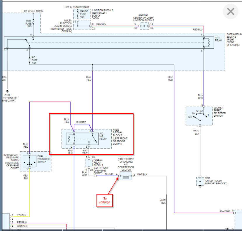

The two wires that you removed and tested is for the compressor clutch and should have 12 volts when the A/C is on.
So we need to go to the relay and check for voltage there and test the relay. Here is a guide that will help with this:
I would swap the relay or replace it as that is the likely issue. You can also jump the relay (pin 1 to 3) to see if the compressor comes on. If so then the relay is the issue or the PCM is not grounding the relay but let's start with this and go from there. Thanks

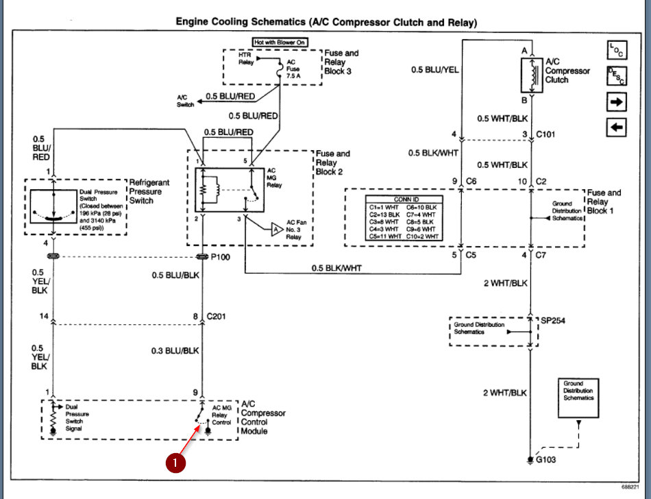

As for the testing that you did on the relay, I suspect you are correct that there is no ground but we need to test it a little differently then you did.
This is not going to have a constant path to ground as the compressor control module controls the compressor by opening the circuit on the ground side. So we call this a low side driver.
Take a look at the wiring diagram below. You are only going to have continuity to ground on that terminal when the control module is closed.
The way to test this is to remove the relay, put your black meter lead on this terminal and then the red meter lead on battery positive. Then turn the engine on and the AC on. Does your meter read battery voltage? If it does then the control module is grounding the circuit. If not, then the control module is the issue.
You are correct that you have .1 volts on the compressor circuit because the relay is not closing.
You need the control module to ground the control side of the relay so that it closes the relay to turn on the compressor.

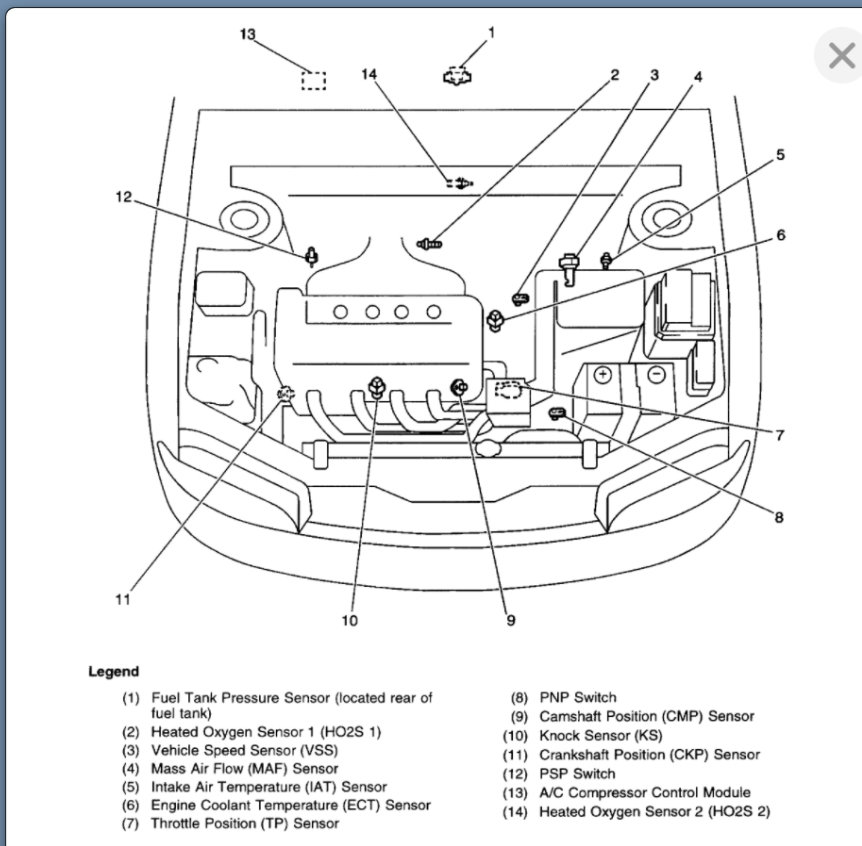

Okay. Sounds good. Yes. A/C control module is what you want. The location is number 13 below.
Let us know how you make out but you may need to seek one in a salvage yard.

As for the relay terminals, can you please confirm that I'm probing the correct points? I found this diagram https://benignblog.com/denso-relay-wiring-circuit-diagram which matches the relay pretty closely. My relay is Denso starting with 156700. I want to be sure that this webpage diagram is showing the pins on the the relay, and not the slots on the relay connector. The slots on the relay connector would be the mirror image, correct?
Jul 2, 2021 at 10:25 PM
That does appear to be correct but when you tested this, was the engine running?
Take a look at this attachment. Let's just confirm this is what you are seeing at the control module.
They are having you test it at the module to determine if the module is functioning so they may be using different logic to control this because I would not expect to see no or little voltage when it is operating. However, that is what they are calling for.
It is the blue and black wire on the module.

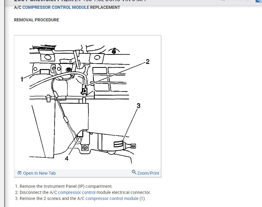

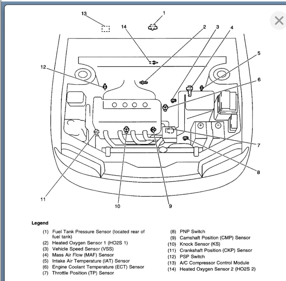

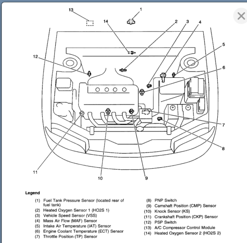

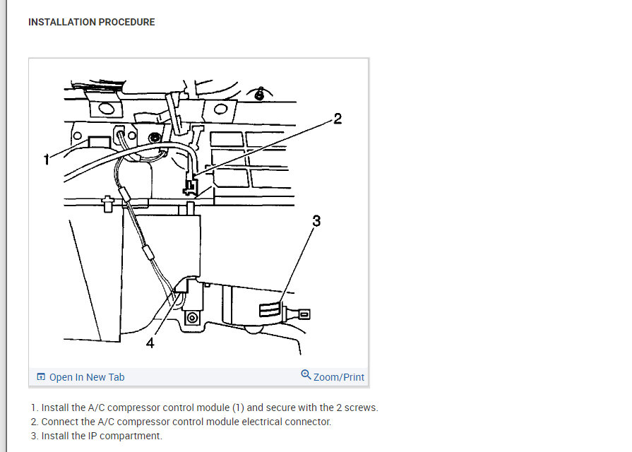

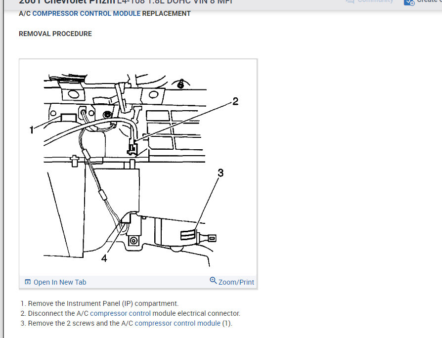

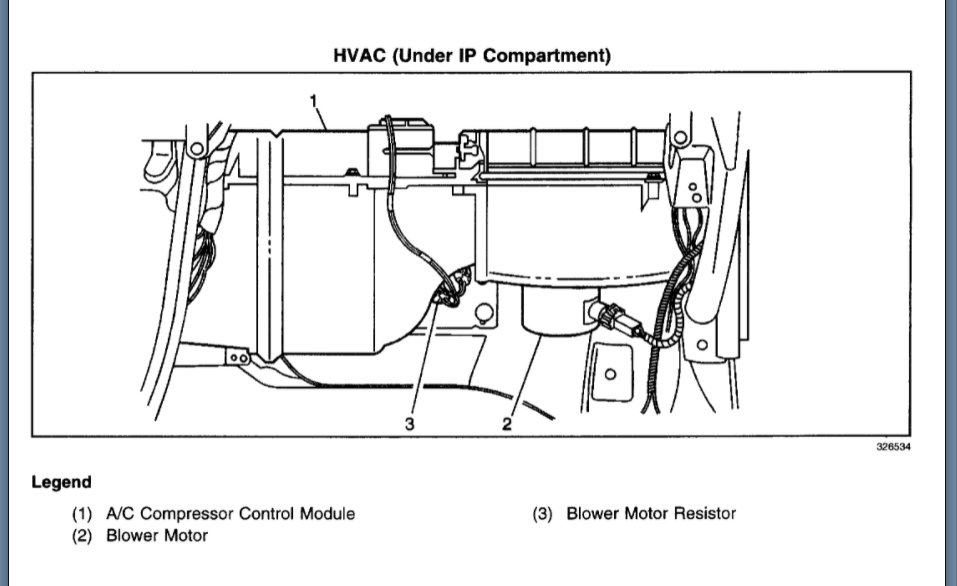

As for getting to the control module, I can't find anything online about accessing it. I see the location of the control module from your diagrams. Do you know if I can access it by just removing the glove box?
Jul 3, 2021 at 11:53 PM

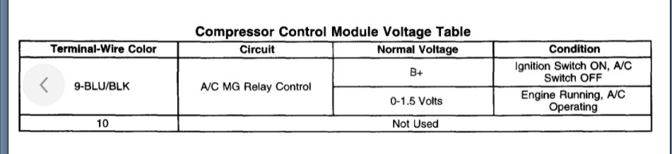

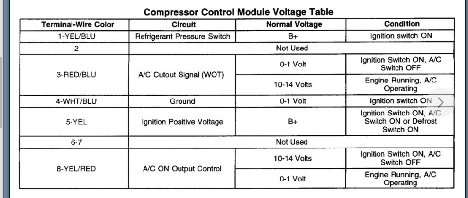

Yes. We need to access the control module and test this as we need to do it with the relay installed. I suspect the control module is the issue but there may be a resistor inside the module that is not sensing the resistor installed and so it is not commanding the relay to close. This is not a traditional simple grounding circuit within the module or you would be getting the opposite voltage when the A/C is off.
If you remove the glove box you should be able to access it. Take a look at the attachment below. You test this by red lead in this blue/black wire and the black lead on ground (pin 4) so you can monitor the voltage.

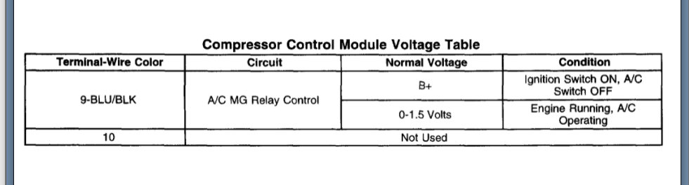

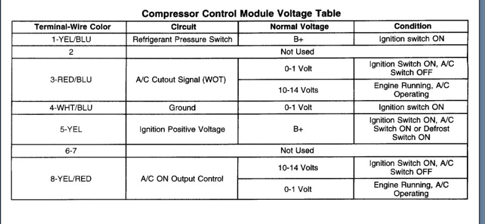

We might as well check each of them. Here are what the expected values for each wire. Let us know what each value is with the system in the condition noted in the last column.

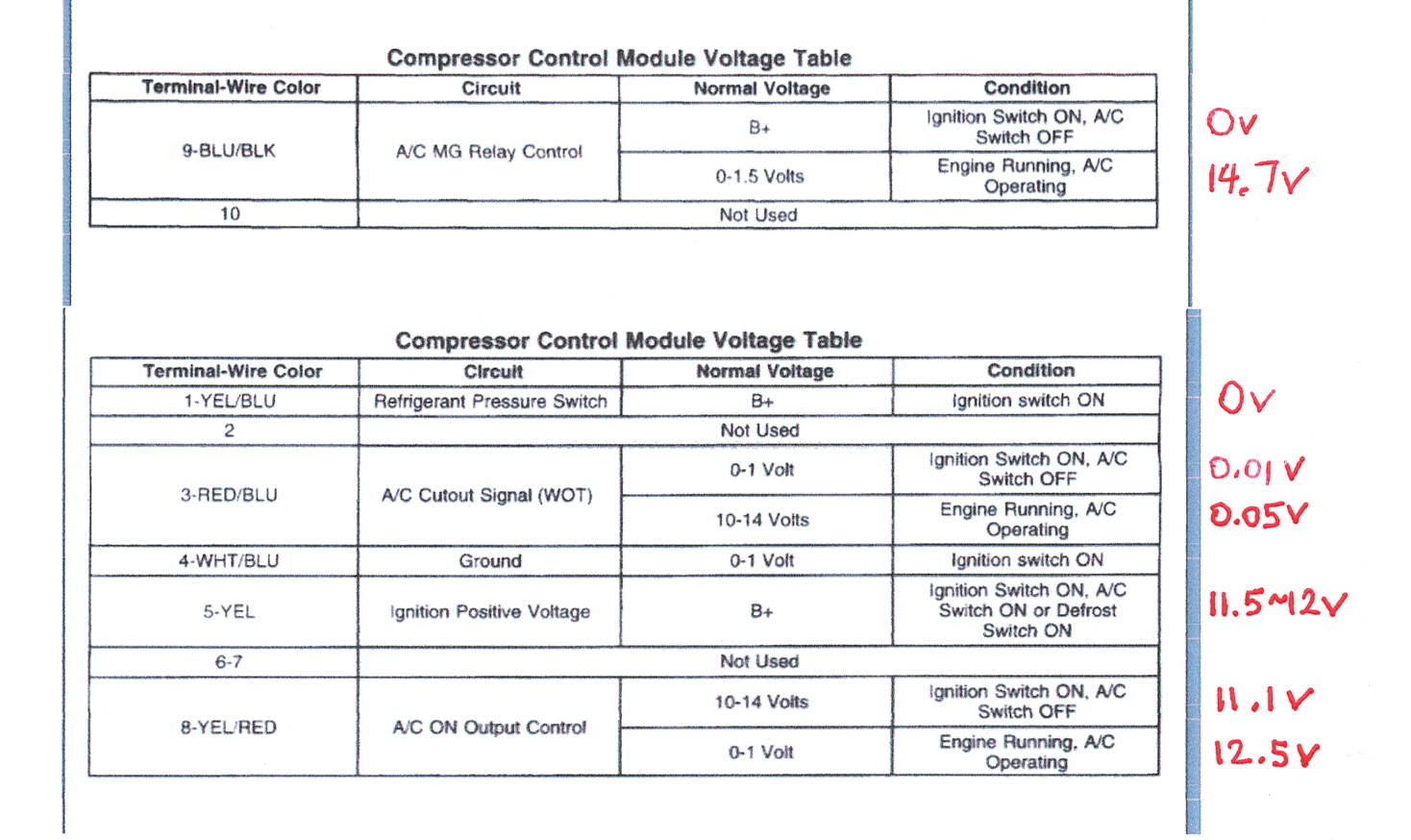

I located the module and checked voltage on all the terminals - see attached for results!
I did what you suggested, black probe touching wire 4 ground, and red probe to each of the other wires one at a time, following the conditions stated.
Terminal 9 Relay Control is definitely off from the normal voltage in both conditions. Of the others, some are reading correct and others are off.
Jul 5, 2021 at 4:23 AM

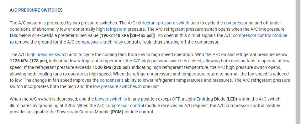

Wait a minute. You have 0 volts on the pressure switch circuit (pin 1). That explains why we are seeing the odd voltage that did not make sense and I assumed there was logic in the module that was using these voltages differently. This should be 12 volts any time the key is on and you have 0 which means the pressure switch is either faulty or the pressures are not accurate.
This also explains why when you put power to the compressor it comes on because you are basically bypassing this sensor.
I would replace the pressure sensor and then check the operation of the compressor again because it appears you already checked the pressures and they are fine. That should set the voltages back to what they should be.

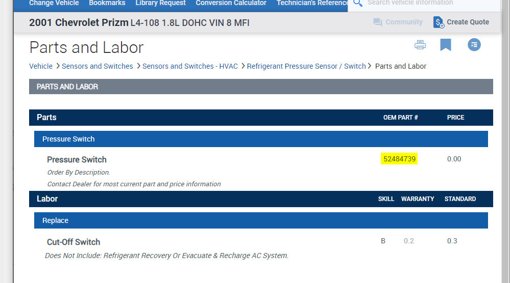

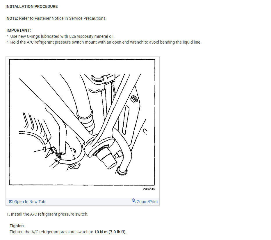

Okay, sounds good! Can you confirm if this is the correct part? https://www.gmpartsbin.com/p/Chevrolet_2001_Prizm-LSi-Sedan-18L-AT/HVAC-Pressure-Switch/48817117/52484739.html
Jul 7, 2021 at 1:13 AM
Sorry for the delay. That looks like it.
I attached the OEM part number below from the manual just for reference but it is the same number so you are good to go.

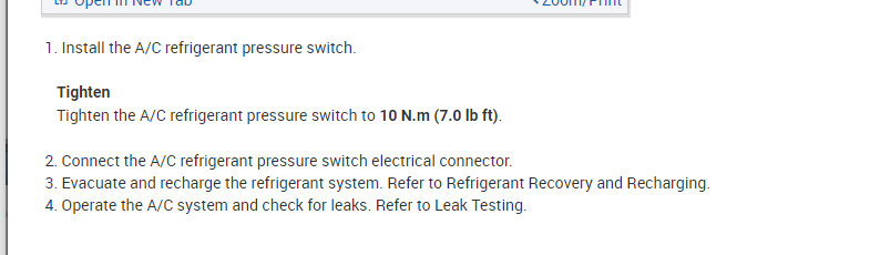

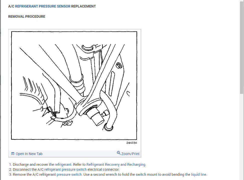

I don't think I can discharge and recover the refrigerant in the system without special equipment. So I asked a local mechanic about doing the service. I can get the part and bring it in. But he said I can try jumping the pressure switch to see if the switch is bad. Does this make sense?
Jul 9, 2021 at 10:44 AM

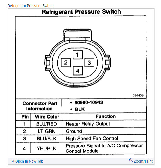

I thought about that earlier but this is a dual pressure switch which means it shuts down when pressure is high or low. They are normally 3 wire sensors which means it sends a signal to the control module. However, looking at this again that is not the case on this vehicle.
Your pressure switch is an on off switch so you can jump it. Basically it looks for 12 volts or 0 volts. So just disconnect it and put a wire between the two terminals and then turn the ignition and A/C on. It should come on. This confirms the sensor is the issue.

I removed the pressure sensor connector and jumped it, but the compressor clutch did not start spinning, so no luck. But I see there are 4 terminals on this connector, in a diamond type pattern. Blue/red and yellow/black are opposite from each other, these are the terminals I jumped. The other two look like blue/black and green.
Just to confirm I did the right thing, I jumped the points on the connector, not on the switch itself.
Then I checked for voltage on the connector. Blue/red has 14v (I probed blue/red and battery -). Yellow/black I assume is ground. But when I probe yellow/black and battery + I get no voltage reading.

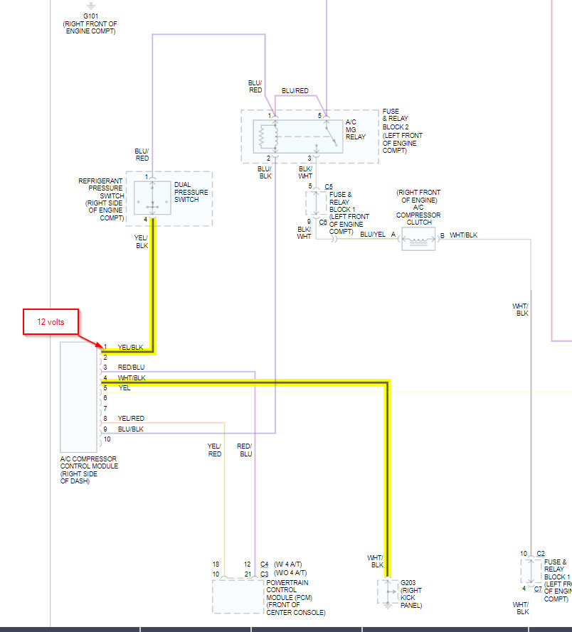

That is correct. Basically they are using this switch to control the fan speed as well to keep the engine cool and air flow over the condenser.

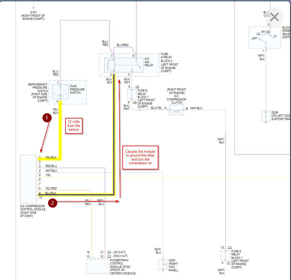

This is progress. This is showing that the module is not grounding this circuit.

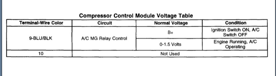

Here is what you should have: At the control module, it needs to see 12 volts on pin 1. This shows that the pressure is correct and it is ok to turn the compressor on.
Then the control module will ground the relay on pin 9 and you will see 0-1.5 volts at the control module on this wire. You have battery voltage which shows it is not grounding the circuit.
You have 0 volts on pin 1 so it is cutting the compressor off which is why the two wires going to the PCM are not reading the correct voltage either because this is the AC module telling the PCM that the compressor is off.
If jumping that switch does not cause the compressor to come on then we are back to the control module.
What I would do from here is just make sure you don't have a wiring issue from the switch to the module by jumping the switch again and then check voltage at the module on this wire, Pin 1. You should have the same voltage that you do at the switch. If you do then the module is the issue.
Another way to confirm this is to just leave everything connected and jump 12 volts from the battery directly to Pin 1 of the module. If the compressor comes on then it is not getting 12 volts and you have a wiring issue.
Take a look at this below. Please let me know if you have other questions and what you find. Thanks

I completed both the tests you suggested, and i think it's looking like it's a bad control module. Please confirm. This is what I just did:
I jumped the pressure switch, then with the engine running and the AC/blower on, I checked voltage at pin 1 of the control module. I read 14v, same voltage present at pin 1 of the switch (I did this by probing with my meter on the control module, red to pin 1 and black to pin 4 ground). So I assume this confirms the wiring between the pressure switch to pin 1 of the control module is good.
Then I reconnected the pressure switch connector, and jumped 12v directly from battery + to control module pin 1. With the engine running and AC/blower on, the compressor clutch did not come on - still no A/C.

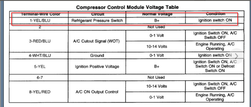

That is excellent. You are exactly correct. If you look at the chart and wiring diagram below.
You need 12 volts at pin one in order for the module to know that the pressure is ok. If you jumped the switch and then checked voltage at the module using the modules ground and you have 12 volts on your meter then you verified the entire circuit.
If the module has 12 volts on pin 1 and it still does not come on then the module would be the issue.
However, you appear to have an issue with the switch as well.
The jumping of the switch is a clear and simple test. If you have to jump the switch in order to get 12 volts to the module then the switch has failed.
If it were me, I would replace the module and then jump the switch again which should cause the compressor to come on. If it does, replace the switch. However, if you want to put the switch on it now, I would understand because this is a simple on off switch based on pressure. So either it is closed or open based on the pressure and if the pressure is correct and it still is open then it is faulty.
