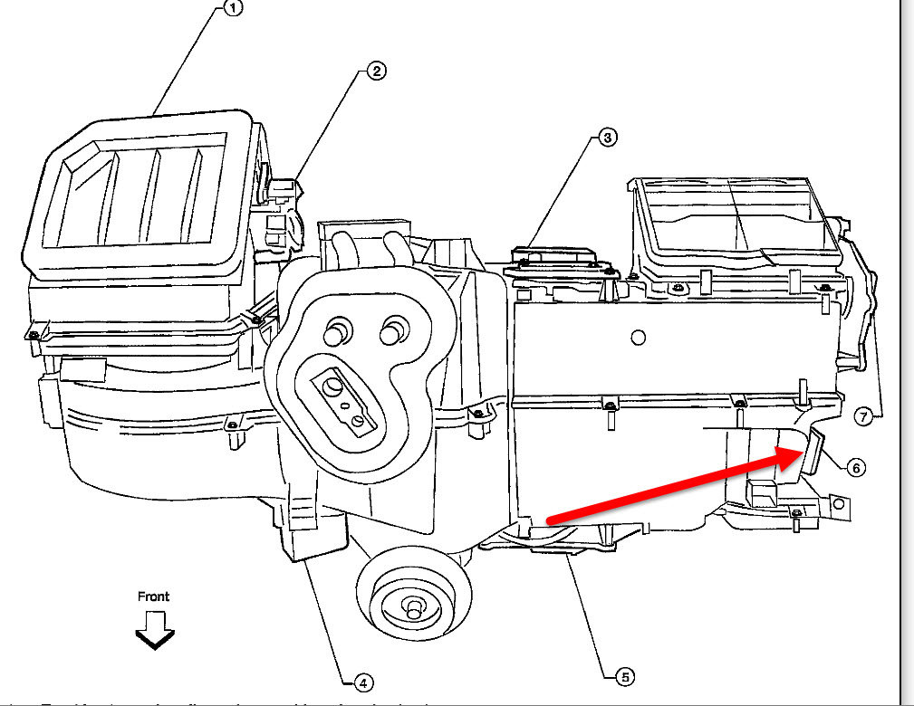

turn key on and try pulling HVAC fuse to re-calibrate for sixty seconds then reinstall that may fix it. See picture for mode actuator.

When i put back the fuse car should be in the on position as well am i correct? Also at the passenger side below the cabin filter a little to the left is that the actuator that controls the air flow i saw it in YouTube that would be easy to do but also there is one inside the top dashboard?
Jun 1, 2017 at 12:05 AM
HMAC300
  • 48,601 POSTS
yes key on if you look in picture there is a white arrow pointing to front this means it will be on driver's side above gas pedal.

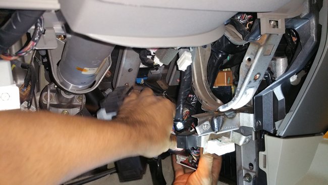

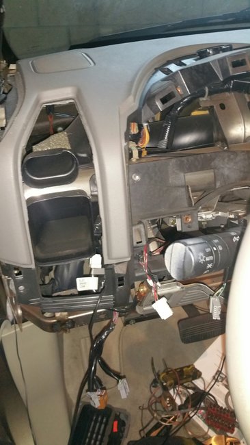

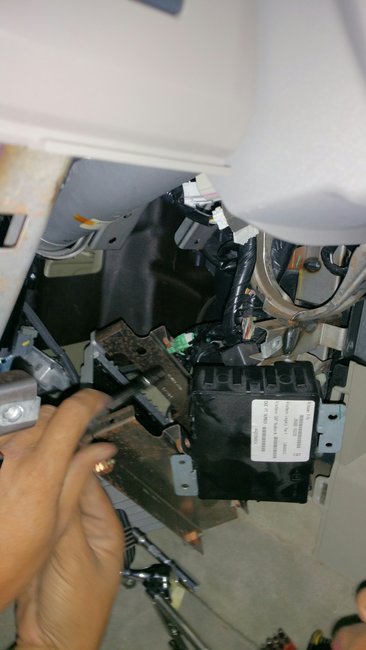

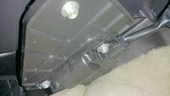

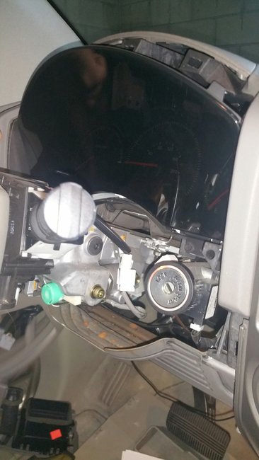

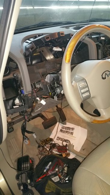

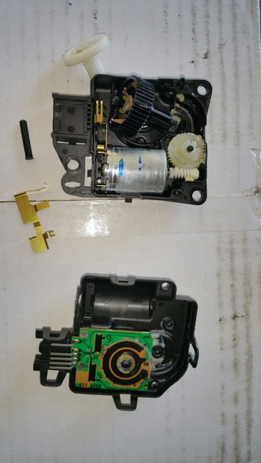

i did end up fixing it it was the actuator on the driver side beneath the dash it controls the air flow vents in the front but i did made a wrong assessment at first i did replace the one inside the dash beneath the gps screen which is a pain in the butt. I guess taking out the fuse didnt do anything on my truck that approach is for GMC vehicles only as per the youtube video
Jun 15, 2017 at 11:59 PM
AN2NY0830
  • 13 POSTS
This is how i fix it
Jun 16, 2017 at 12:04 AM
