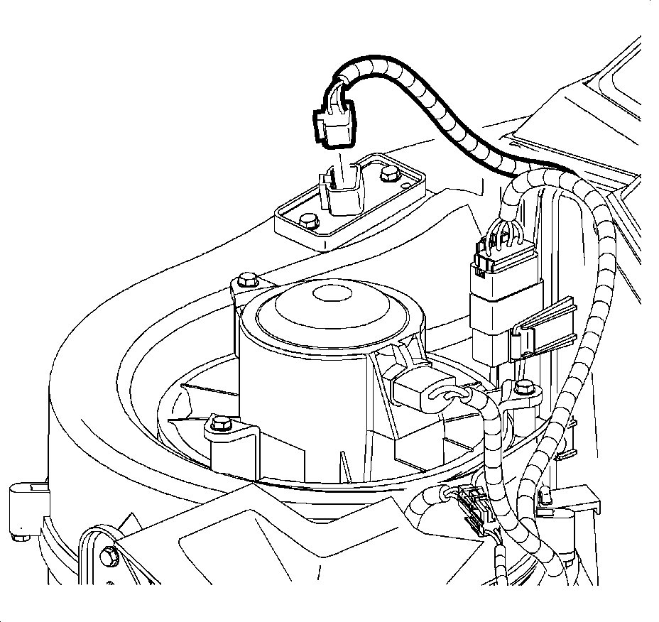

Okay. When you said in and out, I suspected it was the compressor. Does the blower motor work on any speed?

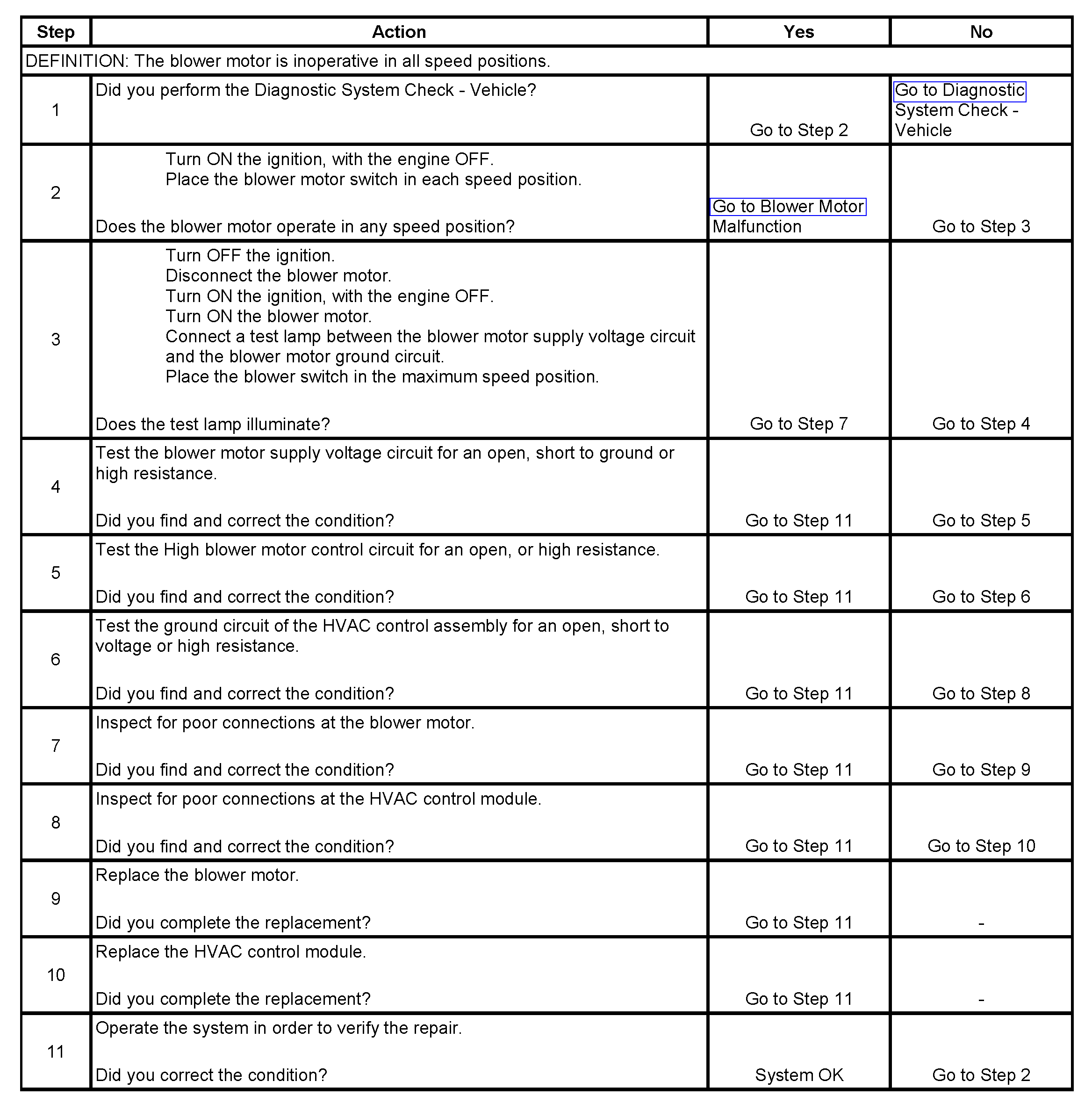

I really don't know what all was checked, so bear with me. The first picture I added below is a flow chart to inspect everything with the blower motor being inoperative. That is the last thing I need you to follow.

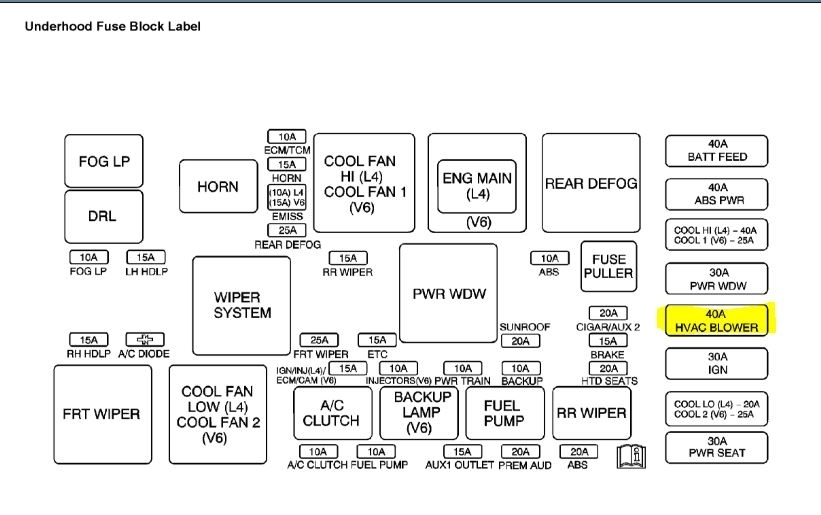

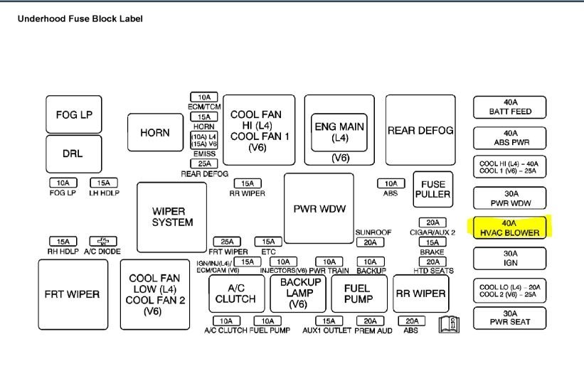

First, there is a 40 amp fuse in the under hood fuse box that needs checked. See picture 2.

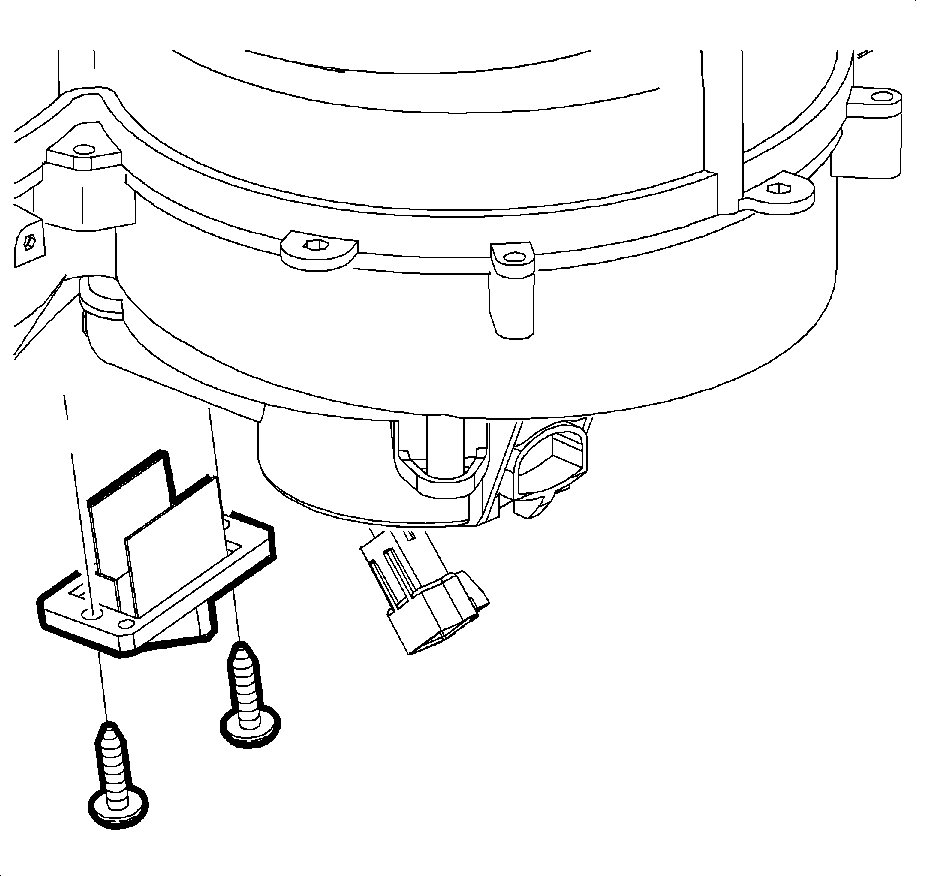

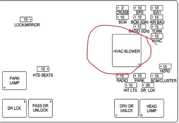

Next, have you checked the fan relay? See picture 3. It's the fuse/relay panel in the vehicle.
If you checked those things, there is power to them and they are good, then you have to follow the flow chart in picture 1.
Here are a few links to help with testing electrical components:
If the blower motor works on high only, suspect a bad blower motor resister. Here are the directions for replacement:
