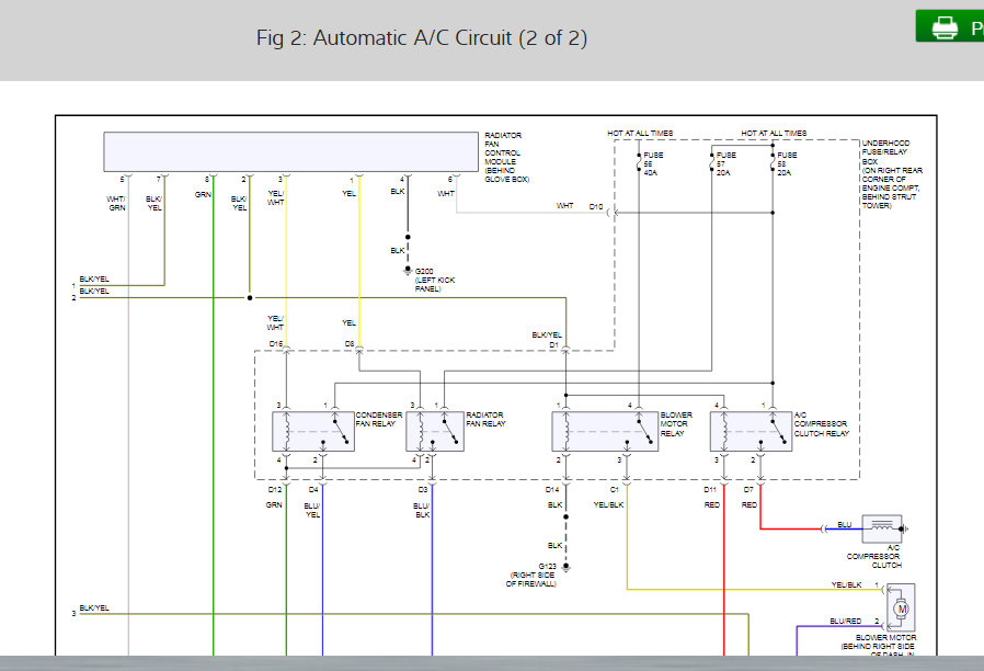

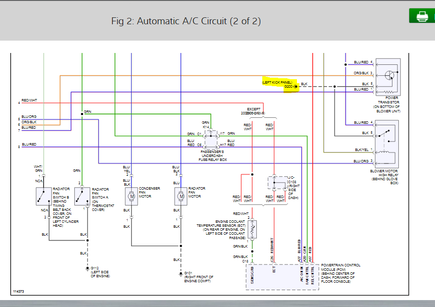

air goes off and on. comes on sometimes when I hit the dash. air popped on once about a month ago and again last week and have not been back on since. what could be the problem?
Jul 23, 2019 at 1:07 AM
SCGRANTURISMO
  • 4,897 POSTS

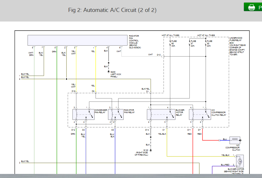

This could be a problem with your vehicle's Ground #200, which is located at your vehicle's left kick panel. Please check this ground and make sure that it is clean, corrosion free, tight, and making good metal to metal contact. Get back to us with what you are able to find out, please. I have included a wiring diagram of your vehicle's Heating Ventilation and Air Conditioning (HVAC) circuit in the diagrams down below for you as well.
