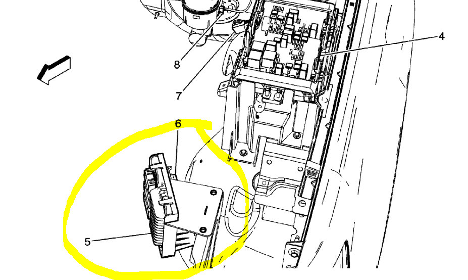

One day i get in the SUV and it throws an engine light. Misfire. Got spark plug and it goes away . Then next day i get in my vehicle i have absolutely no acceleration from pedal. Tested pedal, pedal is good. has a code po641. 5 volts circuit, 5 volts reference circuit. What is all on the circuit that could be causing this? Need ideas asap.

Good morning,
The 300 misfire code, be sure you test the fuel pressure. That is the most common failure for this issue.
A failing pump will give you those symptoms.
The 641 code, indicates a failed PCM. It has an internal failure for the 5 volt reference circuit.
P0641
Descriptor
Probable Causes
Engine Control Module (ECM)
Get these checked but it looks like the PCM is your issue.
Procedure
ENGINE CONTROL MODULE REPLACEMENT
Service of the engine control module (ECM) should consist of either replacement of the ECM or programming of the electrically erasable programmable read only memory (EEPROM). If the diagnostic procedures call for the ECM to be replaced, the replacement ECM should be checked to ensure that the correct part is being used. If the correct part is being used, remove the faulty ECM and install the new service ECM.

Removal Procedure
1. Using a scan tool, retrieve the percentage of remaining engine oil. Record the remaining engine oil life.
2. Disconnect the negative battery cable.
3. Disengage the engine wiring harness upper electrical connector retainer (2) and remove the connector (1) from the ECM.
4. Disengage the engine wiring harness lower electrical connector retainer (3) and remove the connector (4) from the ECM.
5. Disengage the retainer tabs securing the ECM to the bracket.
6. Remove the ECM.
