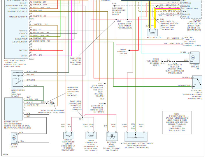

Last issue - A/C will not turn on including with control set to max A/C. Clutch never engages. There is 35-40PSI in the system low side at 70 degrees ambient temperature. Self-test on control head passed, no fault codes. I cannot access the clutch coil connector from above or below without moving a bunch of A/C plumbing. So cannot energize directly to test. Compressor turns just fine by hand with engine off. I also have an OBDII+ Bluetooth scanner which shows A/C press switch at around 0.25V. States of clutch, cycling sw, med pressure sw, and driver request all show 0 when Max AC selected. Hypothesis: mechanics ok. Prob is in the control system. Cannot locate VLCM which controls clutch if I wanted to try energizing clutch from there. I must be blind. Wiring diagram shows VLCM in "front lower center of engine compartment" as last stop before clutch energizing on purple wire. What do you suggest for the next step? Thx.

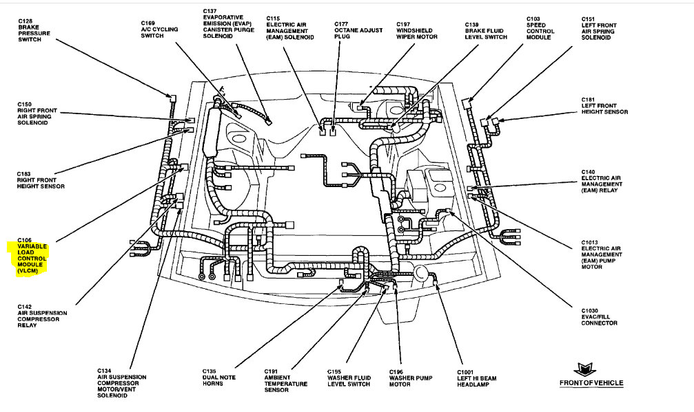

The VLCM is on the right side of the engine compartment. See pic 3 below. Is that where you are looking? I ask because often people are looking toward the front near the radiator.

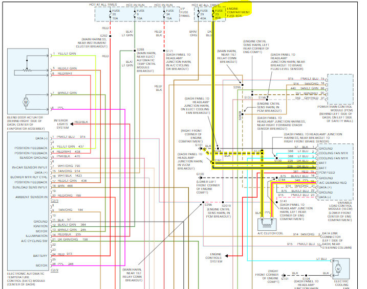

Also, I attached the wiring schematic. I'm not sure if you have it or not. Is the fuse indicated and highlighted good? It should have power at all times.

Thank you for the suggestion on the VLCM location. I will check that today or tomorrow. Yes, I do have the diagram, thank you. Naturally I was looking where the diagram says it is as every other location checks out. But I also had several Mercury Grand Marquis in the past and the air suspension compressor is hidden right there (or opposite on the driver's side) as well if I recall correctly (and as your other diagram clearly shows).
I have checked the 40W #23 fuse and replaced it with its neighbor to be safe. Checked out fine. Will double check for power again and report back as I may only have checked continuity. Thanks.

Thank you for the update. It is a good idea to confirm there is power to and from the fuse, so let me know what you find.
