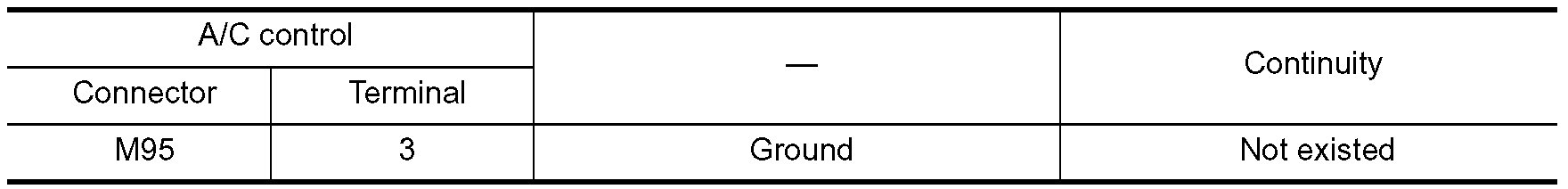

3. Check continuity between A/C control harness connector and ground.
pic 2

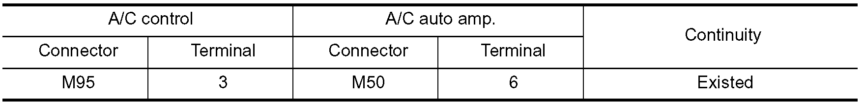

2. Check continuity between A/C control harness connector and A/C auto amp. harness connector.
pic 3

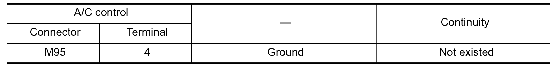

pic 4

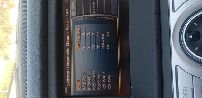

I pull up the diagnostic on the in dash screen and it won't let me select the HVAC option. It's there, however, I click on it nothing happens. I did run the CAN system test and got this. see pic below.
Possible relay? The panel itself? I read it could be the IPDM. Really at a stand still and the cold weather is coming in.

Based on what I'm seeing, it sounds like a wiring issue. If you look at the directions I attached above, go down to number 3. Is that something you feel comfortable doing?
