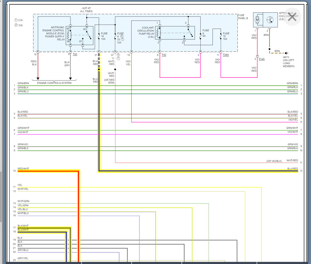

My car listed above (VR6 4Motion) is not getting any power to part of the fuse box on the driver's side beneath the steering wheel. My A/C is getting no power, I know that it's not the blower or anything because when I "bench test" the fuse box (took insulated copper wire and "powered" the fuse) it was working. What am I missing?

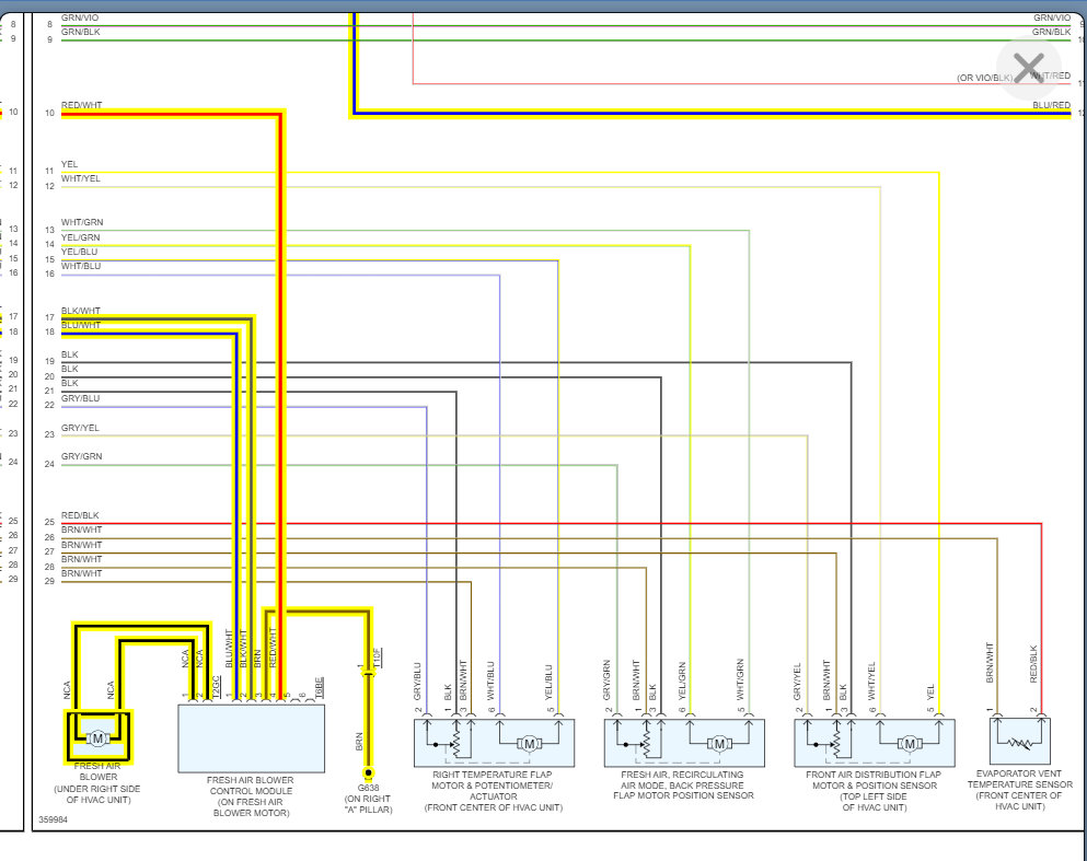

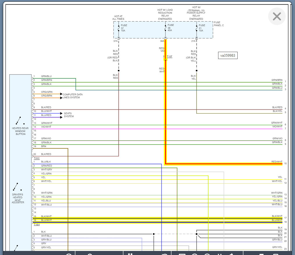

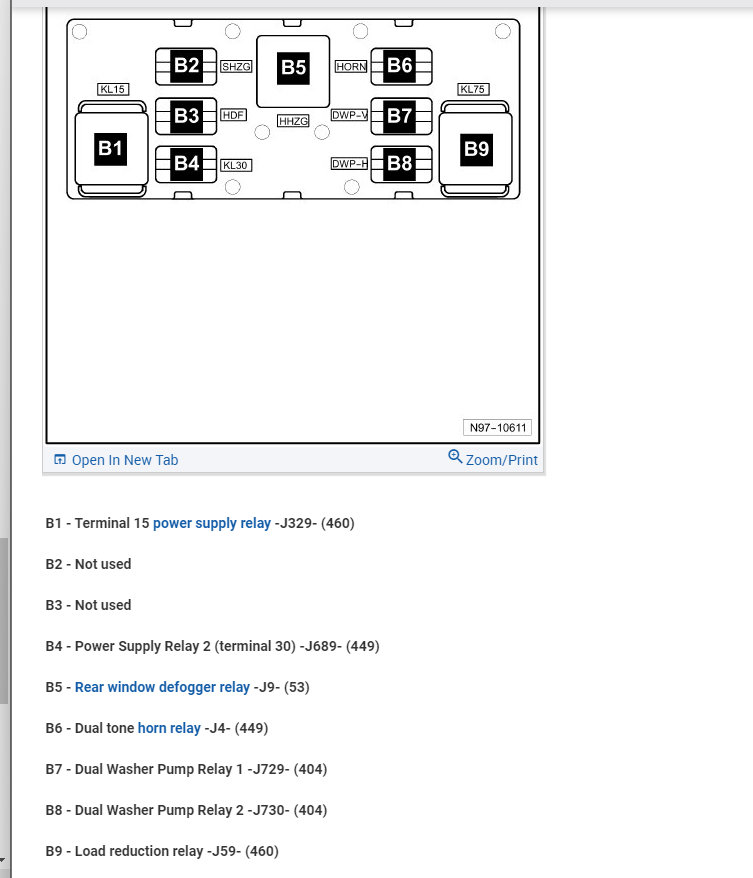

The fuse that is not getting power is the fuse that is supposed to turn my motor blower on/off just that one, fuse #38 on the schematic. With external power applied to the fuse the blower works. I'm thinking maybe a relay. I'm just not sure which one.

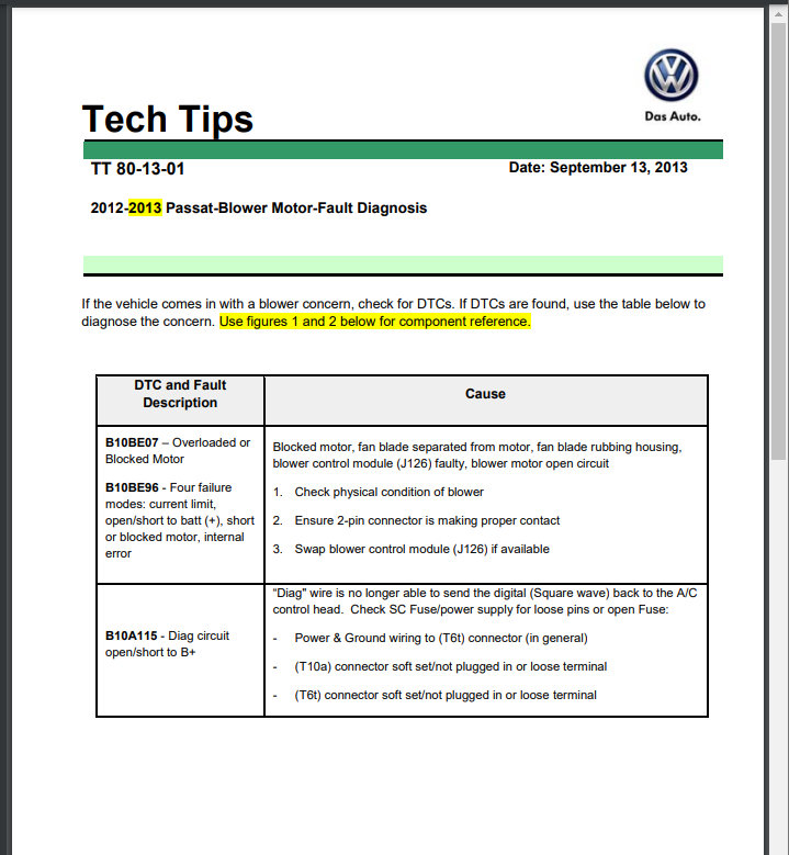

I scanned the HVAC system and there was a code: B10A115. However, I just replaced the blower and resistor, so I'm confused on why it's calling that out.

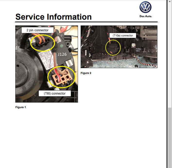

That is great. There is actually a tech tip from VW that will help point us in the right direction and will explain this.
As for not getting power to the fuse, I suspect that is normal due to this issue or an issue with the load reduction relay.
If you look at the wiring diagram you will see that this fuse is only hot when the relay is energized.
So, let's check these connections and make sure we don't have an issue with an open circuit and if you don't then we need to go to this relay and check its operation.
I attached the info below for your review.
