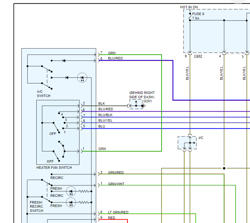

So I'm not sure how to go about testing my fans to see if they function or test the relays. I'm trying to troubleshoot but don't know where to start. also when I bought the car it has a switch they said was for the A/C so that might also be the cause. any suggestions or help will be greatly greatly appreciated. thanks in advance.

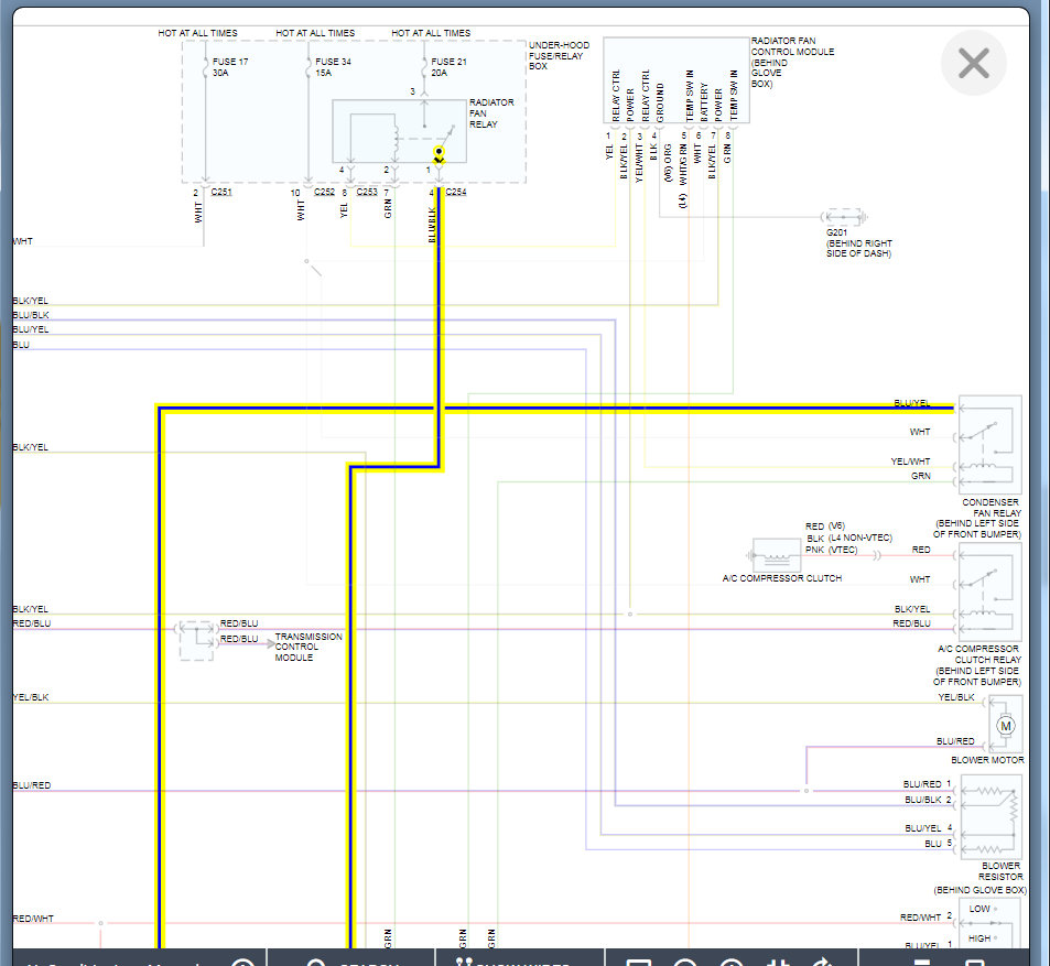

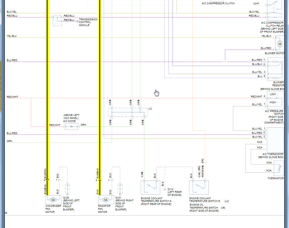

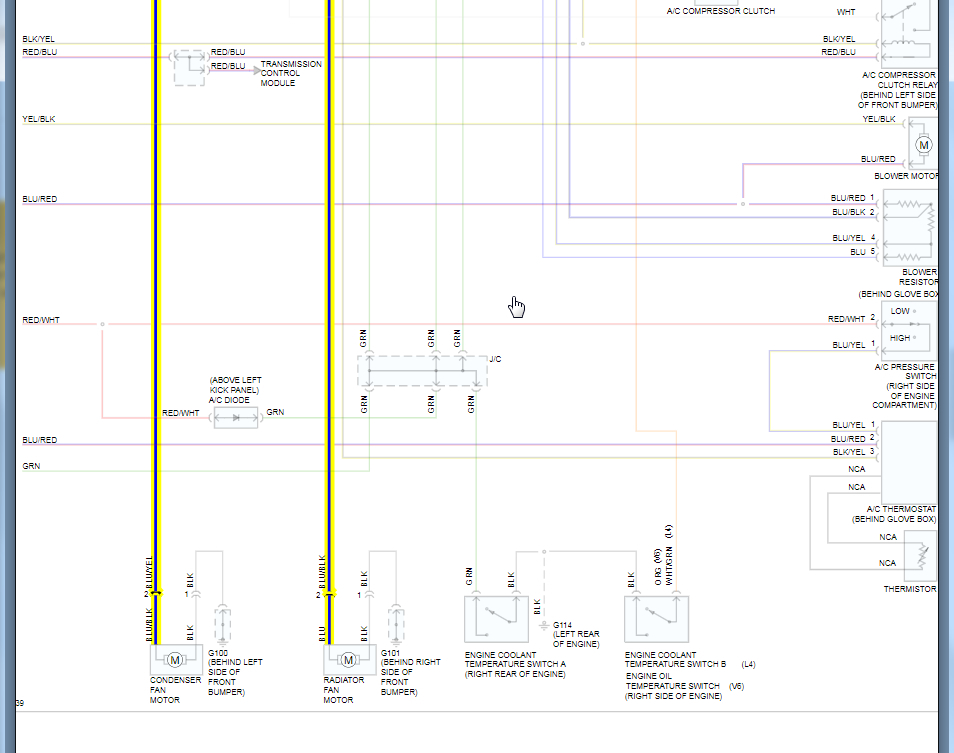

Just to be clear, you said the A/C was not working in the heading but you are looking for in on the two cooling fans?
If the fans are not working then we need to check for power at them and make sure it is not a fan issue. If you are getting power then the fan motor has failed.
https://www.2carpros.com/articles/how-an-electric-cooling-fan-works
However, if both fans are not working then we most likely don't have a motor issue as they are separate fans.

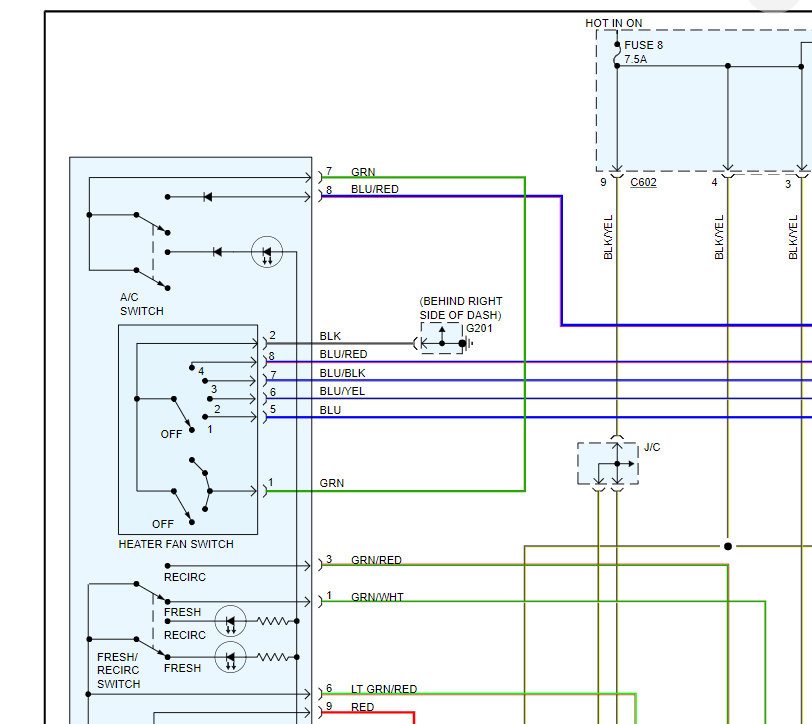

If that is the case then we need to go back to the relays and check for power coming from the radiator fan control module. I suspect this is going to be the issue as it controls both fans through two different relays.
Please review this wiring diagram below for more info on this. Please let us know what you find on this and we can go from there. Thanks

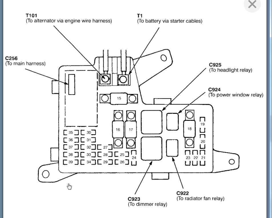

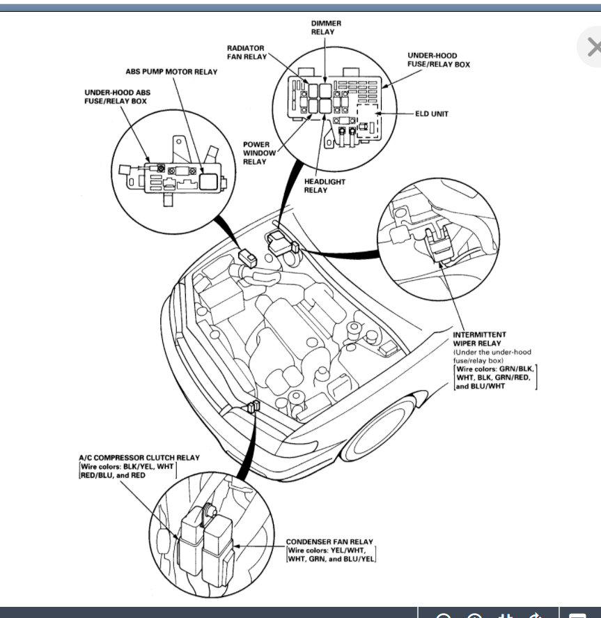

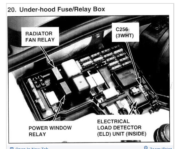

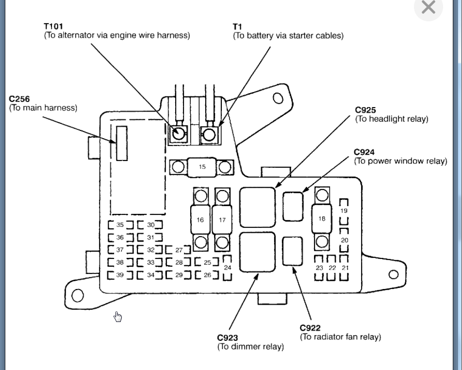

Sorry half my post got erased on accident I didn't notice.... Anyhow neither of the fans are running from the looks of it so I'll go and test the relays which are the two up by the driver side headlight, correct?
Jun 7, 2021 at 2:16 PM
That is correct for the condenser fan relay. However, the radiator fan relay is in the underhood fuse block.
You have a relay for each fan so I attached the info below. Please let us know what you find. Thanks

So here is what I'm thinking. remember that switch I was talking about I believe it was to turn the A/C off and on, but I'm not sure how they had it wired. so when I push the A/C button there's no signal being sent because that switch isn't connected properly. if that makes any sense at all I can take a pic and send it shortly.
Jun 20, 2021 at 5:20 AM
Is this switch a separate switch that they just wired in rather then using the switch on the control panel?
A picture would help just to be sure I understand.
However, you on off switch for the control panel are green and then blue and red.
Let us know if you can get a picture and we can go from there. Thanks

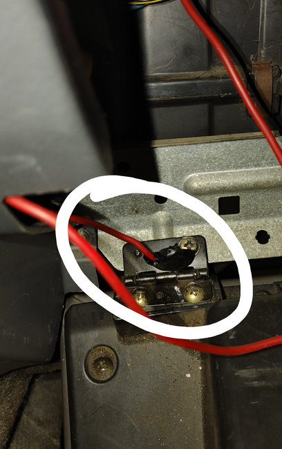

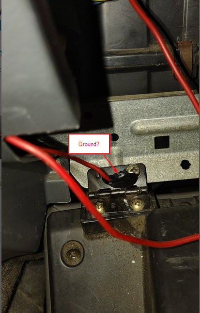

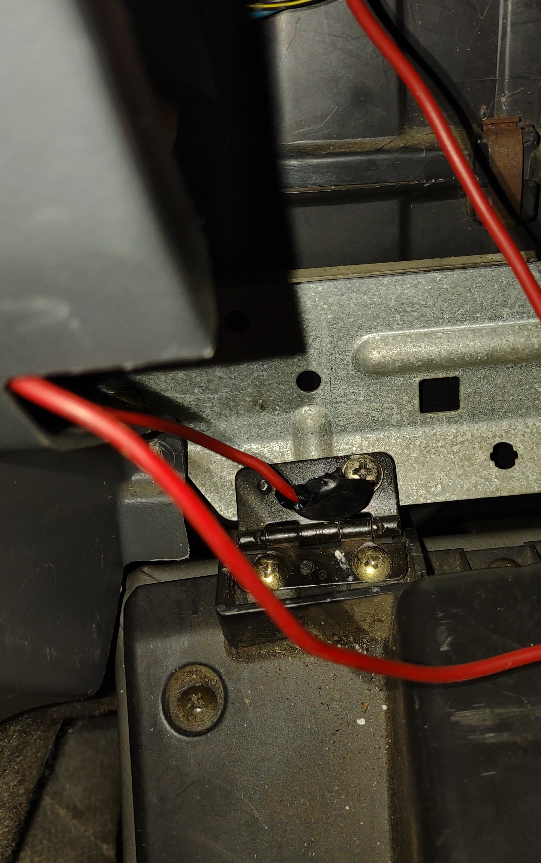

I have a ground going to the compressor but no voltage for some reason due to the butchered wiring.
any suggestions?
Jun 21, 2021 at 12:27 PM
Holy cow. That is not good wiring. Do you know what this wiring goes to? Plus is that a ground in the picture below?
If it were me, I would just trace all this wiring and remove it once you know what it goes to.
Even if this is wiring that goes to the compressor, I would redo it properly. Let us know what this goes to and we can go from there. However, once it is removed, I would jump 12 volts to the compressor and see if it comes on.

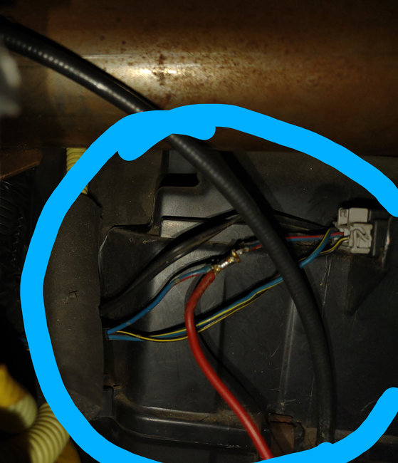

From the looks of it the switch is spliced off the blue/red wire that connects to the evaporator behind the glove box which I believe is the thermostat connector. hopefully I'm making sense that's as far as I got today sorry.
Jun 23, 2021 at 1:51 PM
It does make sense but I am not sure why they are splicing into that so keep the updates coming because I am sure at some point it will become clear.

Sorry for the delay so there was a break in a wire going to the A/C switch that in turn kicks the compressor on fixed that and runs great now nice and cool, except for some reason every now and then I'll get cold air everywhere except the driver side vent not sure but at least it's working for the most part. thanks again for your time and knowledge very appreciative.
Jul 10, 2021 at 4:02 AM
That is great info. Thanks again. I am sure that will help others in the future.
