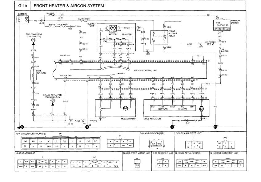

I have checked all relays and compressor and hi and low
cut outs. I have power into A/C control head at pin 1r.
I just need to know what pin is output at the control head? Also,
the lights come on when A/C button is pushed as does the recirculate.

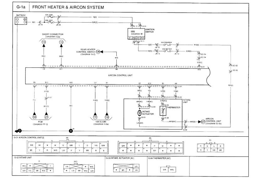

Good morning.
I attached wiring diagrams for you to view of the control head.
Did you verify voltages to the pressure switches?

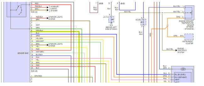

Howdy the answer is great, thank you. However, the schematic is blurry and we use
Prodemand as our diagnostics believe if I can find out what pin connector is the output
I can tell if it is the control head or PCM. Note: even the scanner does not show a/c on when
button pushed but light comes on on dash.
Wednesday, June 27th, 2018 AT 11:33 AM

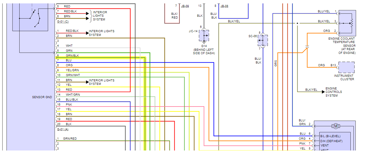

  • 52,797 POSTS
Pin 6 on the control head. I highlighted it in yellow.
That is for the control side of the AC clutch relay.
