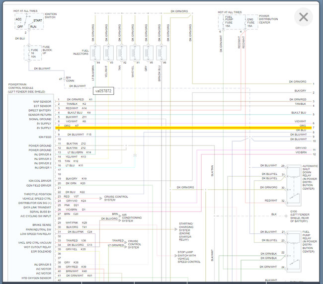

No spark condition.

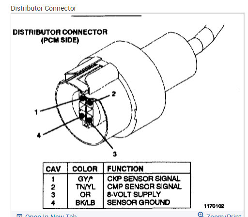

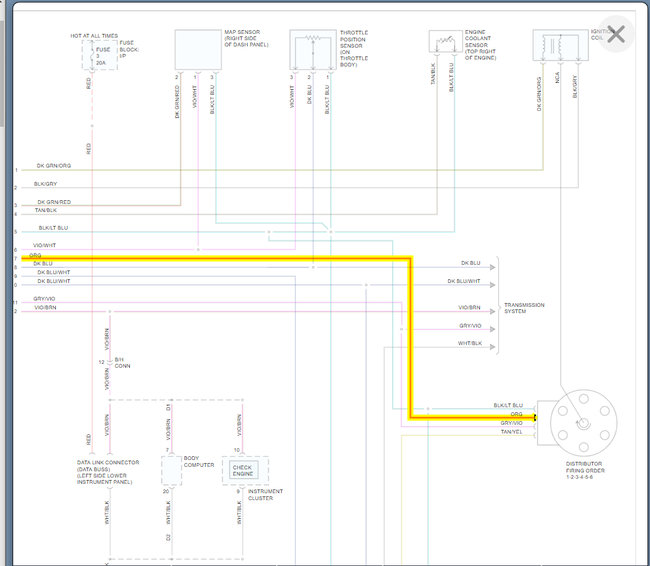

8v orange wire from PCM to distributor (not present with key on)
Check all fuses and substituted ASD relay= okay
Voltage and grounds on PCM harness side= okay

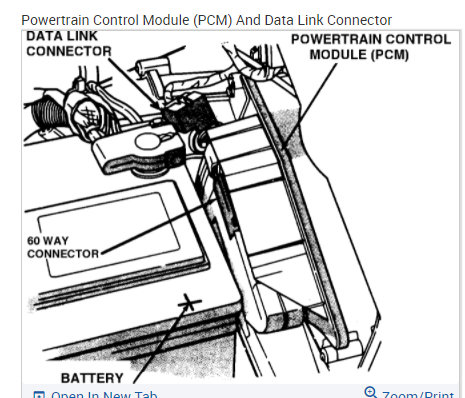

How to test the PCM to be sure it has failed?
No OBD port.
Multimeter (fluke 88v).
Sep 23, 2021 at 8:34 AM
You did it. The way to test supply voltage is to unhook the connector at the component and check for voltage on that pin to a known good ground.
So when you are not getting no voltage with this key on then that control module is not sending it and has failed.
This applies to any supply voltage including a 5 volt supply.
Sounds like the driver in the module has failed and needs replaced. The ASD and other relays would not effect this as the PCM controls these relays through the ground side but would not effect the supply voltage.
Take a look at the info below but sounds like you don't need it. In case others in the future this includes the wiring diagram on the wire you are referring to.
Please let us know what questions you have. Thanks

Thanks, I needed to be sure that I have to replace the PCM.
Sep 23, 2021 at 12:29 PM
Yep. Clearly I am not looking at the vehicle but if it were me, I would be ordering a PCM for it as well.

After a long waiting, finally the PCM arrived. The car started right up.
Thanks!!!!
Oct 5, 2021 at 11:47 AM
That is great. Thanks for returning and letting us know that this was the issue.
