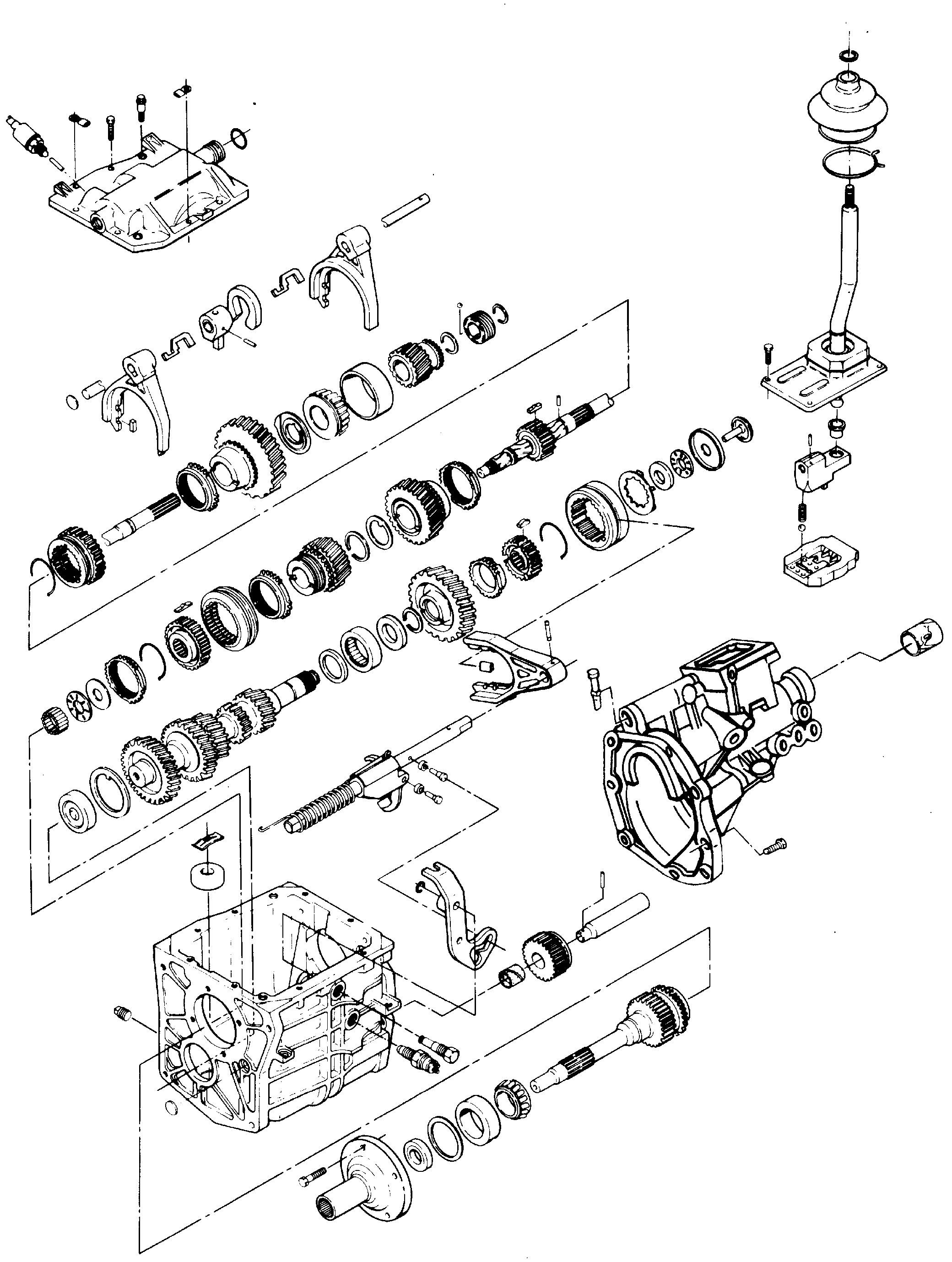

While driving in fifth gear transmission lost engagement like it had shifted into neutral
320,000,000 MILES • 2.8L • 6 CYL • 2WD • MANUAL
BLAZ85
  • 54 POSTS
The vehicle listed above is a semi-restored Blazer, with a NWC T-5 transmission. While cruising at about 45 MPH in fifth gear, all of a sudden the transmission lost all engagement just like it had been shifted into neutral. I downshifted to fourth gear and continued. First gear through fourth gear and also reverse work perfectly. At the time of disengagement, there was no sound, no clunk, no vibration or any other thing unusual. The shifter easily goes into fifth both with engine off or running, but in reality it remains in neutral. Prior to this, the transmission shifted flawlessly in all gears. What is your opinion as to what happened causing the sudden disengagement? Others suggest that a retaining clip came off allowing fifth gear to move out of position or the fifth gear shift fork insets failed. One way or another, the transmission has got to be disassembled.
Thanks in advance for your response.
May 28, 2020 at 2:22 AM
  • 110,248 POSTS
Either of the suggestions can cause the failure, but I honestly feel if the shift fork inserts failed, you would have heard it bang out of gear.
When driving it now, is there anything (other than 5th gear) out of the ordinary? When you shift into 5th, does it feel the same as before?
Let me know. By the way, here are the directions for disassembly and assembly. It has to come apart. I suspect a C-clip has failed and fifth can't engage. Also, if the shift fork inserts have come out, you would have lost more than one gear. The attached pics correlate with the directions.

1985 Chevy Truck S10/T10 P/U 2WD V6-173 2.8L
Warner T-5 (77MM) 5 Speed
Vehicle Transmission and Drivetrain Manual Transmission/Transaxle Service and Repair Procedures Overhaul Disassemble Warner T-5 (77MM) 5 Speed
WARNER T-5 (77MM) 5 SPEED
pic 1
