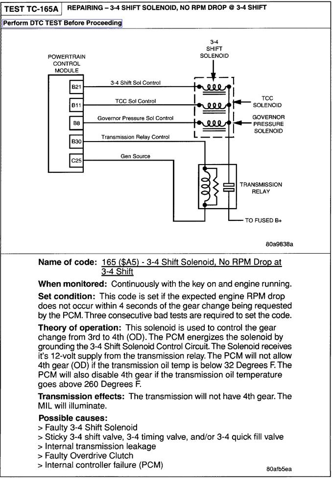

P1391: Loss of Cam or crank and P0783: 3-4 Shift solenoid malfunction. A couple weeks ago it would stall shifting from second to third, go to higher rpm's before hitting third, then would dump into fourth. Now the the day after I pull codes it now shifts fine 1, 2, 3 then no fourth. At about 2800-3000 rpm's at 60.

Hi Mike,
Thanks for visiting us here. Let me start by asking about the first code you mentioned. Was that a typo? Did you mean a P1391?

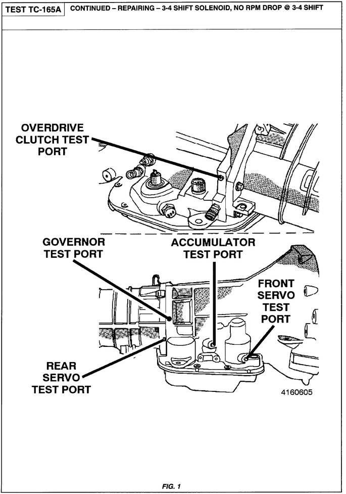

Second, regarding the P0783. Please take a look at the diagrams below.
Also let me know about the first code in your post.

And what are you suggesting I do with those pictures, seems like I need to preform a TC-50A test? Confused on the information you provided.
