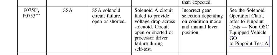

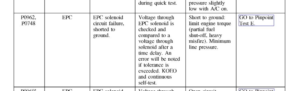

Got a shift solenoid code replaced it and it bangs in third and goes slow. what could be the issue?
Jun 2, 2019 at 10:15 AM
What was the code number?
Jun 2, 2019 at 3:23 PM
NOT PERFECT
  • 16 POSTS
P0748 and p0750.
Jun 3, 2019 at 12:08 AM
Got it.
These codes are electrical codes related to the wiring harness inside the transmission.
You need a scan tool that can monitor the actions of the solenoids and switches.
Jun 3, 2019 at 5:50 AM
NOT PERFECT
  • 16 POSTS
After i replaced shift solenoids and had the codes read again turns out now all i have is a speed sensor code. thank you for all the help. hope this is all.
