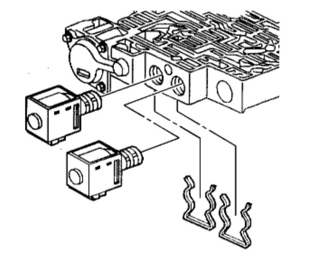

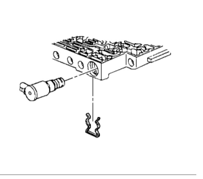

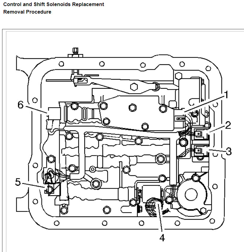

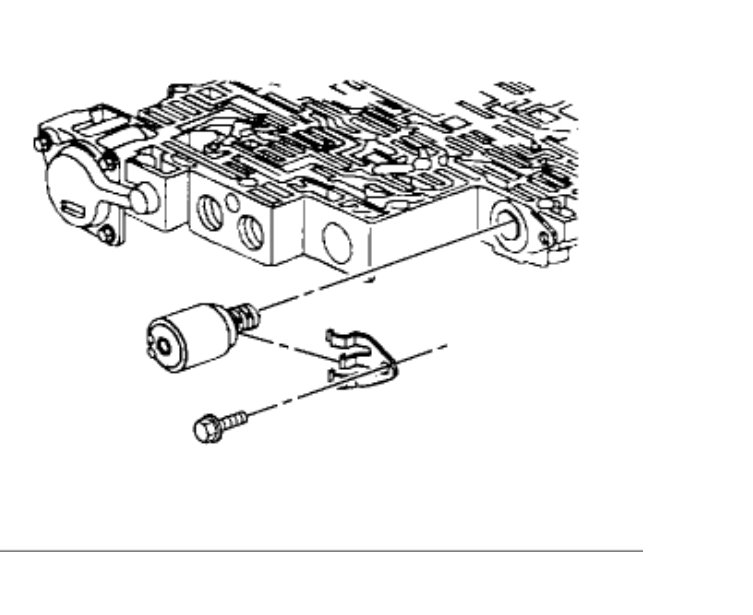

It sounds like you have a problem with the second to third shift solenoid. Here is a guide to help you remove the transmission pan so you can do the job:

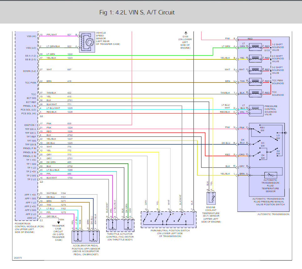

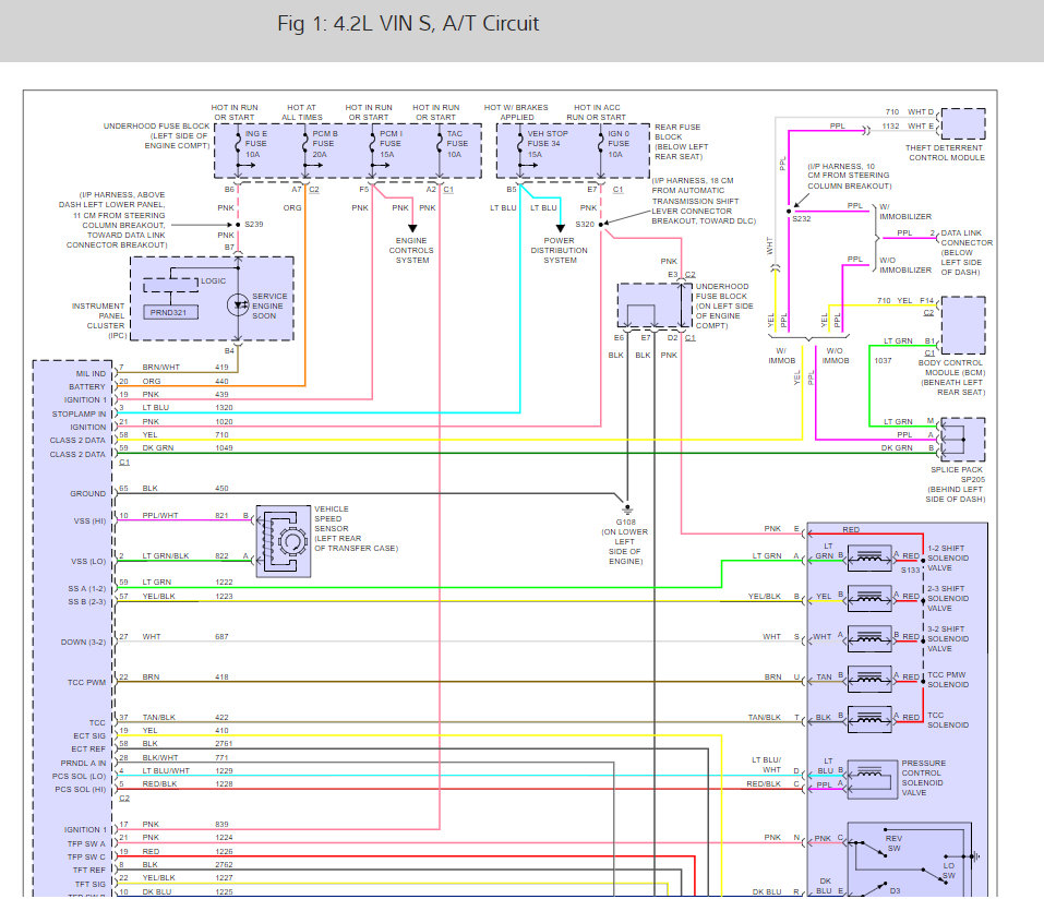

Below are some guides to help you see what the job will be like. Also I have the transmission wiring diagram to help you see which solenoids needs replacement.
Dec 10, 2017 at 8:14 AM
