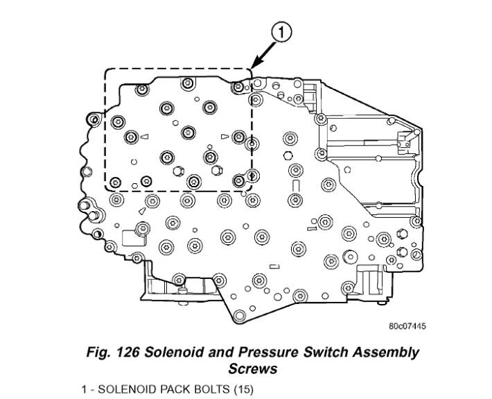

Recently on a trip to PA about halfway there on interstate we heard/felt a clunk and noticed the rpm were higher and it was in third gear. We pulled over immediately to check it out. Upon stopping we noticed it was in third trying to pull out also so I pulled it to first manually but all it will do is second. So we limped it home after stopping by advance for code scan. It has P0700 on dash code and adds P0750 on code scanner. I replaced the shift solenoid pack last night along with fluid filters and gaskets then reset the EC and TCM but it still is in limp mode. The only codes showing are the same ones P0700 and P0750. Anyone have any ideas what else may be the culprit??

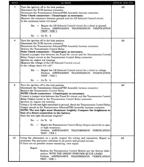

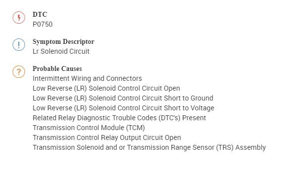

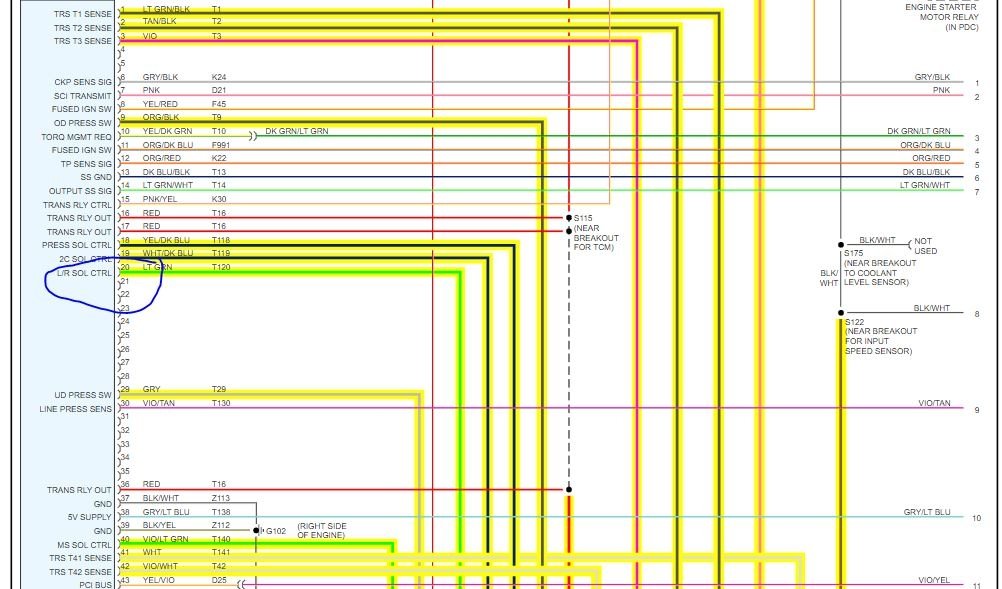

The 750 is for the low/reverse solenoid either being stuck open or closed.

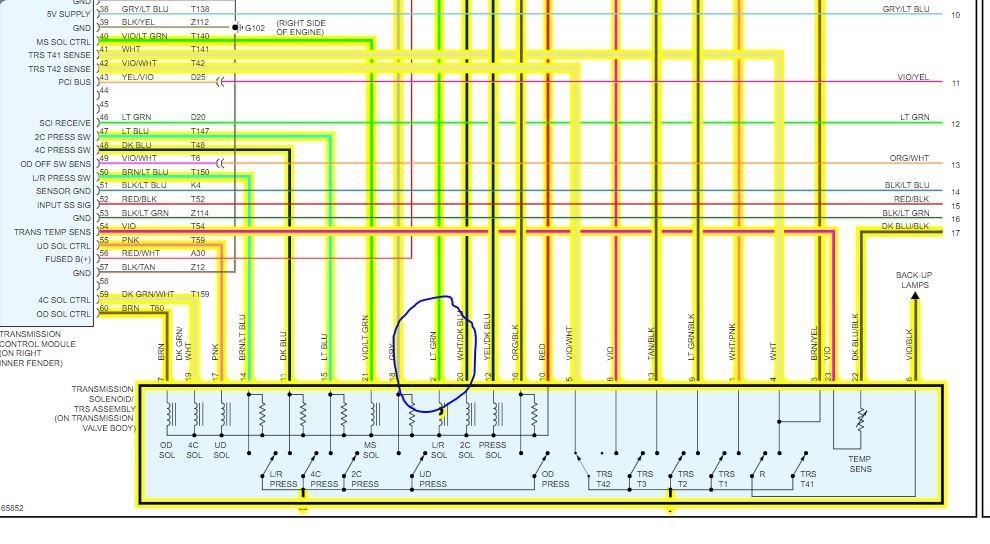

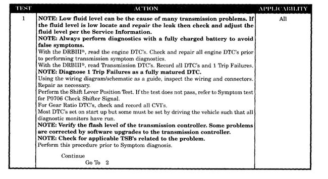

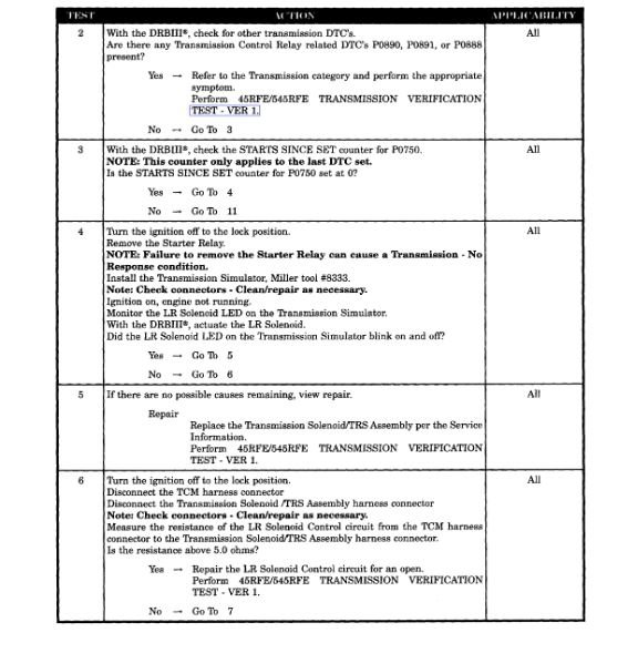

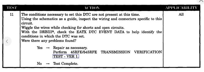

I attached the flow chart for the code below along with the wiring diagram.
It could be valve body related or wiring harness related but needs to be verified.
How was the fluid when you have the pan down?

Okay, did you follow the flow charts I sent you? What were the results?
If you want to find the issue, testing needs to be done instead of guessing.
I would not change the valve body from the other unit. I would swing the entire transmission.
https://www.2carpros.com/articles/transmission-replacement-removal-manual
No to the TCM and no to the relay. You would have codes related to both if they were an issue.

I am going to check the wiring first thing tomorrow morning and check the readings i find and go from there. I had thought of taking the plug back off and inspecting the pins and make sure they haven't pushed out or maybe broken inside as well. I've read so many posts of people with the same codes they replaced solenoid pack and that was all it needed I don't know what the chance of having gotten a bad replacement pack would be it seems unlikely. I also have the 2006 Commander 4.7 I could technically use the pack/valve body from if my wiring checks out okay tomorrow if I need to. I wont have the Overland until Saturday for a donor transmission if all fails. I will ohm the wiring and send results. Thanks for the help.
