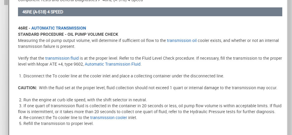

Truck listed above is a 2500 Gas 360ci 5.9 V8.
No 1st gear no overdrive and no passing gear.
I've replaced all sensor and Solenoid in the transmission.
i re-adjusted the front band.
replaced output sensor on the transmission.
reset the TPS.
Mar 20, 2022 at 4:38 AM
This is normally a solenoid so since you have replaced all of them, we need to dig a little further. Normally we would do a pressure test but, on this transmission, they want us to do a flow test.
So, let's start by checking the fluid level and condition to make sure it is at the proper level. Here is a guide that will help with this:
https://www.2carpros.com/articles/how-to-check-and-add-transmission-fluid
Next thing is to check the volume using the info below. Basically, this is going to tell us if we have a pump issue or a possible internal issue.
Please run through this and let us know what you find. Thanks
Mar 21, 2022 at 5:29 AM
RICHARD VEST
Fluid is clean(new) filled to the full level on the dipstick.
Mar 21, 2022 at 5:45 AM
Okay. Great. So that makes me think we have a pump issue or other internal issue that is causing low pressure which will result in these issues.
