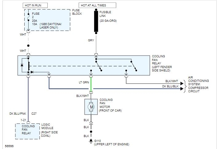

need wiring diagram for radiator cooling fan relay

need to know where each wire on relay goes and what color

I attached the schematic for the 2 door coupe. If it is something different, let me know. Check out the diagrams (Below). Please let us know if you need anything else to get the problem fixed.
