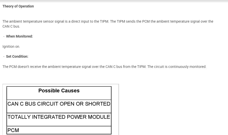

The code I got is U110E.
Feb 14, 2023 at 6:40 AM
  • 110,244 POSTS

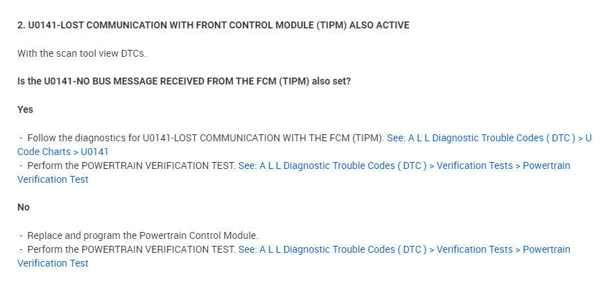

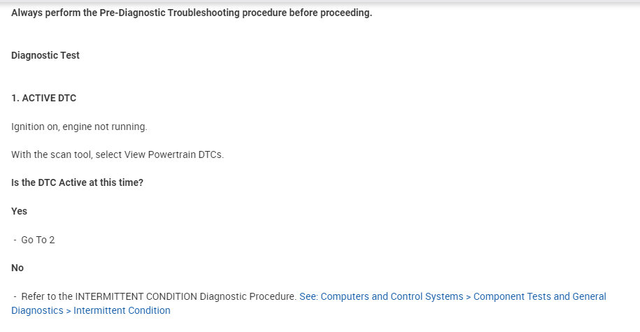

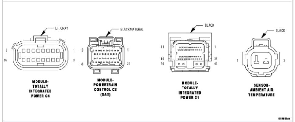

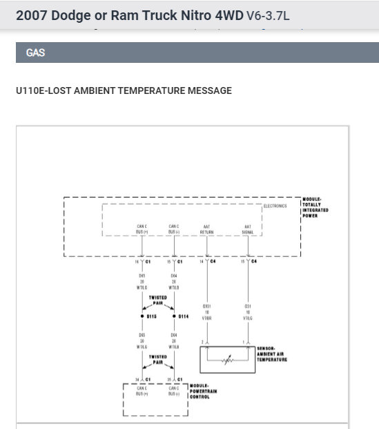

Based on the code, I suspect we lost power from the TIPM (totally integrated power module). The code is specific to the loss of ambient temperature communication.
Do me a favor. Take a look at the diagnostics below and let me know if you are comfortable performing them. This is what I get to help determine or identify the cause.
