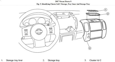

how do i remove the stereo from the dash ?
Nov 18, 2009 at 12:45 PM
KHLOW2008
  • 41,814 POSTS
Hi shreefer71, Thank you for the donation. Here are the procedures. CLUSTER LID C Removal CAUTION:Before servicing, turn the ignition switch off, disconnect both battery cables and wait at least 3 minutes. 1. Disconnect battery negative terminal. 2. Disconnect battery positive terminal. 3. Pull cluster lid C rearward to release clips. 4. Disconnect electrical connectors and remove cluster lid C.

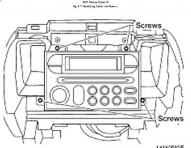

Installation Installation is in the reverse order of removal. AUDIO UNIT 1. Remove the audio unit screws. 2. Pull out audio unit, then disconnect connectors.
https://images.2carpros.com/forum/automotive_pictures/192750_Radio07XterraFig47_1.jpg
