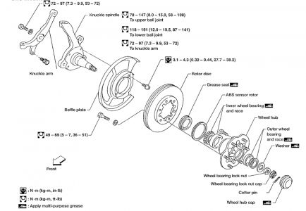

How do you go about removing the front brake rotors on this vehicle?
