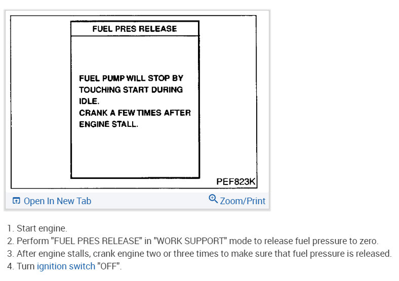

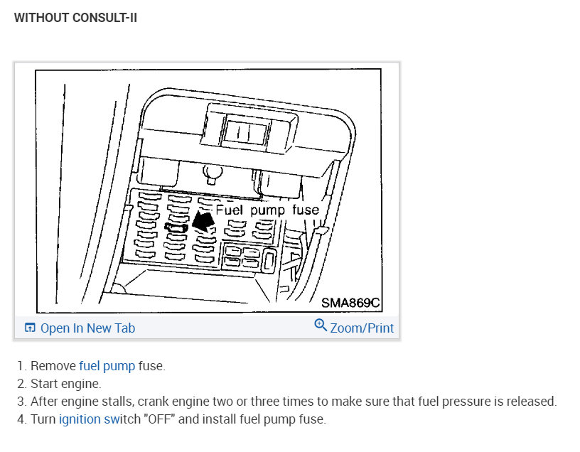

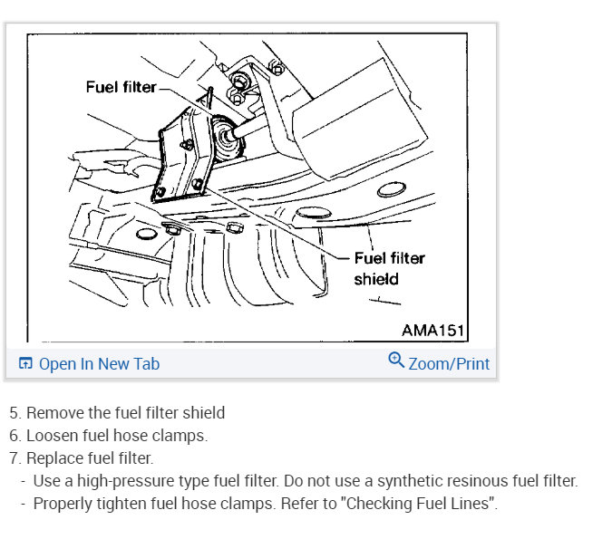

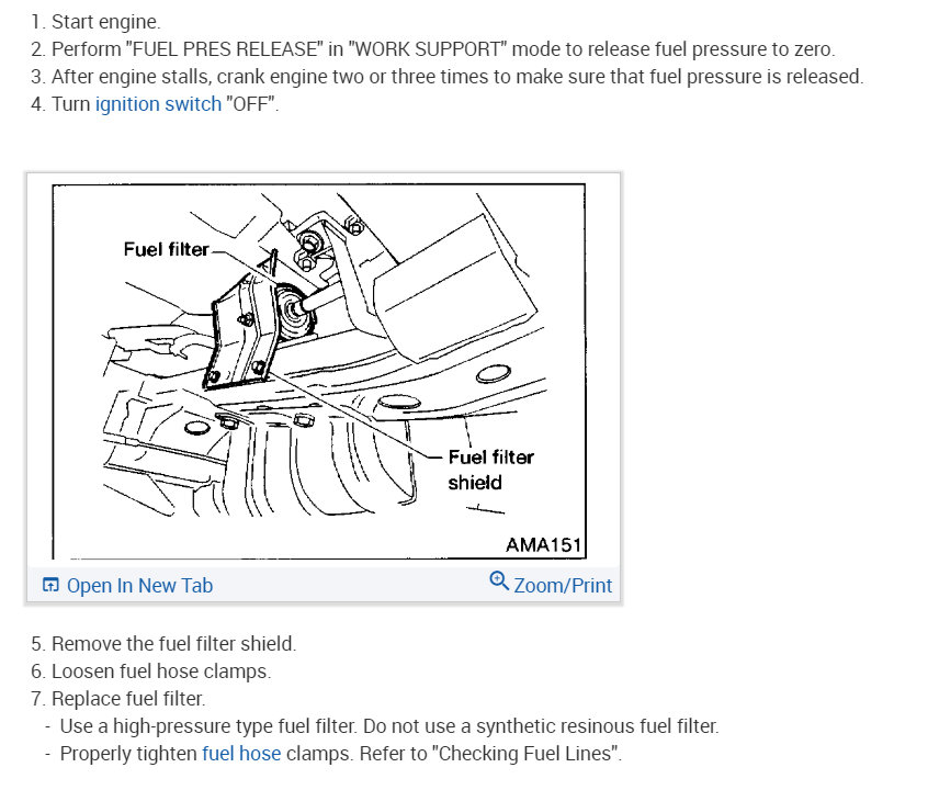

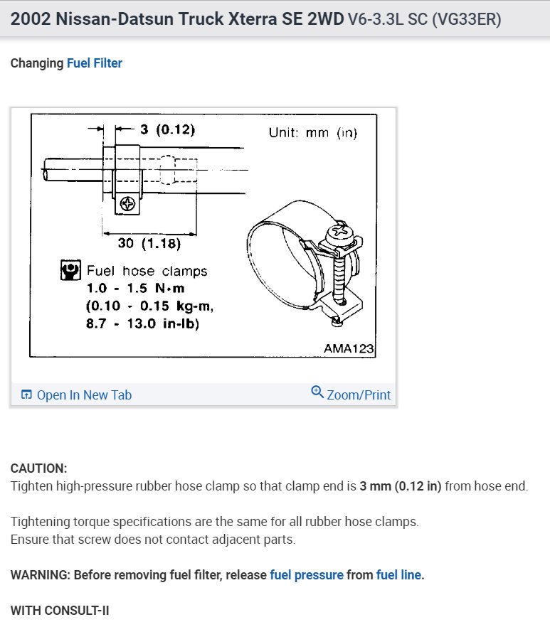

Where is located fuel filter for my truck?
Thursday, December 27th, 2007 AT 5:26 PM
MERLIN2021
MECHANIC
17,250 POSTS
The fuel filter is on the frame rail by the gas tank. Here is a guid to help walk you through the repair and diagrams and instruction below to help you on your truck.
