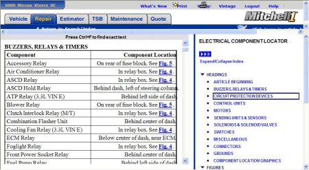

The blinkers are not working. I have changed the fuse #2 of 7.5A but I cannot located the electronic flasher: it is not among the fuses in the fuse box underneath the hood and so far I cannot located below the dash, driver side, ever as indicated somewhere on the web.

The combination flasher -Try checking behind the center of dash
https://images.2carpros.com/forum/automotive_pictures/12900_flasher_26.jpg
