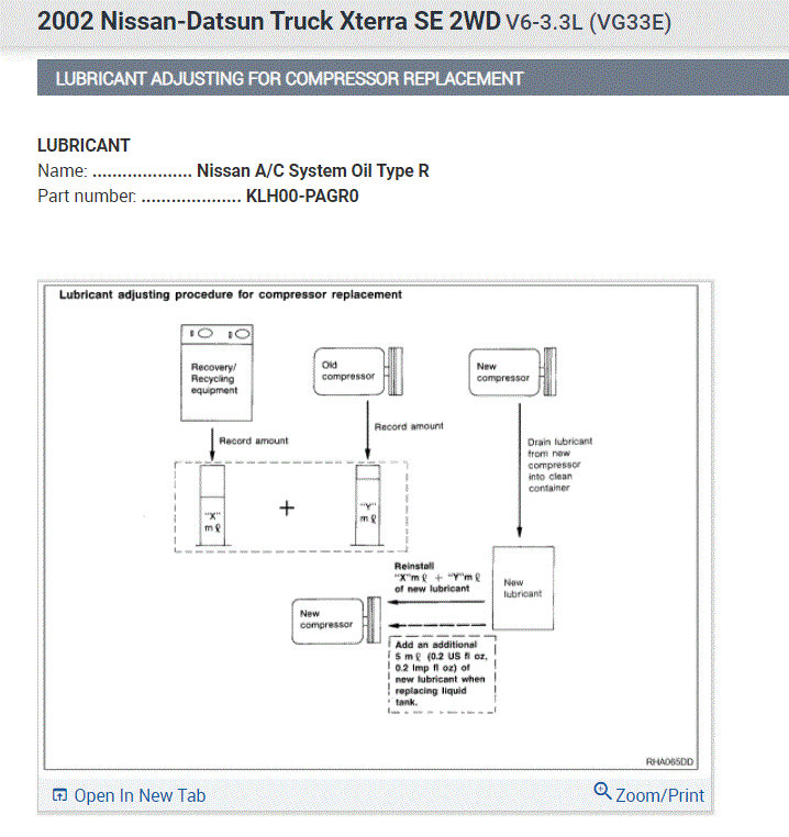

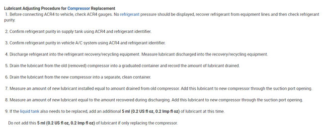

What I suggest is to start from the beginning. Evacuate (vacuum) and recharge the system using A/C manifold gauges. Here is a link you may find helpful. It explains the procedure. Note, make sure not to add too much oil.

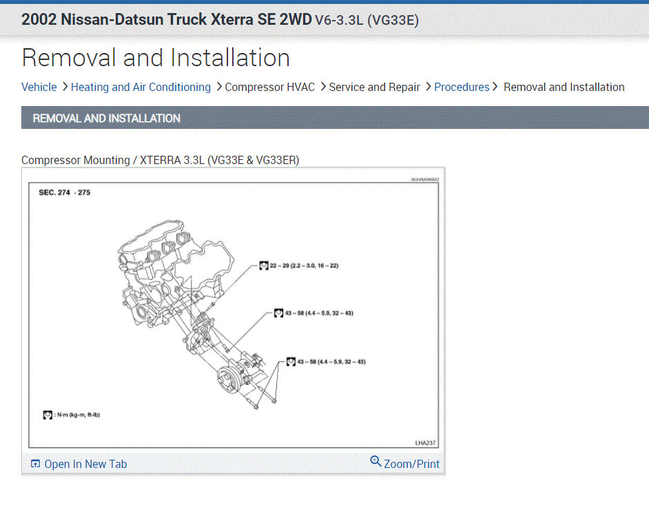

If you look at the attachments below, they provide the directions specific to your vehicle for compressor replacement and adjusting lubricant for compressor replacement.
